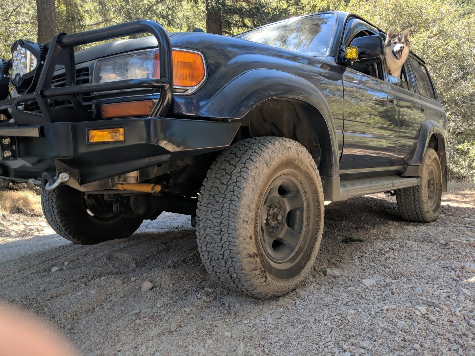

hi all, new to the LC and i have a 95fzj80 ome 3.5 front 2.5 heavy kit w/ slee sway bar drop kit, castor correction plates, sitting on kumho road venture at51 size 305/70/16, slee center diff lock installed (no 7pin mod yet) (no front and rear lockers) front bumper with 12k winch also the majority of mechanical maintenance items addressed. i also have a compressor and i usually drop psi down to 17-20lbs on the trails for a softer ride and traction of course.
growing up i rode dirt bikes, quads and driven sand rails in the dunes. familiar with approach and departure as well as with steering clear from craters.
as i have driven dirt trails and dry sand washes in my 80 it has performed really well. i have had this vehicle for approx 6 months.
wondering if you guys have any tips e.g. (2nd start) (t-case in L or H) (Tranny in D or L) we would also spray the vehicles with wd-40 to prevent rust. is this a good idea underside of the 80 as well? As noted above i will be airing down.. im not sure what the 80 is capable of, if i should stay close to the beach or if its safe to venture out into the dunes. BTW im going put to Pismo.
thanks in advance!

Your all terrain tires are better suited for sand than someone’s mudders, so thats a plus. I always start out slow as to not dig, bring a shovel and some 2x6’s or tracks if you have em. Park facing downhill always, air down as much as you can safely.
