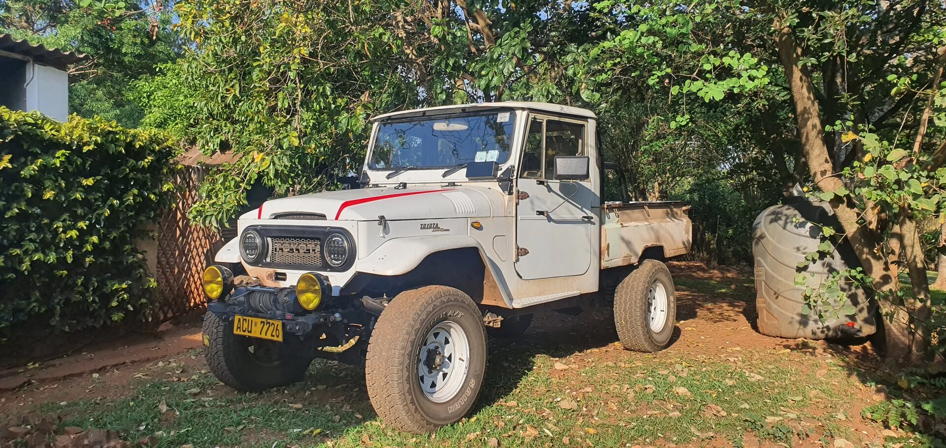

Couldn't figure out why my windscreen wouldn't fold flat. Some measurements, pics and the 40/45 forum helped figure out I have the wrong hinges on this thing
Tracked down some new ones. Had to do some panel beating on them to make them straight but got that done.

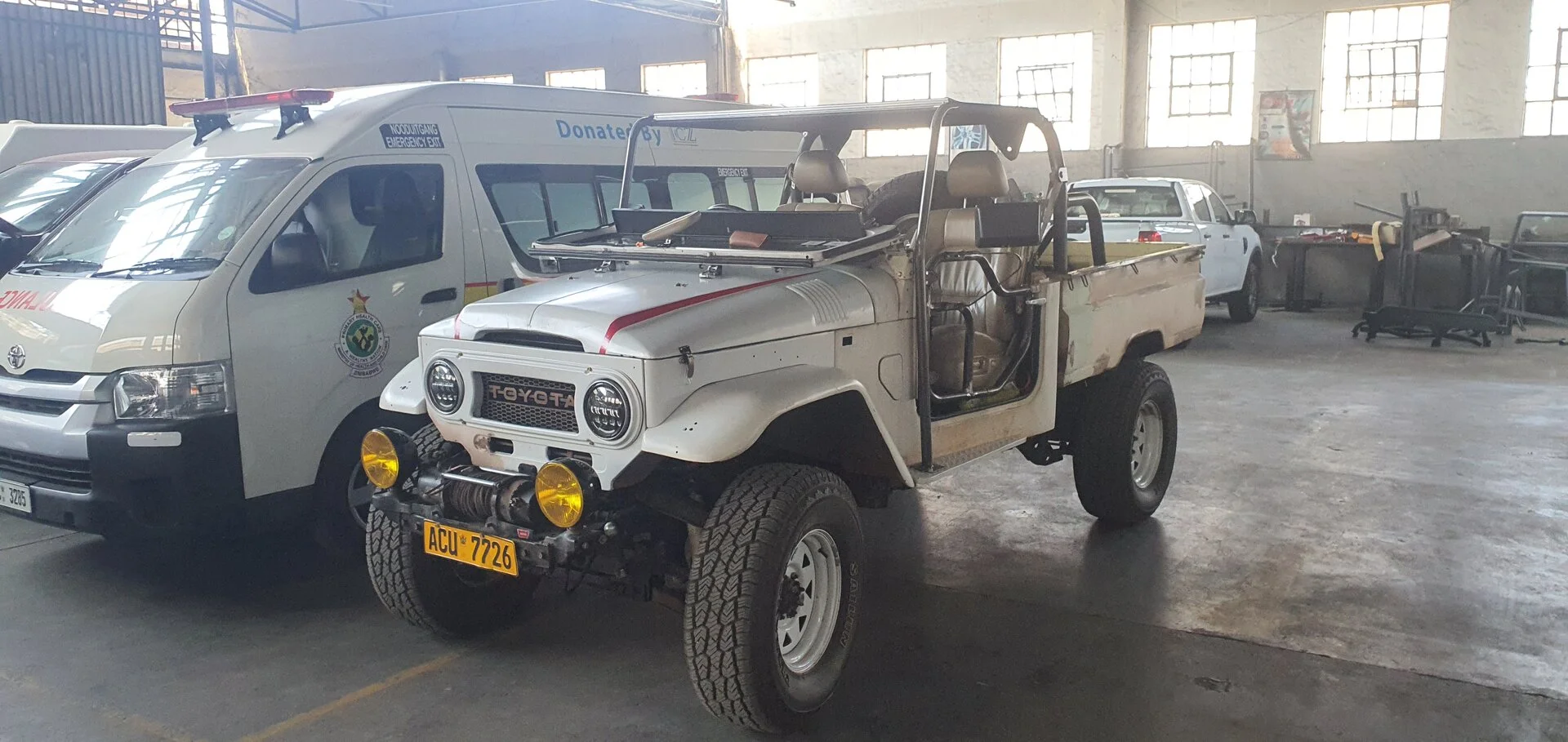

At the same time I made up my tube doors and roll bar.
And finished up the awning

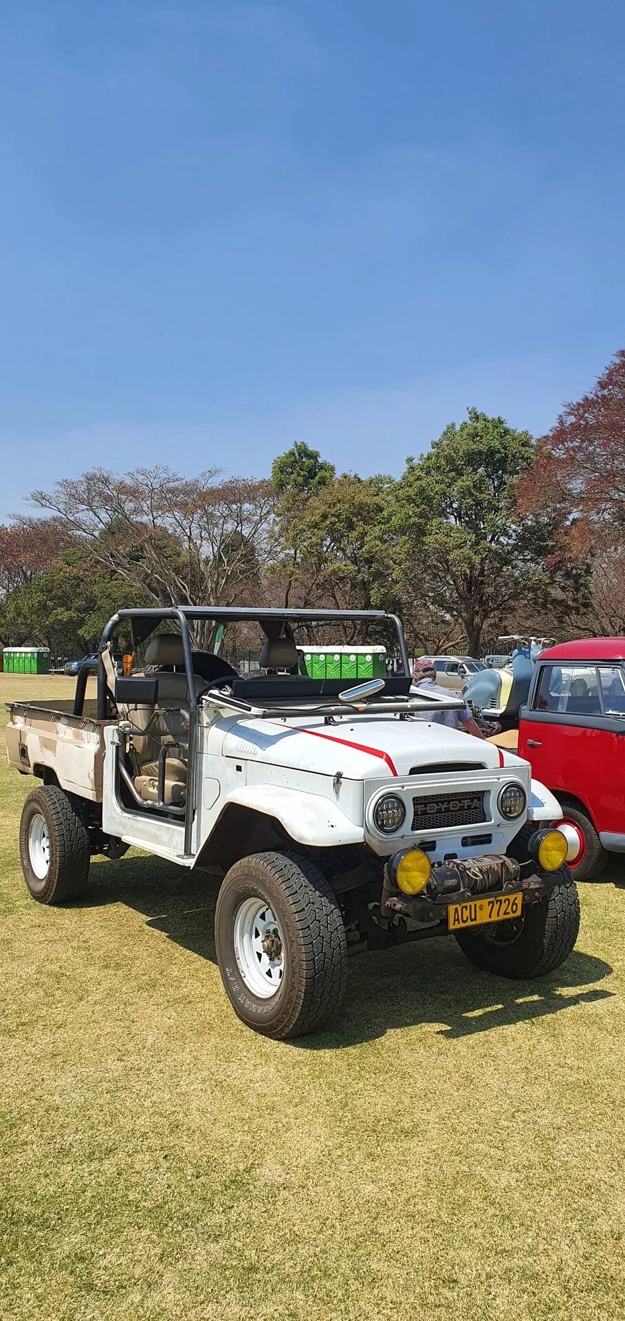

Then took it to the classic and vintage car show here in Harare. Got some awesome feedback, had a blast and everyone loved the rig.

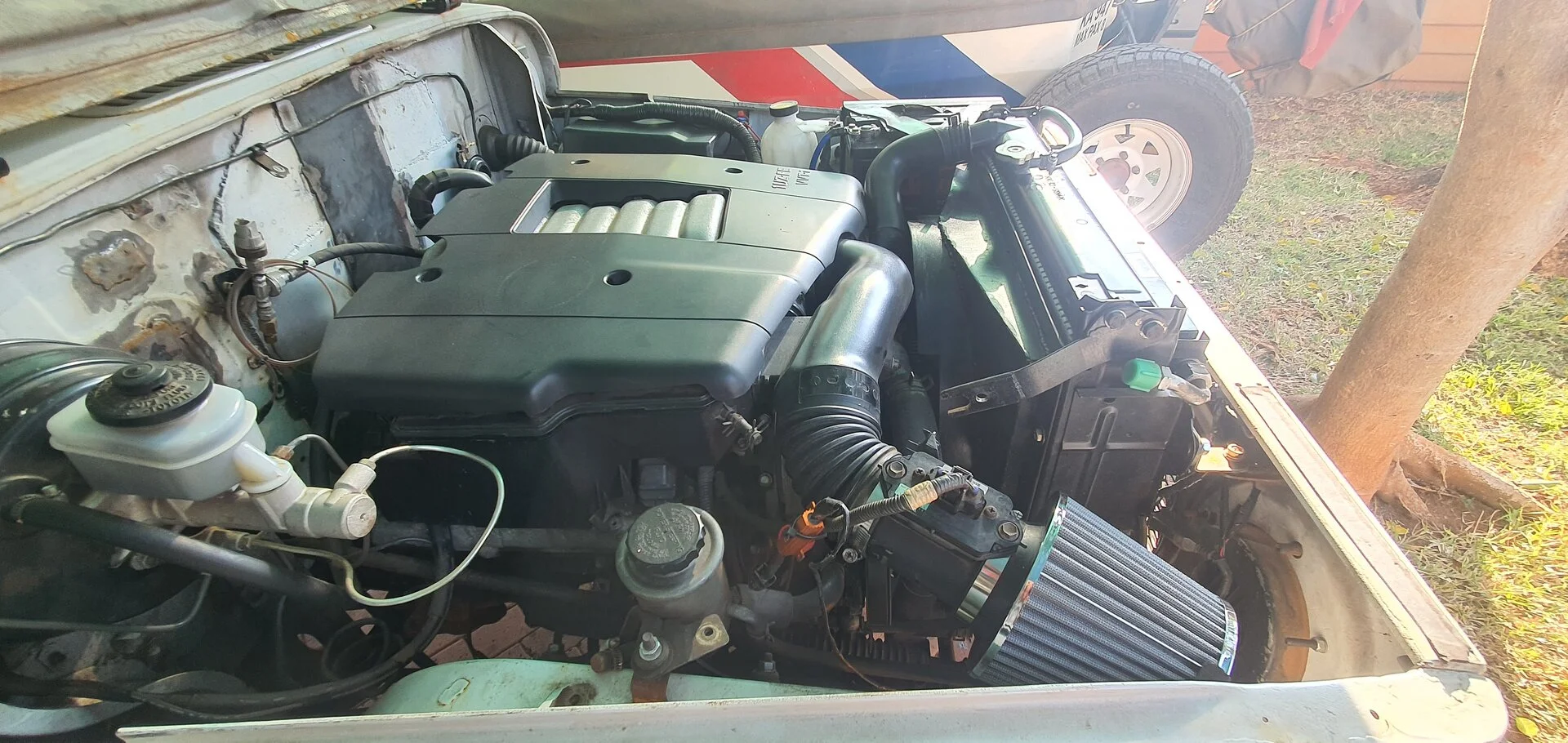

Most recent work had me replacing the long run intake for a short run with cone filter. Less restricted, more induction noise and definitely more power.
Took my previous 0-100kph time from 9.8sec to 8.3sec.

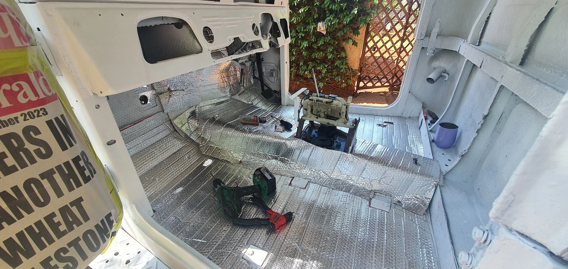

Seam sealed and insulation laid down. 2 layers directly on the firewall and right up to the top.
Then another 2 layers each on drivers side, passenger side and over the transmission hump.
Then put in the sound deadening and carpets as well as the AC unit.

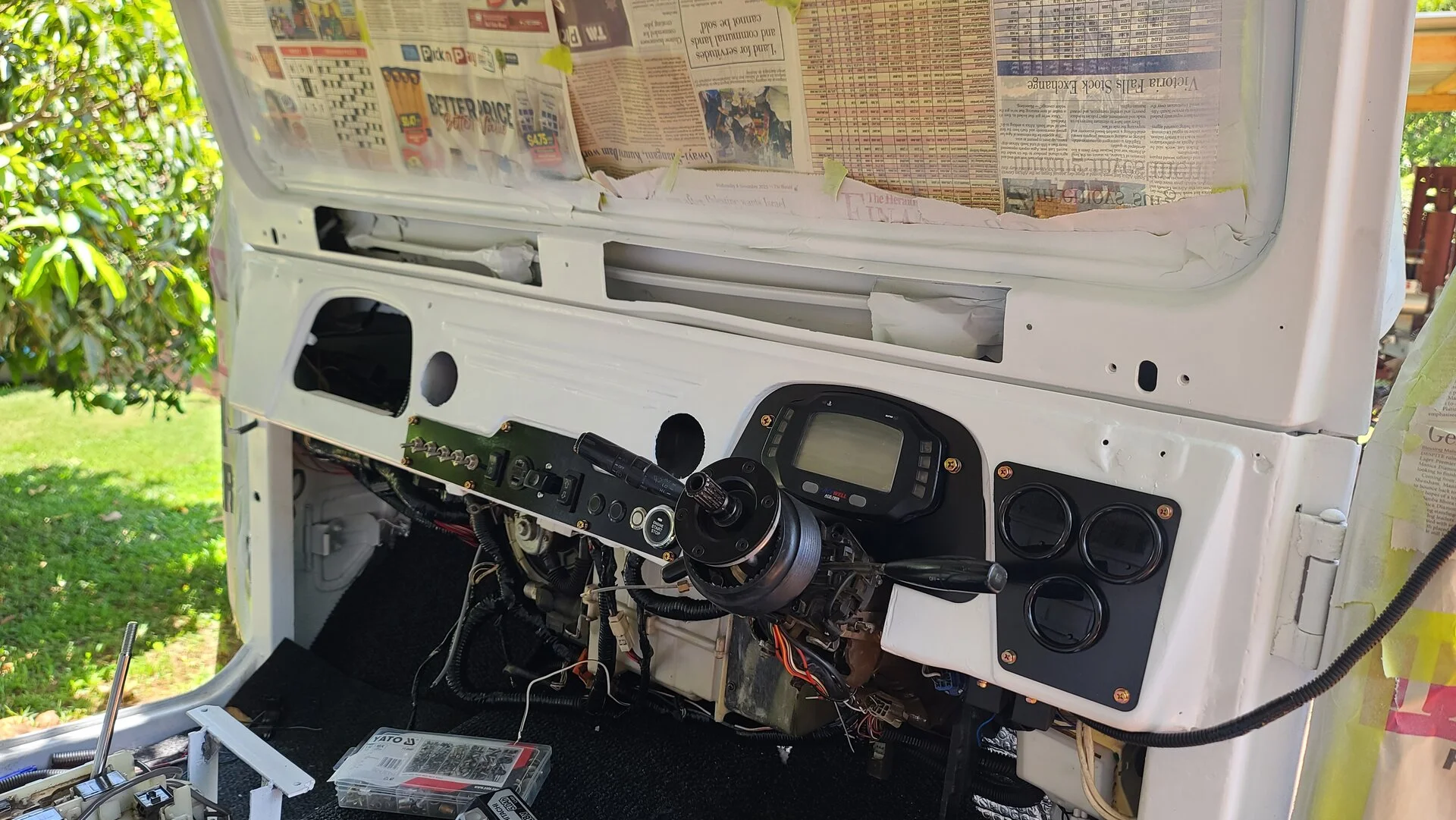

And then finally started pre wiring and putting together the new panels. This is the new lower dash panel. It contains basically all of my auxiliary electrical switching as well as the ignition and starting switches.
Now I'm ready to start wiring, taking out what's not needed, tieing in the new ECU and just general cleanup of my loom.

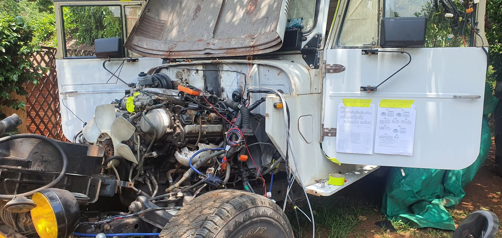

Started the rewire job. Decided to pull off the fenders and the bib for easier access to the engine and some of the sensors.
Then started tracing wires in the existing loom that I will be using, others that will need to come out and others that can be repurposed. Handy to have drawings and pin outs, buy always best to confirm physically. My drawings were all accurate on the pin outs but a lot of the cable colours were off.
Once I knew where everything was and what rhe plan was, it was time to start splicing in the new ECU.
It amazes me how fewer wires a new modern ECU needs.
Still got a few more things to wire in, mainly the sensors, but most of the heavy lifting is already done.

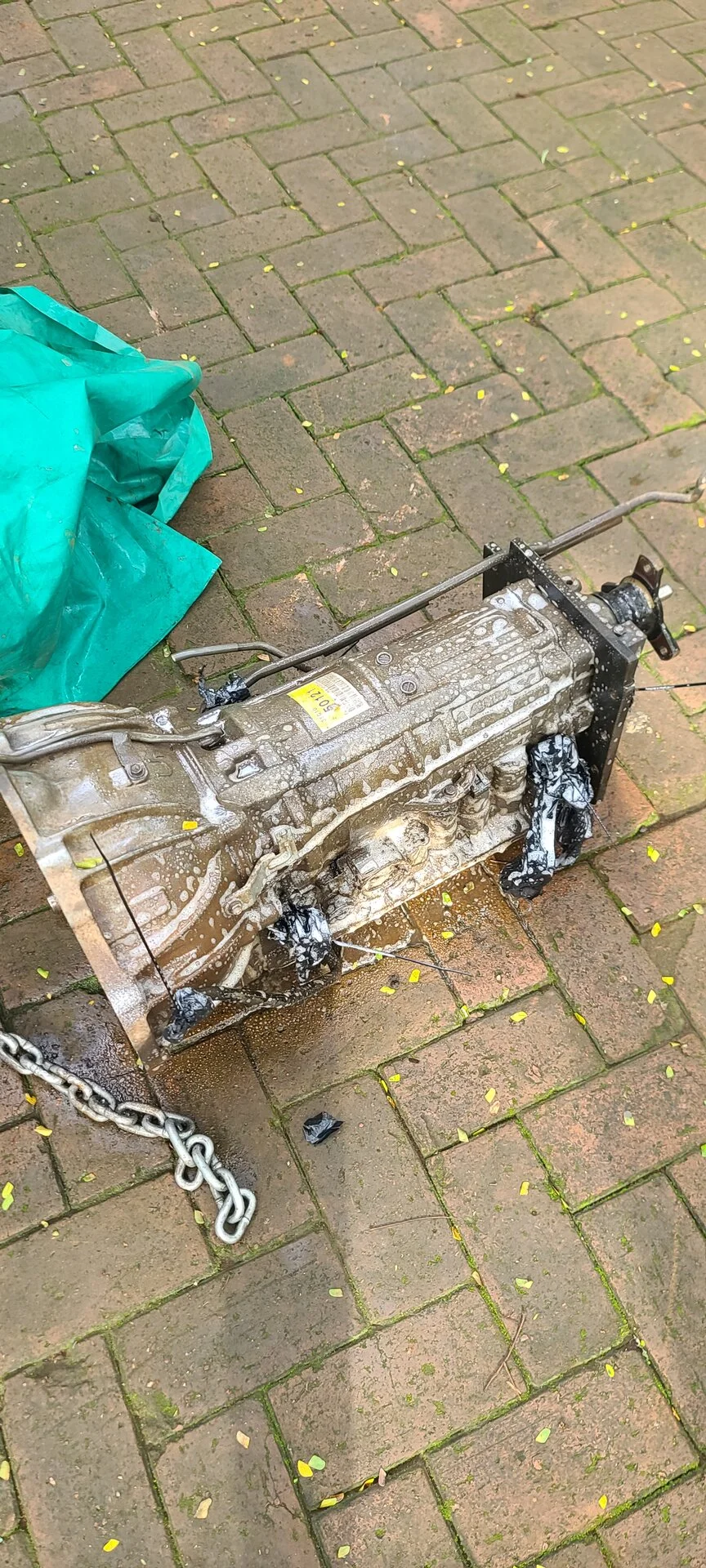

Ever since the new ECU and TCU, I've been struggling to get the gearbox to behave as it should. I'm using the 5 speed A650 which is known in the tuning community as a problem child.
To help make sure I'm just battling the tune and nothing else, I pulled the box and cleaned the pickup filter and any gunk out of it.
Box was actually pretty clean. Have some in depth tech posts planned for the tuning side.
