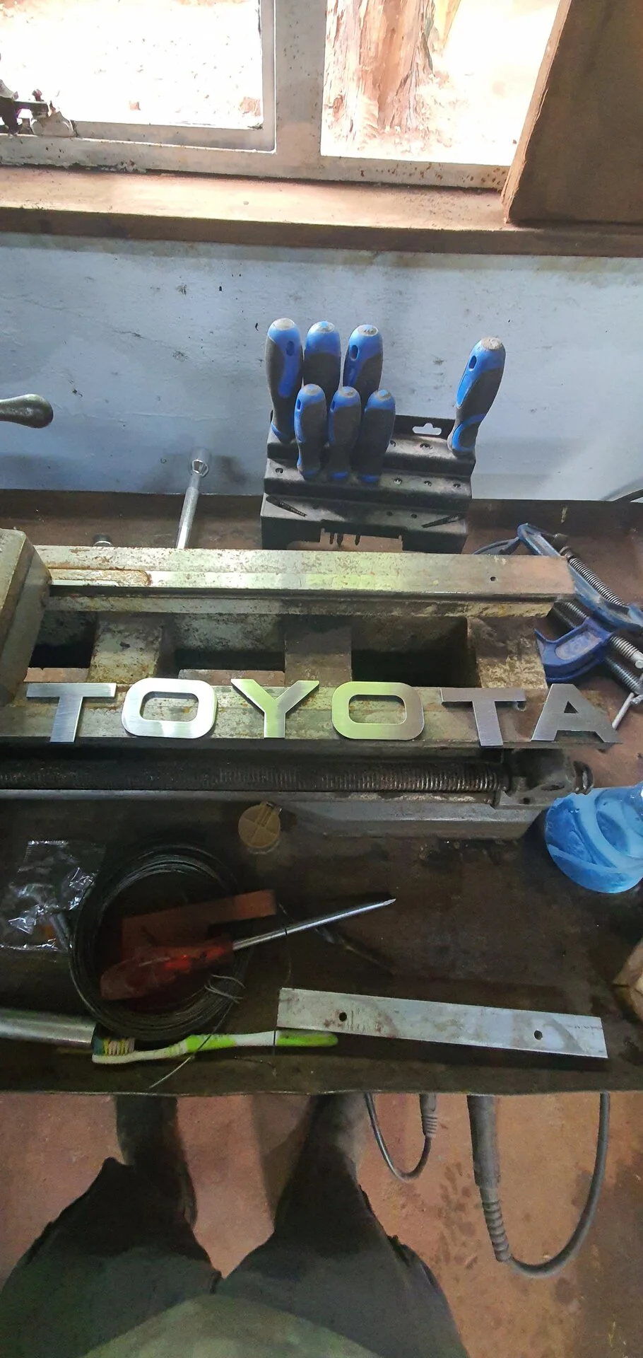

Got my grille cut out. Cleaned up and then hand sanded the letters, welded them on and got it on the cruiser.

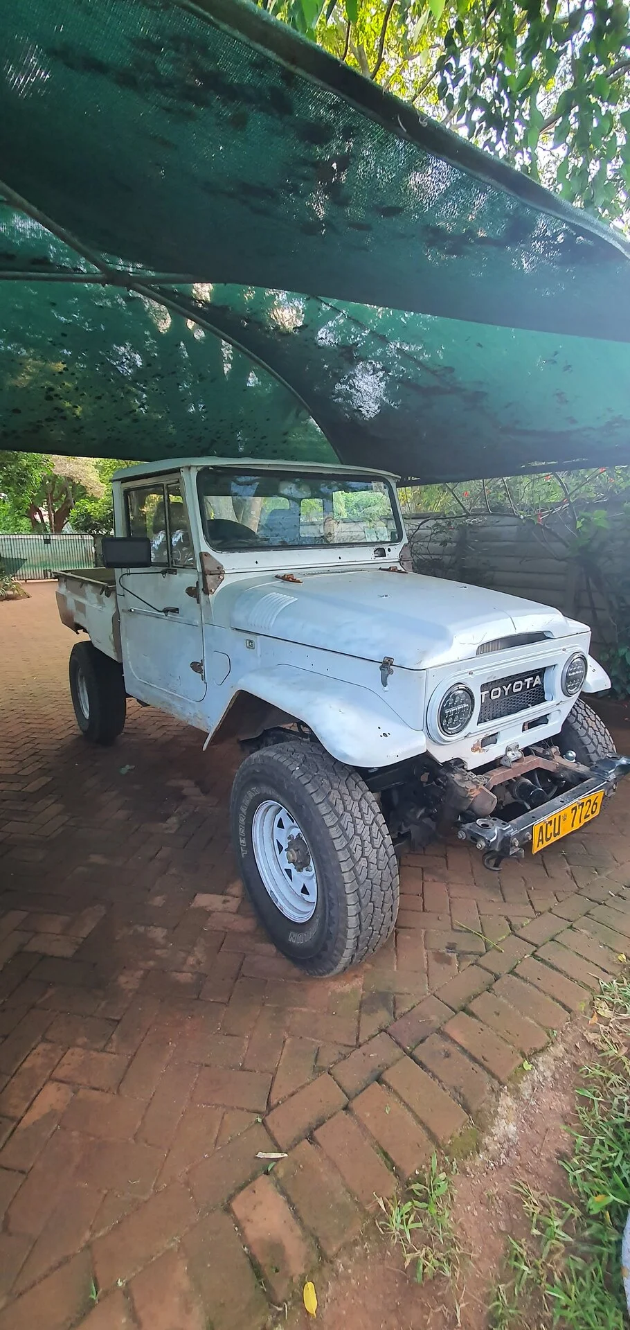

First meaningful drive, about 20kms. There are lots of rattles to chase, and most of the suspension, ie, shocks, bushes, links, needs to be done, but I'm amazed how comfortably she rides!
The engine and trans went awesome. Got to 87°C and stayed there. She idled along at 70kph and had an awesome amount of power on the kick down.
Couldn't be happier! And now I get to work on all the small things here at home too!
BUT...... I lost one of the 'o's from my front grille on the way home :bang:

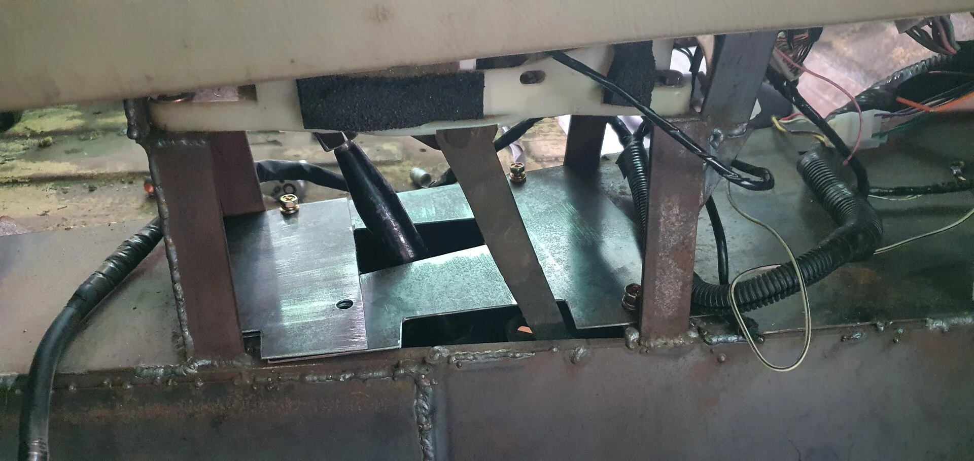

Another thing to chase is heat ingress. Needed to make a top plate for my gearbox tunnel and some boots for it.

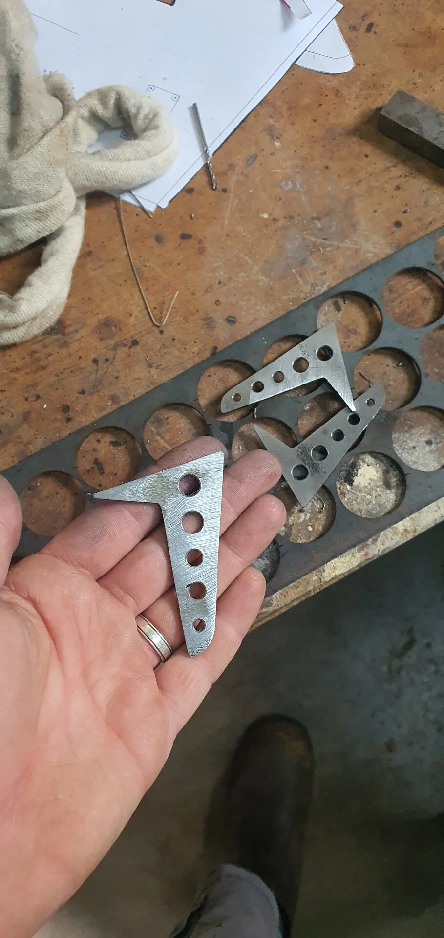

Has to be a 2 peice system to go around both shifters.
Then some brackets to hold the boots in place.
And then the boots. Will see how these do. If the plan is a success, will upgrade to rubber boots at some time in the future.

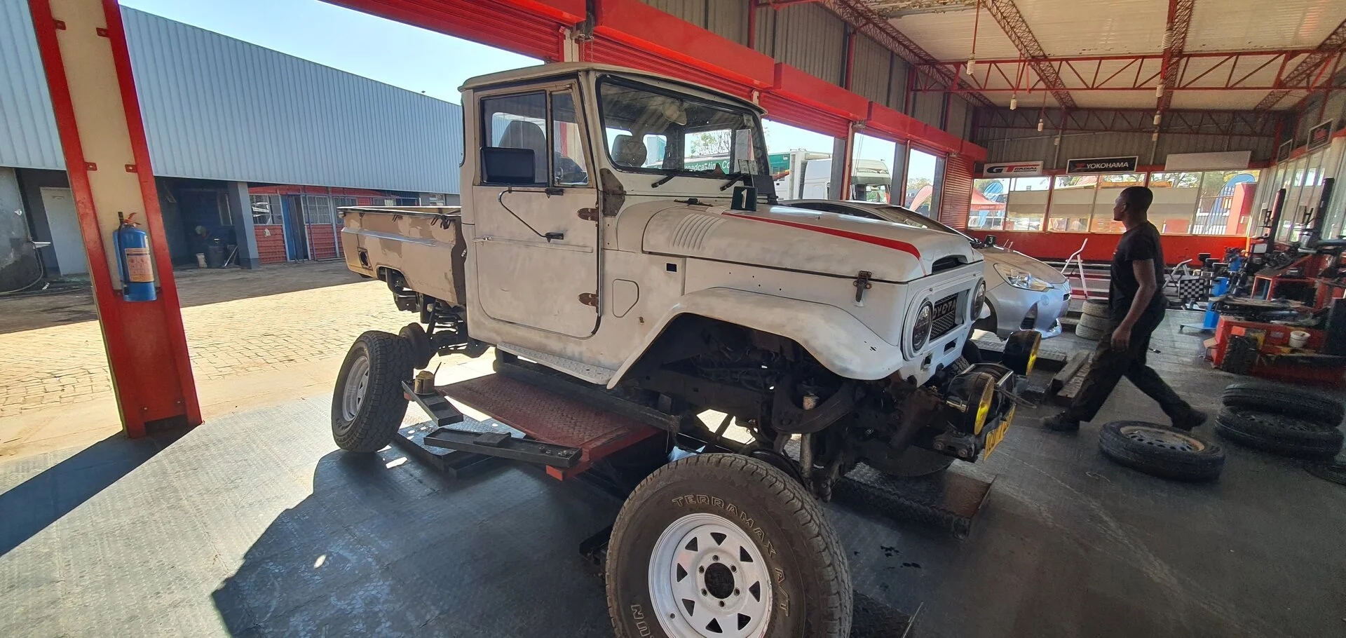

Took it on a around 50km round trip. Had to take a fly press to a friend, the same one who will be servicing my front diff. So dropped both the press and the diff.
In the future, air bags are going to be required to load the old girl. But boy oh boy is she comfortable when loaded!
Then went from their to another mechanic friend of mine to show off a bit :grinpimp:
He was suitably impressed, and he's a tough cookie to crack! He's also got a ton of experience with the 1uz. Put one in an 80, and about to put one in a boat.

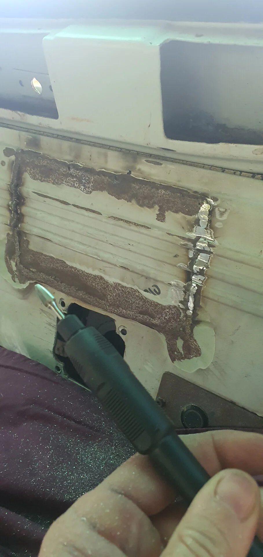

First up, need to fix this....
Dremel with a carbide burr did the trick. Got covered in steel splinters which was not pleasant.
Then a light skim with filler and then we will hit it with high build primer and sand back when we go to paint.

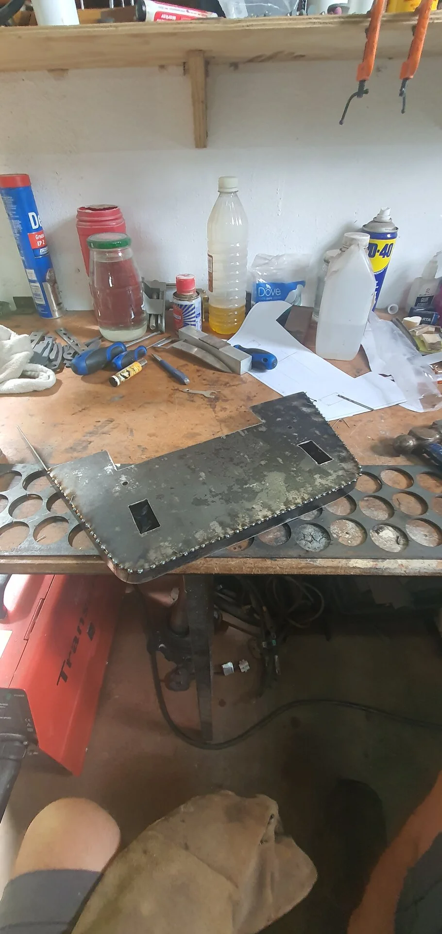

Needed to make a top cover for the center console too.
I've made lots of brackets, mounts, small parts and such for my cruiser build so far, but never anything that I would consider true panel beating. So here's my first try at it. Not perfect, but so much better than I was hoping/shooting for and has given me confidence to do more of this if I need too. It Also houses the switches for the power windows. More on those later...

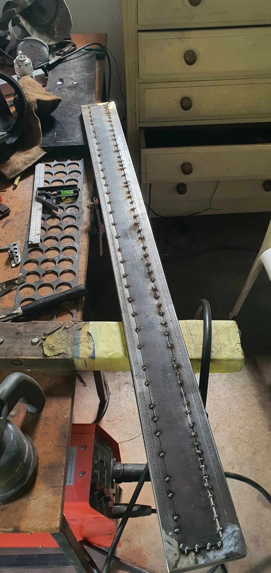

Something on my wishlist as I've been driving around is somewhere to put my phone where its close to hand. Also some where to put keys and other junk that isnt the cubby or the center console box. Saw something similar to this a while back and liked the idea, so here is my version.
Basically just a tray that will sit on the bottom of the windshield frame. Made some nice little brackets to support the frame itself. Welded in some sheet steel to the bottom and will add some insertion rubber over that when I can. I hit it with primer so it's still drying over night, will get it in the cruiser tomorrow.

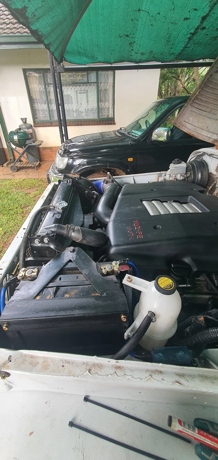

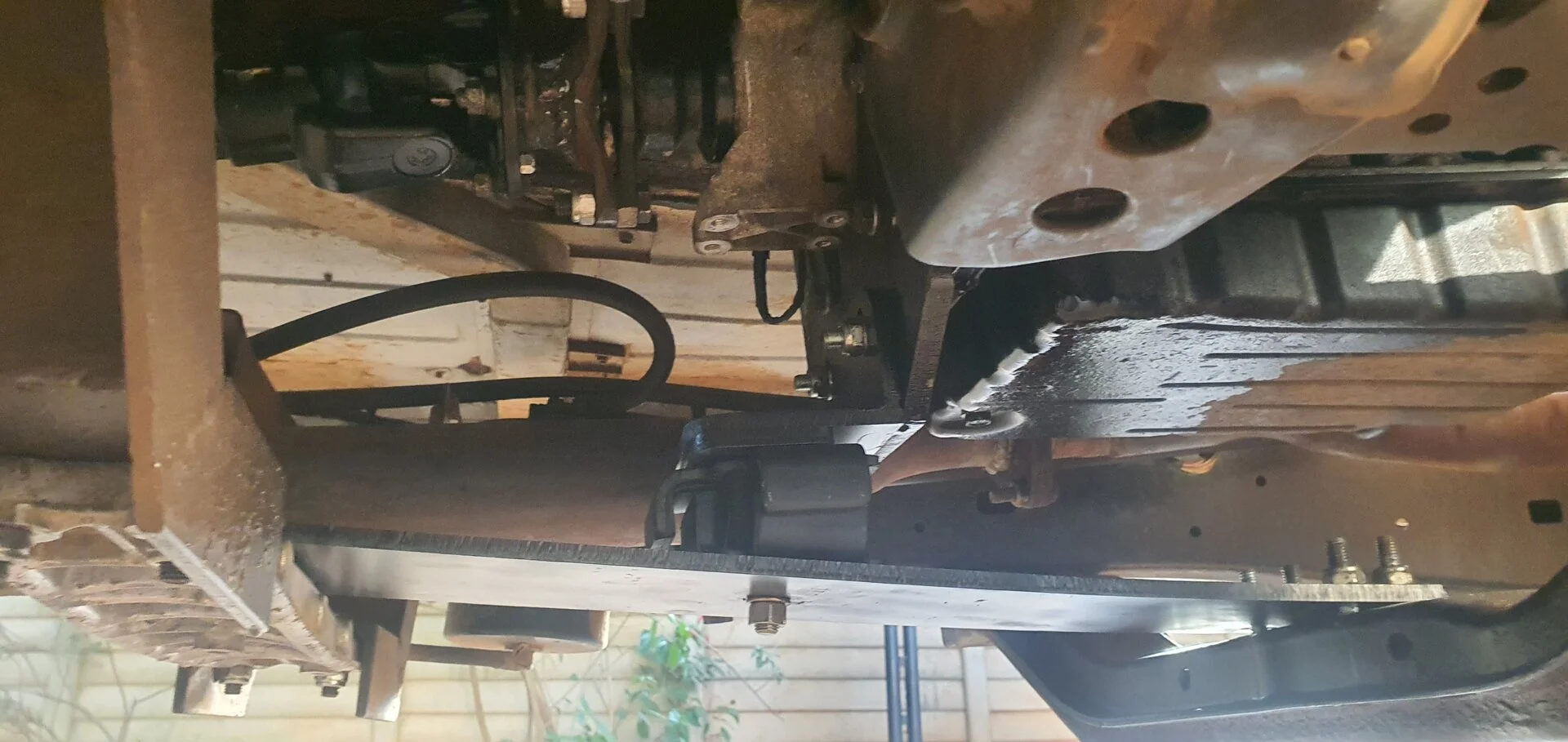

Starter motor was starting to die and I don't want to be stranded high and dry when does eventually go.
Anyone who has ever had to get at the starter on a 1 or 2uz knows what this entailed....

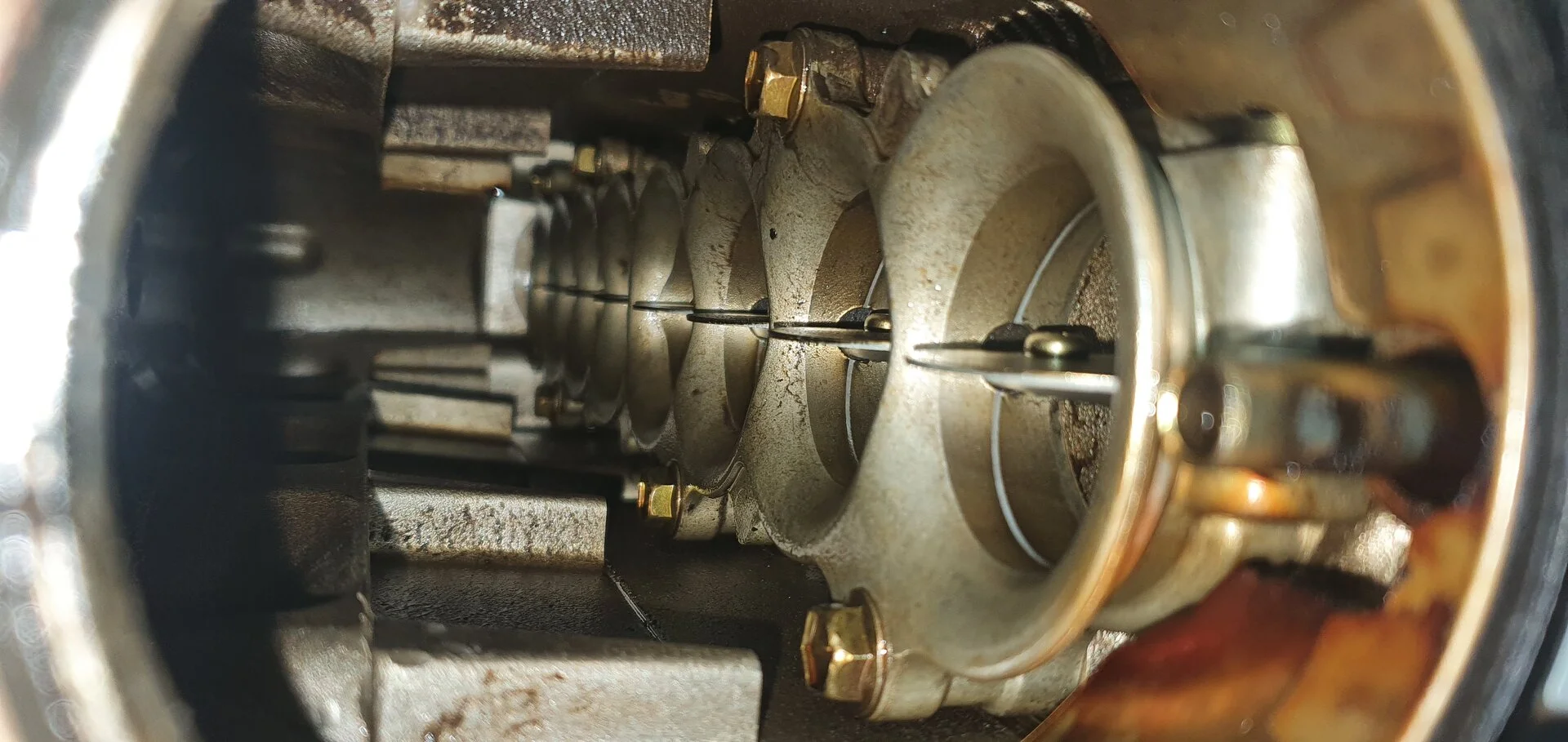

Intake manifold off
At least a good chance to clean up the motor.
and inspect the intake manifold itself. Looks nice and golden
Put new contacts in the starter and put it all back together.
Now she starts on the first touch of the button

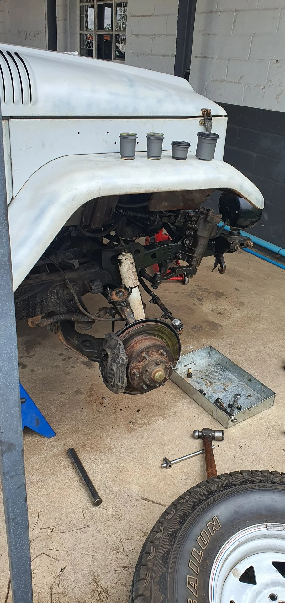

More suspension work. This time both upper and lower control arm bushes. One of those jobs that sucks but it will all be worth it.
Well, finally done with the control arm bushes. What should have been a half day job turned into 2 days of hell, but got it done.

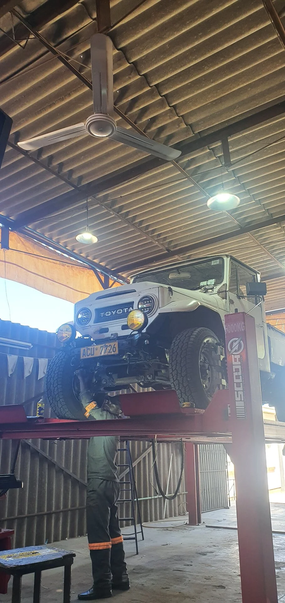

Now we can FINALLY do alignment

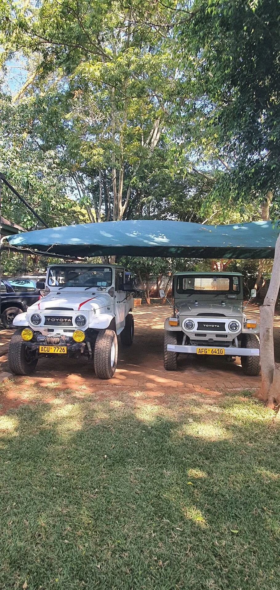

First foray out of town. 40kms out to my dad's farm to see the combine working.

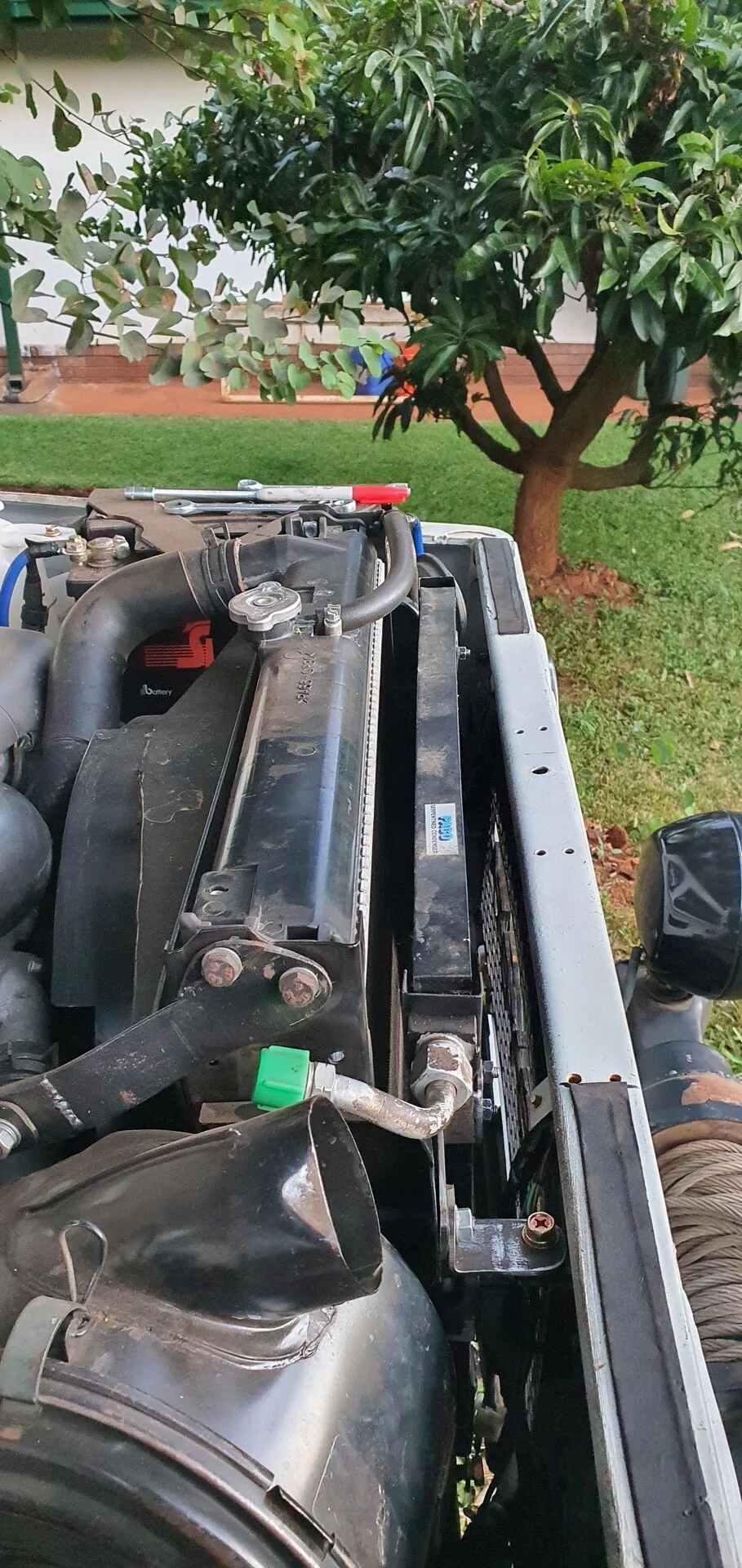

Got given a free AC condenser by work. Made some mounting brackets and got it in. Will do the lines and the rest of the AC system later on, just wanted to make sure the condenser in this position wouldn't affect engine temps, and it doesn't.

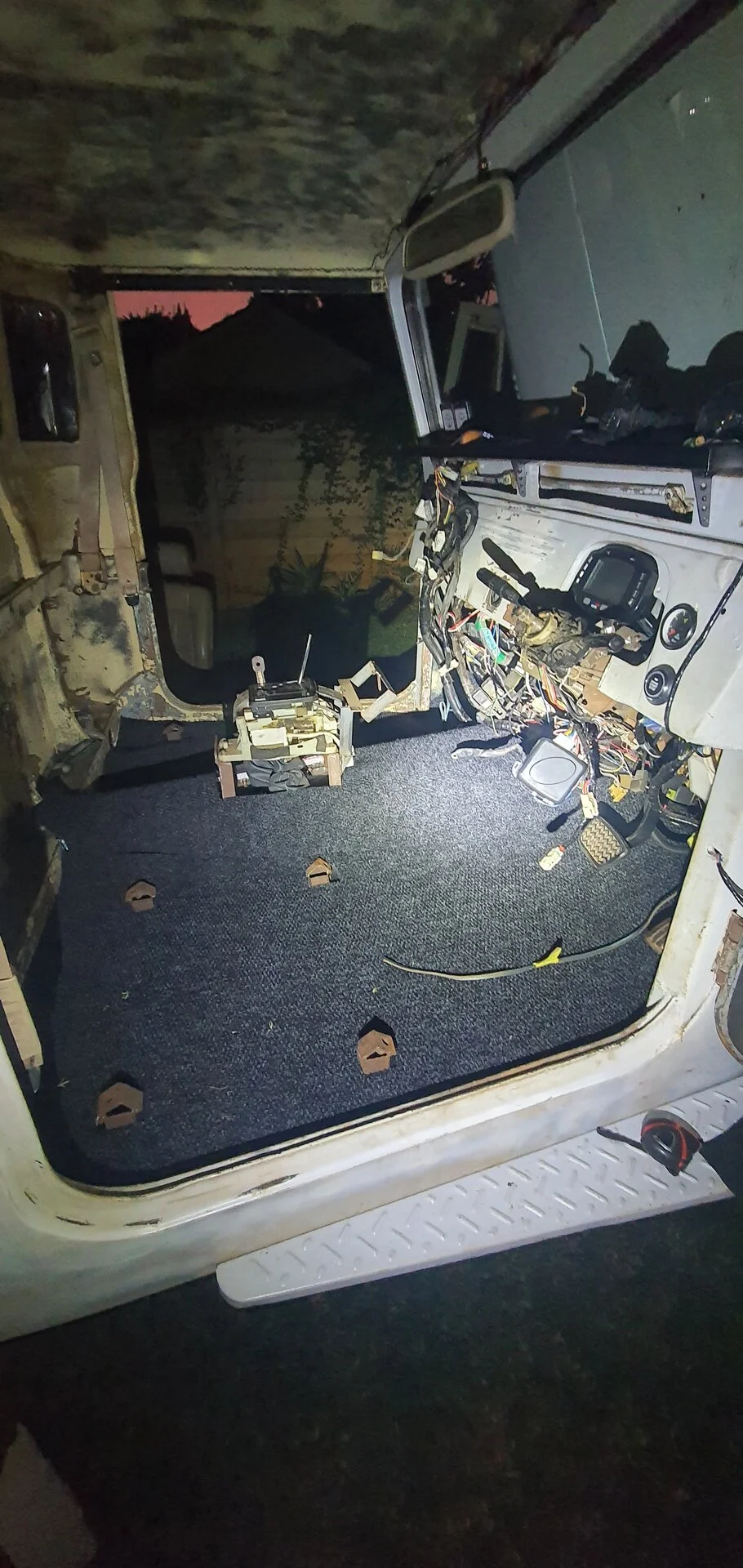

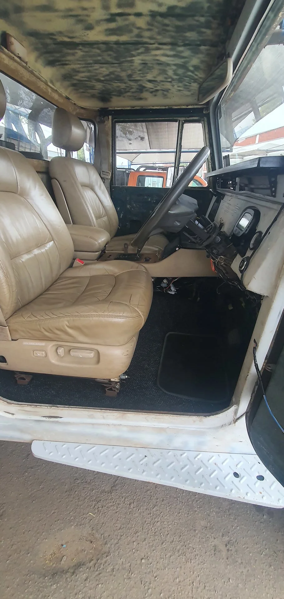

Then finally time to do something about all the heat coming into the cab.
2 layers of alububble insulation, heavy rubber underfelt and then a heavy industrial carpet.
Really happy with the results. Big difference to heat and sound ingress.
My cousin has just finished a mild refresh on his 45, mainly a new paint job. He's kept his pretty much stock.
It's amazing how unstock mine is at this point!

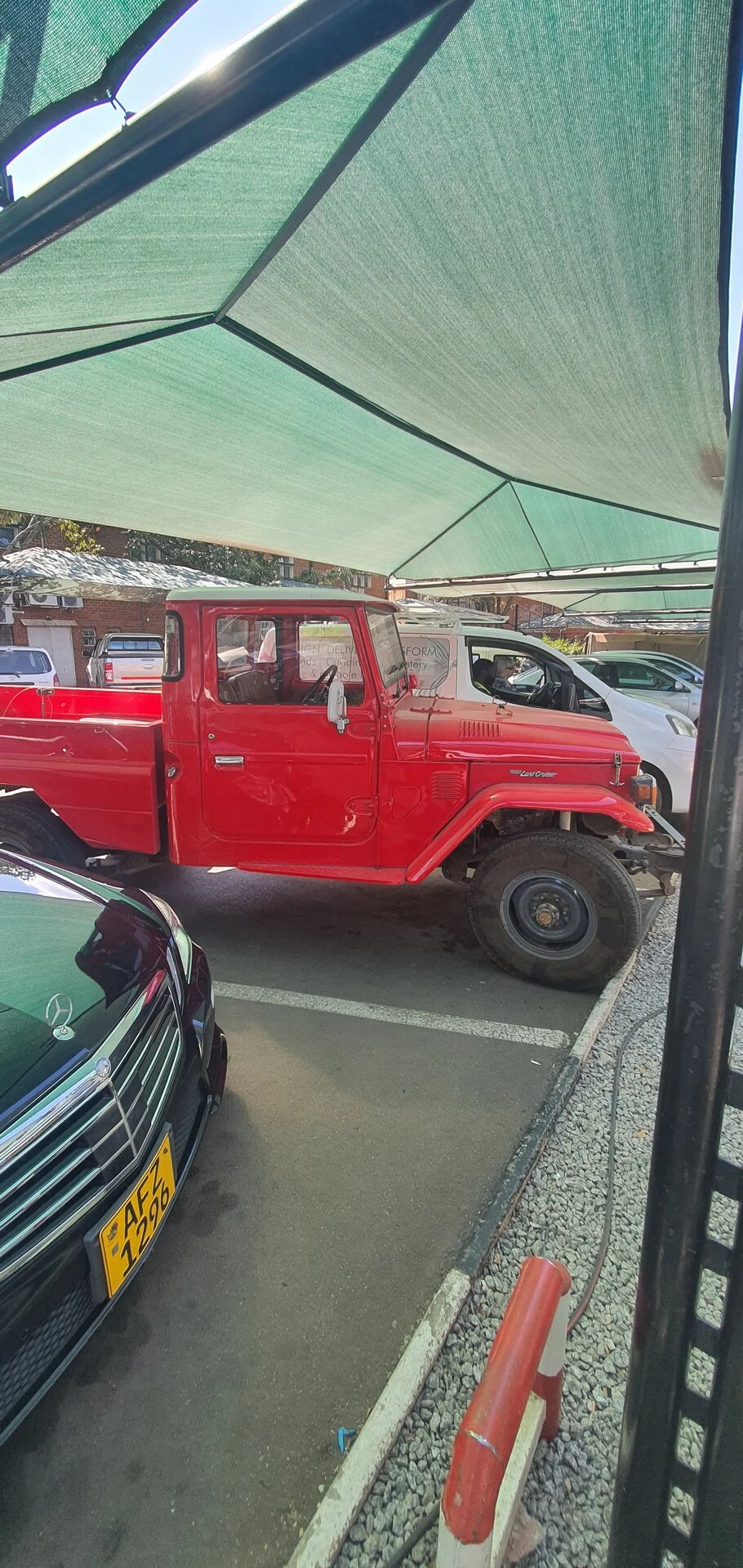

Finally have seen a 45 in freeborn red in the flesh. And that ends my desire for freeborn red. Its nice, but its not me. White it is!

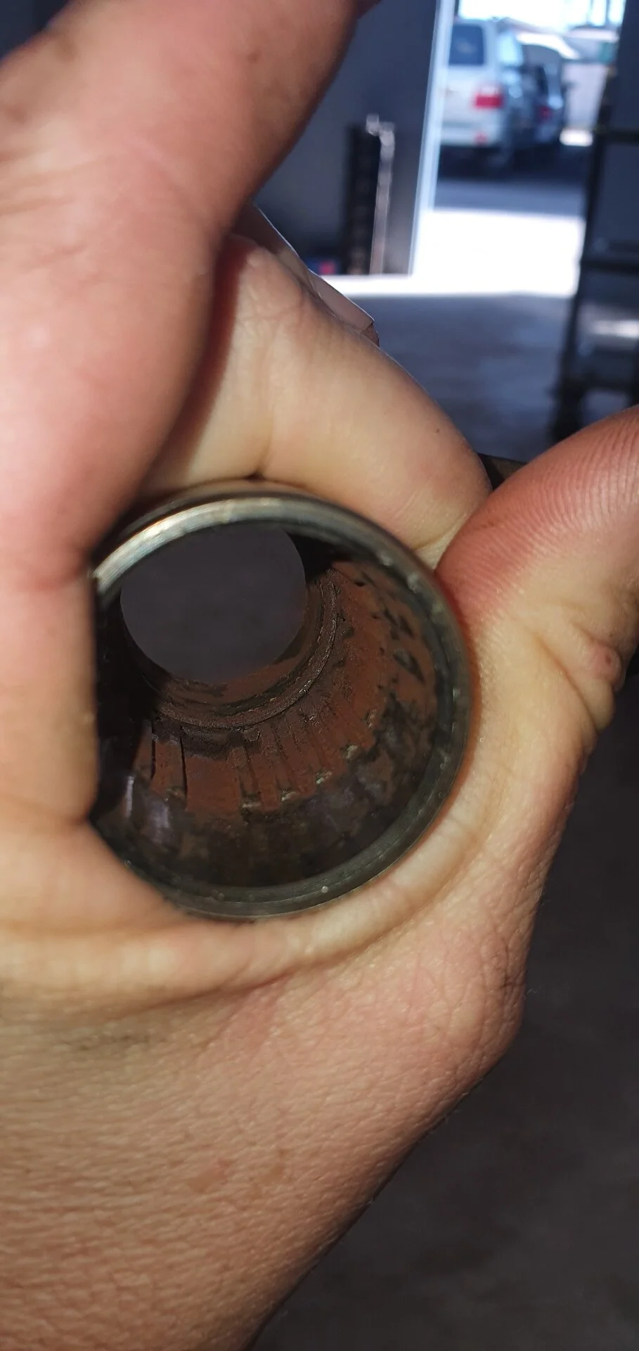

And then I had my first breakdown and failure. To be fair, it was one of my mods to enable this frankenstein to function, effectively one of my stitches came adrift. But what a stitch to break!
This little coupling connects my gearbox to my t case, and where it engages on the tcase splines, its now completely stripped.
Too much power and too little engagement on the splines. If I had greased it, maybe it would have lived longer but who knows.
So, because I now daily this rig, I need it back up and running ASAP. Best way forward right now is to delete the tcase, remake the flange off the back of the gear box to go straight to the rear diff and make a mount to hold it all up. In 1 day.

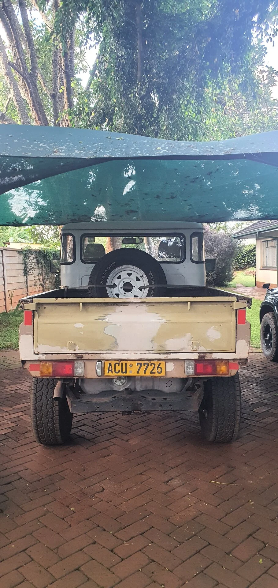

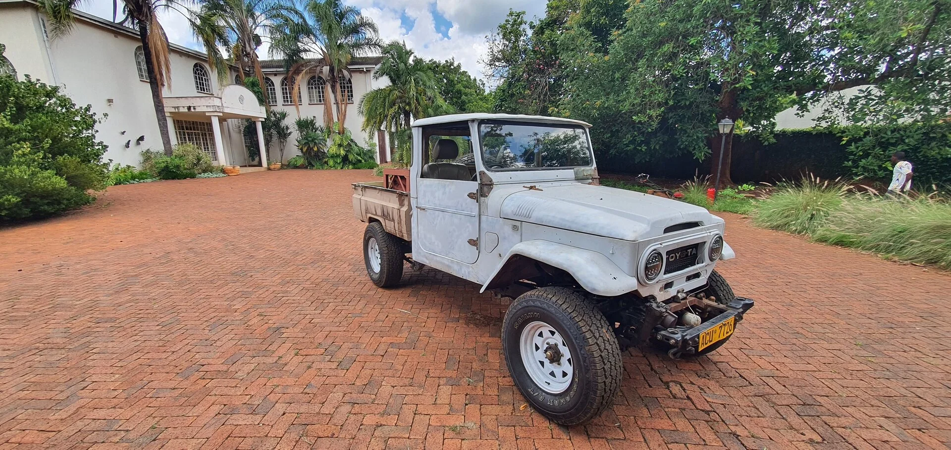

Rotated and balanced the tyres to try and get rid of some wobble that came in at 100kph. That cured it, now she's on rails all the way to 145kph.

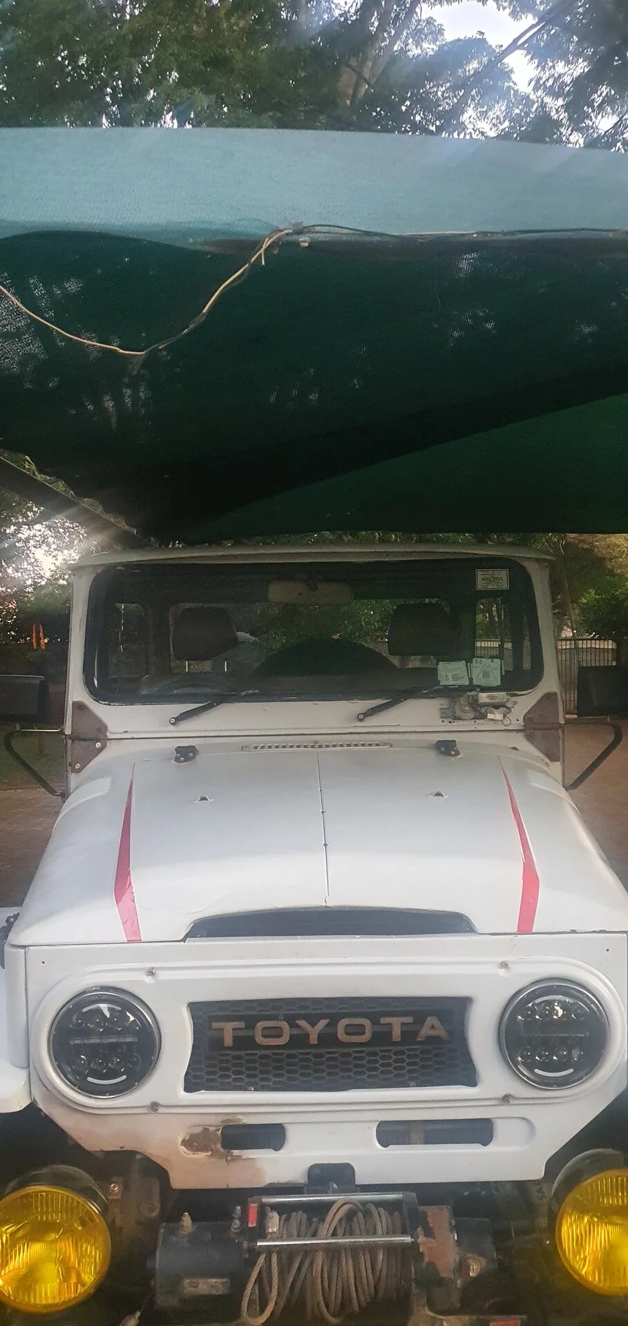

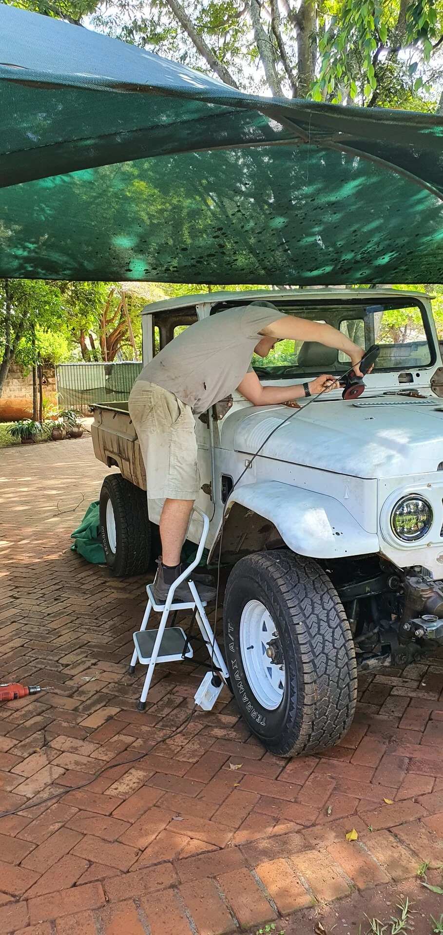

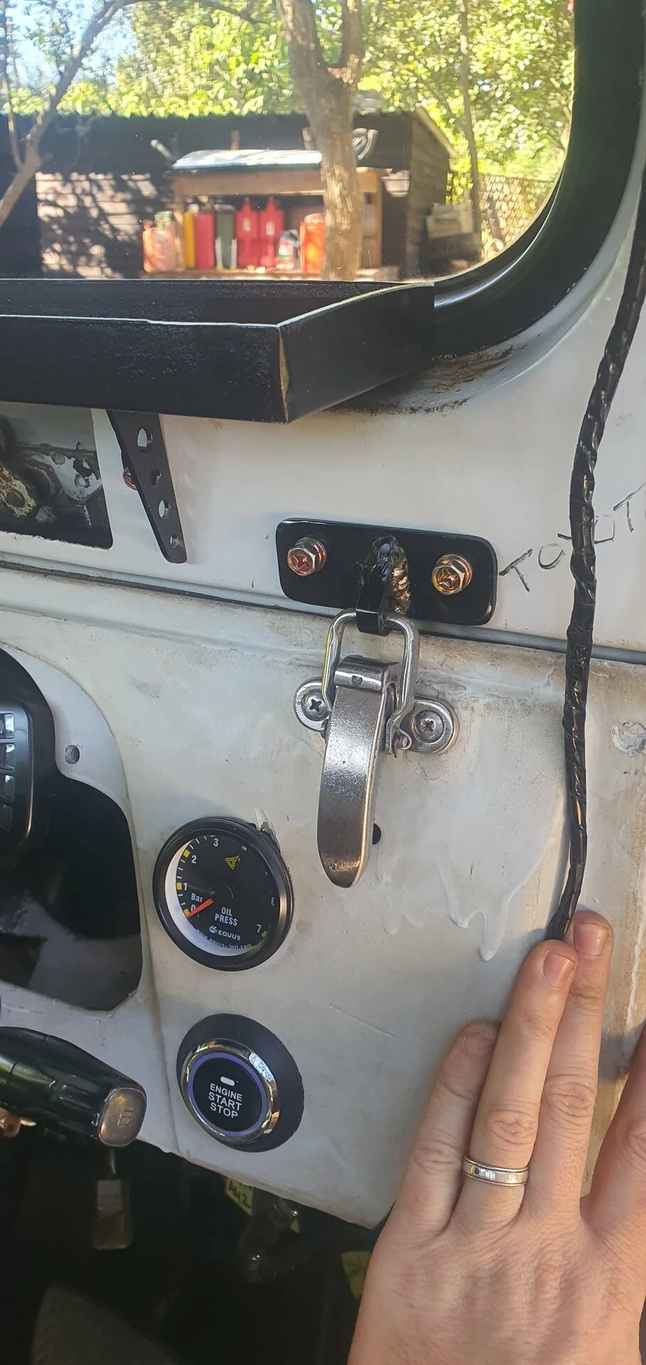

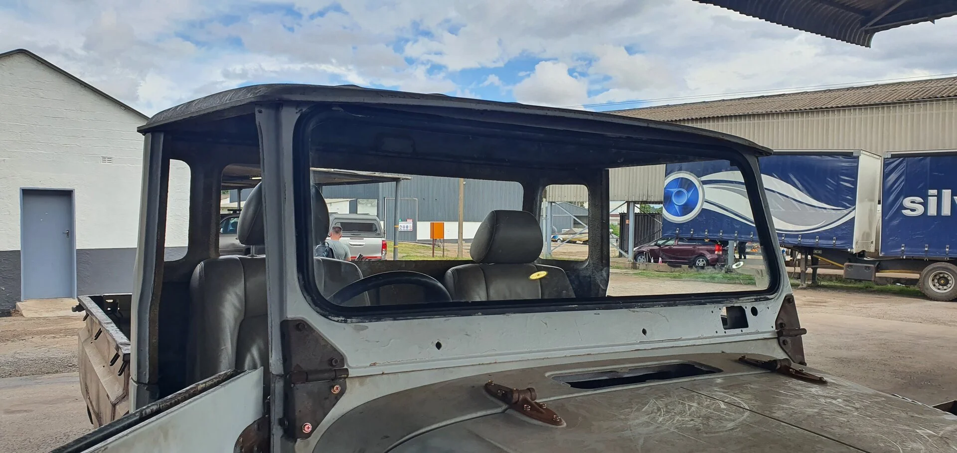

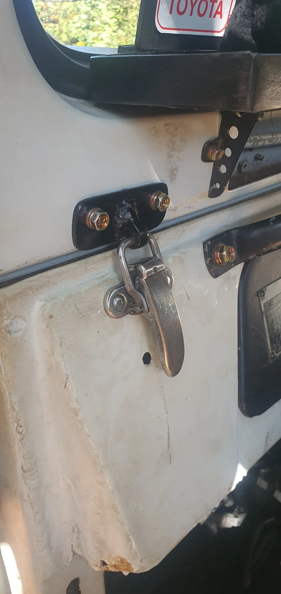

Made some hold down latches for the windscreen, again reusing some old OEM parts
That finally allowed me to get the roof off in readiness for our summer, at the least the dry part of it
And finally planning on my awning that allows me to enjoy the open air without getting sunburnt whilst sitting in traffic
