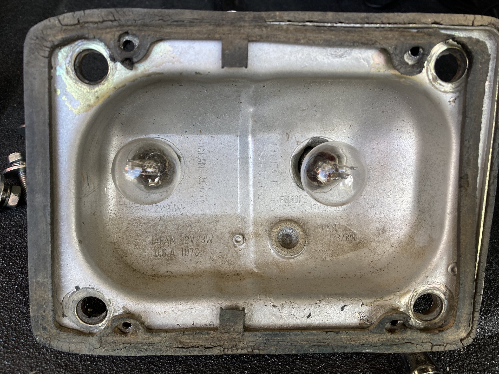

Trying to remember how these guys work. I see the four filaments, but don’t remember how each works. Parking, Break, Blinker
Anyone got this on the front of their mind, while I continue to search?
In the picture above, my tail lamp, has two bulbs w two filaments each. Which lights when? I am perhaps being restarted.

One would imagine that only the outside bulb worked w the blinker and then the running lights and the brake lights would both work off the inside bulb. Right?

Right.
The housing is clearly stamped.
USA 1073 on the left (turn)
1156 is electrically compatible
base: Ba15s (single contact/single filament)
USA 1034 on the right (tail/stop)
1157 is electrically equivalent (and will likely last longer)
Base: Ba15d (dual contact/dual filament) index base (axially offset pins, one direction only)
BA15 base is a Bayonet base with a diameter of 15mm (0.59in)
The letter after the base diameter represents the number of contacts on the bottom of the base:
  • D - double contact
  • S - Single contact
