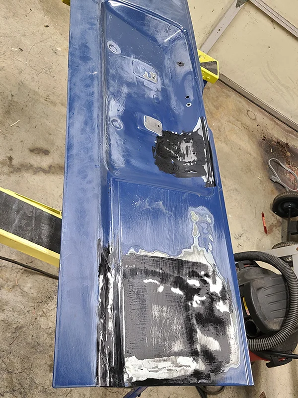

Couple weeks of minimal progress made due to focusing time on my kids and my new job, but made some serious headway last night and today. Didn't get a picture, but one of my "muscle memory" habits from welding thicker stuff popped up and bit me in the arse today and I blew a hole in my smaller patch (underneath the license plate light assembly). Without thinking, I pushed my weld "uphill" and put too much heat into the metal, causing a hole to form. Knew right away what I did, straightened up and let out a "you damn dummy". So that cost me some time, but I got the hole filled and all the welds finished and blended down on the patches.

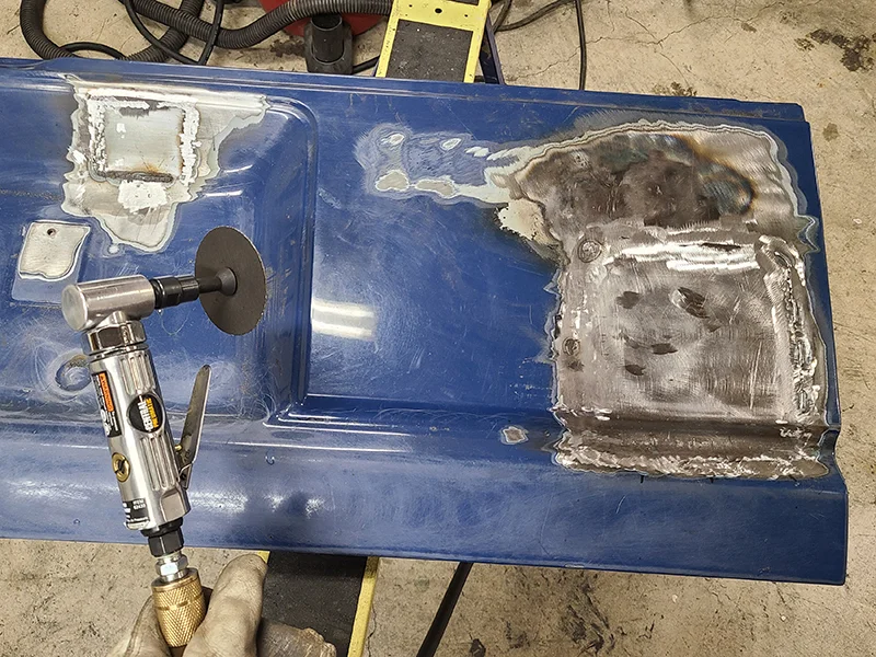

Almost done blending down the welds and about to massage the sheet metal as uniform as I can.

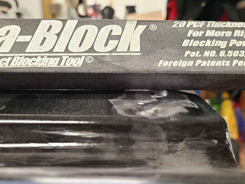

This spot is where it's the worst, but there was no way for me to avoid this happening. I'm thinking this is because it's so close to the edge where the sheet metal is folded over the seam and there just wasn't enough material to prop it up straight while I welded the patch in place. I'm sure someone more experienced in body work could've done it, but with my near zero experience and limited tooling, this was the closest I could get this particular section to even. Sadly there's going to end up being body filler used here. BOOOOOOOOOOOO. Fortunately, even though it looks much worse in the pic, it's only just over 1.16" gap, so not horrible. To be honest I'm considering grabbing a dent puller kit and slide hammer from Harbor Freight and seeing if I can pull this out a bit more. @kelly saad how would you go about minimizing a dip in an area like this? Any other body work pros here that can weigh in? No paint on yet so I'm open to ideas.

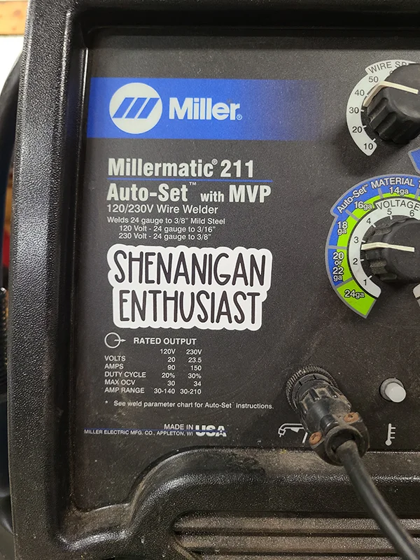

And just for grins, I found a decal while clearing off a kitchen counter (where all my unorganized junk is piled up) and figured my welder was the perfect spot for it :hillbilly:
That can be tough sometimes. I try to get a pry bar behind the seam I am welding to hold it in place, especially if it's under pressure and will end up with a low spot like you have. It's good to have it slightly low so that you have somewhere to apply the filler. Otherwise you will fight the high spots from the welds. Also, sometimes you can get the repair almost perfect, and when you grind it, the seam will cave in and all your work is trashed from the heat of grinding it. I move really slow with the welds and grinding, and try to keep the heat down, you must be patient. If it is a sensitive area, I will grind my welds slowly with the edge of a cutoff wheel on my grinder. It is more concentrated or specifically targeted only on the weld and much less heat. It takes forever though.

Awesome hearing that the cutoff wheel trick was a good idea. That's what I had been doing with my die grinder and then changing out with 2" abrasive pads to fully blend the weld and keep the heat from building up like you described. I wish I had thought of a pry bar when I welded to push the seam up level while in process. Do you think that gap I have right now is worth trying a stud type dent puller on, or should I just stick with body filler for it? I'm honestly tempted to attempt the puller in an effort to minimize filler being used (and the potential for future cracks), but on the other hand my money is tight so if it's not recommended I'll save my money. This is my lack of experience here creating a conundrum.

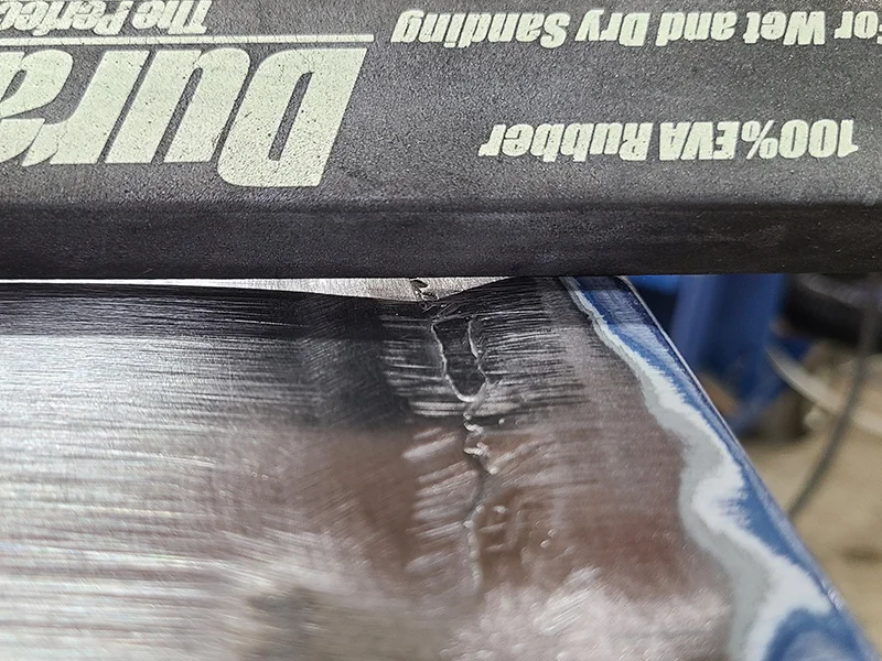

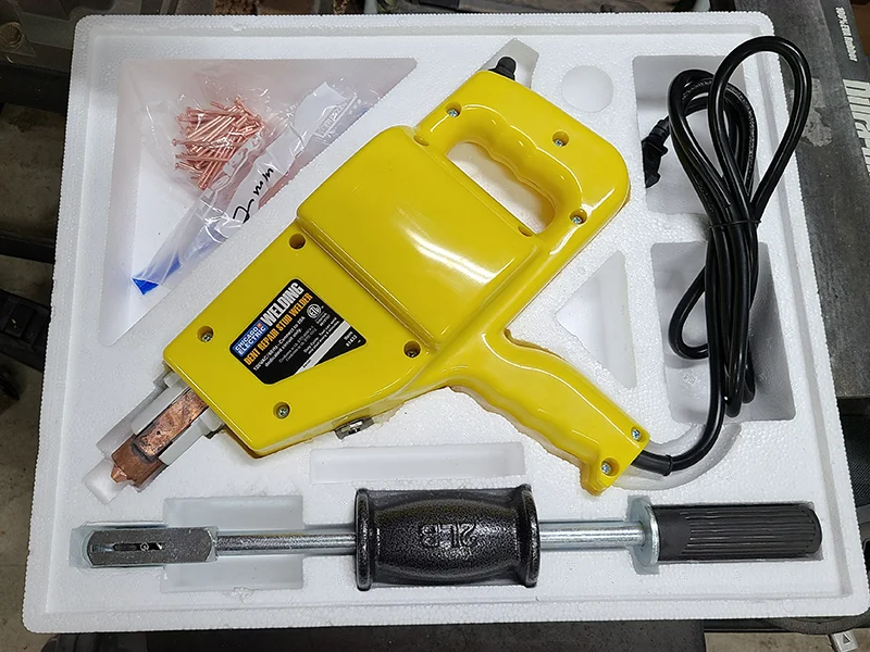

Well I ended up dropping $100 on a tool I wouldn't have needed had I thought to use a pry bar to avoid the sagged weld seam on the outboard edge of my tailgate. Chalk it up as part of the learning experience I suppose. There are plenty of other spots on my truck I'll be able to use it in the future so it's certainly not like the money will have been wasted.
The dent repair kit I picked up at Harbor Freight. This works surprisingly well, and you can get refills of the 2mm and 3mm pegs it uses.

I used six 3mm pegs along the length of the sagged seam and with a few hits on each one with the slide hammer, I got it pulled up to an almost perfect, even height.

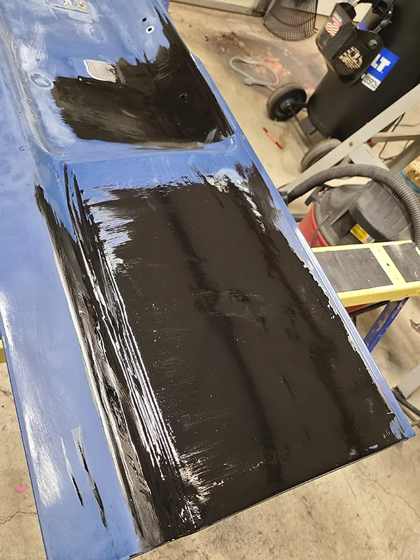

Some coarse block sanding to even out the surface a little more....

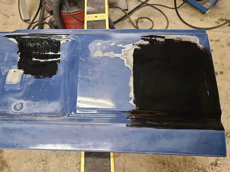

And a couple more coats of Chassis Saver to seal and slightly build up the low points (scratches, gouges and little pits)
I'm wondering if diluting the Chassis Saver might've made it spread and self level a little easier, but that didn't occur to me until I closed up shop for tonight. Just going to have to be a bit aggressive with the smoothing before I apply the tiny amount of filler I'll end up needing and then sanding that and priming. I likely won't on the bulk of my truck, but any panels I'm able to actually remove to recolor I'm thinking I will.

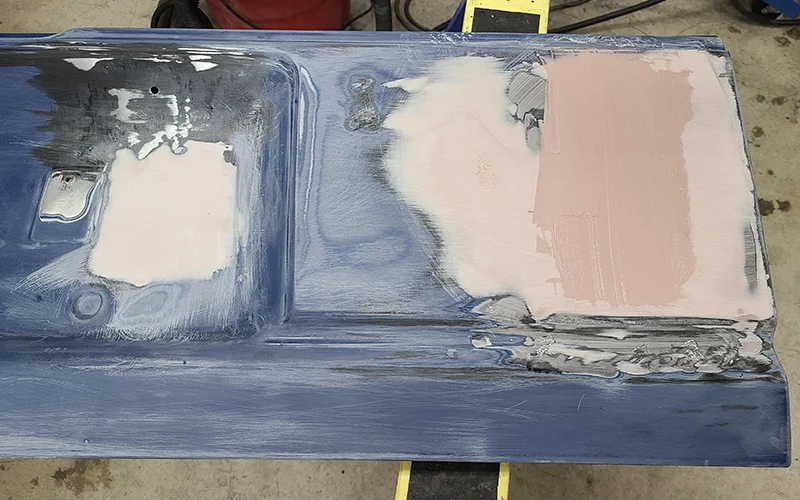

Bit more progress tonight. Smoothed the edge where I cut the center out, welded the holes closed where I drilled out the spot welds, and more Chassis Saver on the back sides of the patches and to give some protection to any low spots that may remain after sanding prior to priming. Tomorrow hopefully (if not tomorrow then Thursday) will be body filler over the large patch and sanding that smooth in preparation for primer. I'd love to find a way to hang it so I can prime both sides of the tailgate without flipping it front to back to do each side. Difficult to get a good picture from a "holding the phone up and press the button" perspective, but here's where I sit with the inner side...
To be completely honest, since I'll be using epoxy primer, I think the only places I NEEDED to use Chassis Saver was on the inside (the back sides of the patches). Likely overkill using it as much as I did for this job.

The stud gun / dent puller is an excellent tool. Only a C-note at hoorroorFright?, I may 'need' to get one myself, to reduce the carpal tunnel and other mobility issues associated with hammer and dolly, sanding blocks et cetera.
