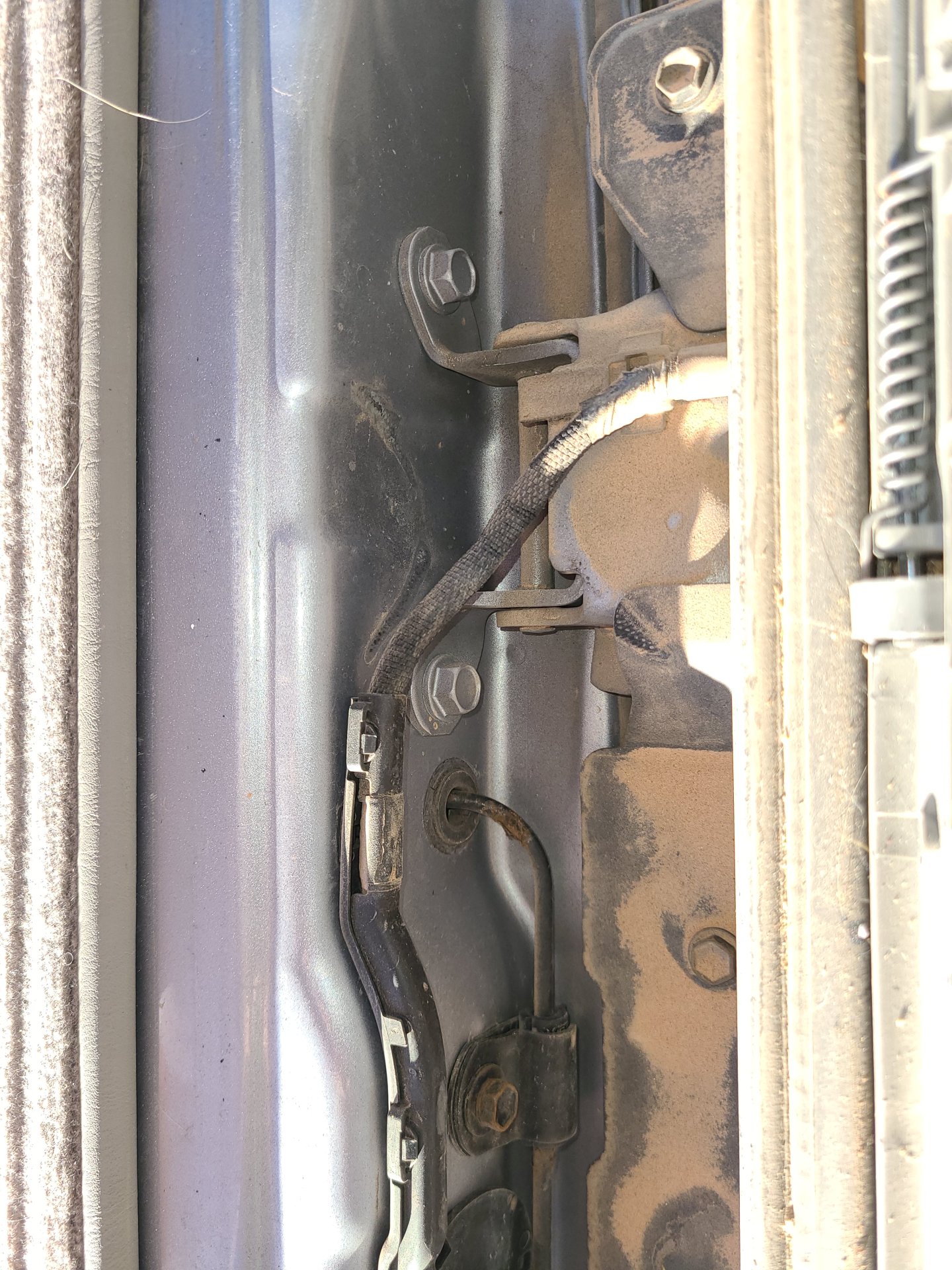

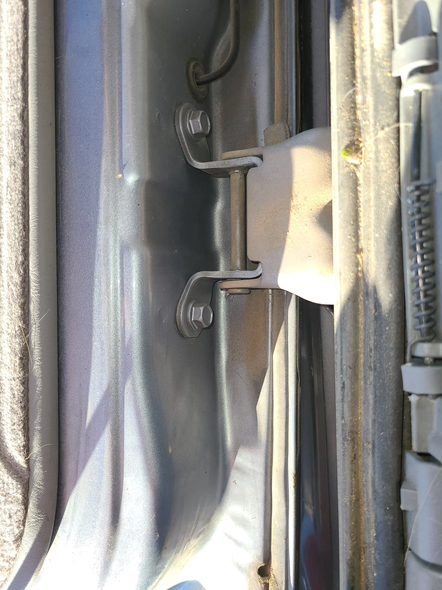

Ok. So just went out and looked at mine. 2005 LX470. Passenger side is no better of a spot. It looked like maybe from the pics earlier in this thread, but looking at mine, the passenger side doesnt have any better of a flat surface area on the right side. So I think, regardless of hinge differences, you're still back to cut-n-fab on the tailgate to get the necessary flat surface area. Edit: though on second thought, there is less "stuff" in the way on the right side of the passenger side hinge--so if you're fabbin a flat spot, that'd be easier.
Passenger side:
Drivers side:

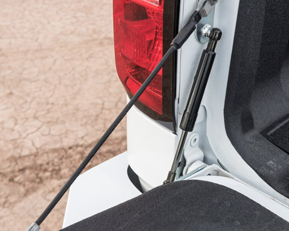

Gas struts might be the ticket. If they can figure it out for truck bed tailgates, we should be able to apply the same idea. Although, DeeZee's solution has a custom fab mounting point for the shock and stay.
As far as ease of installation/application, I think you might be right. If the 200 damper is going to require fabbin on the tailgate, vs if you can just perhaps add a bracket or two and install a strut, thats a no-brainer to just go with the strut. I'm going to have to go out to the garage and poke around the LX some more as well.

I tried this, it's more difficult to fit on the 100 than it looks, because of the space between the gate and body.
