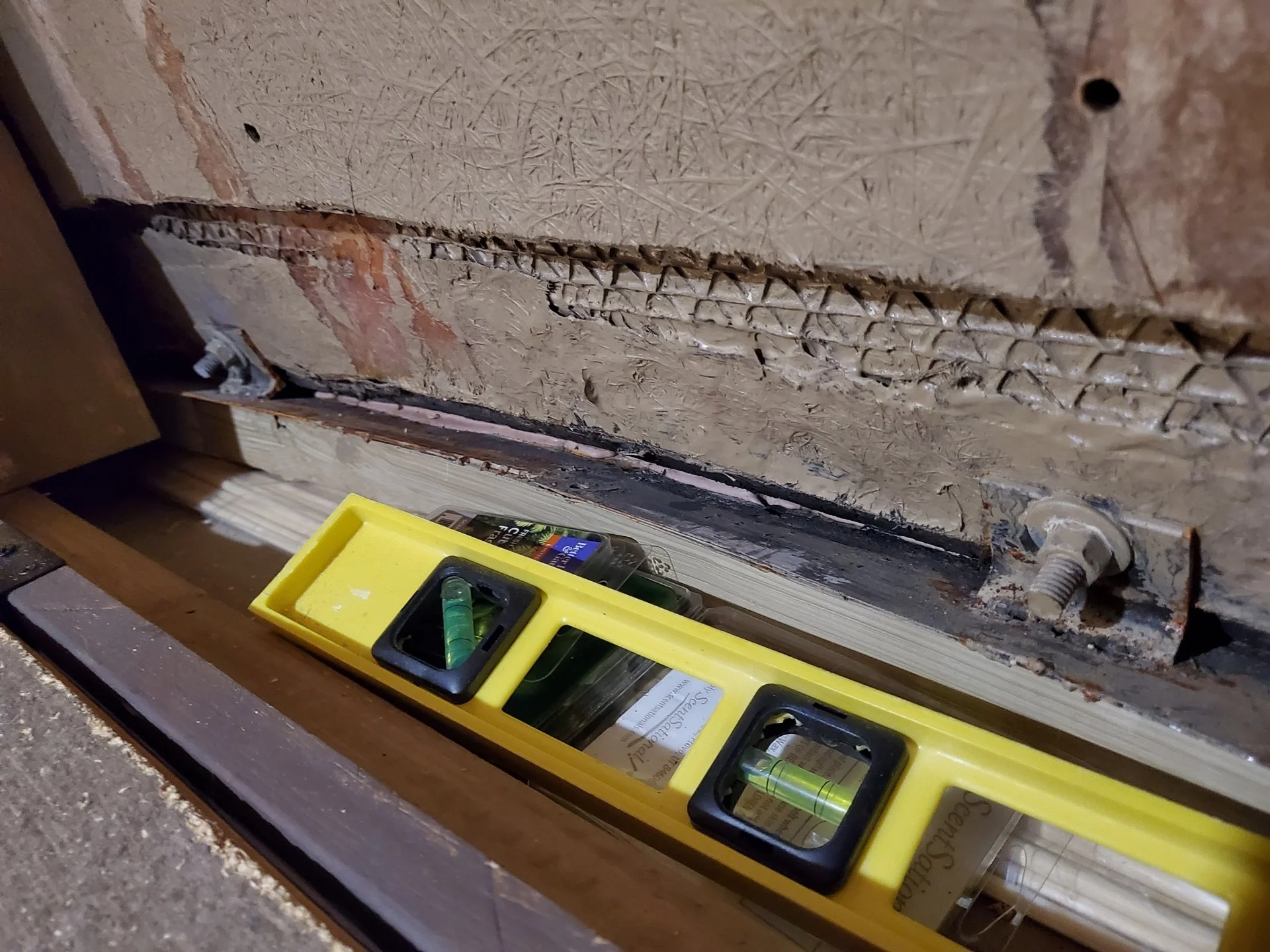

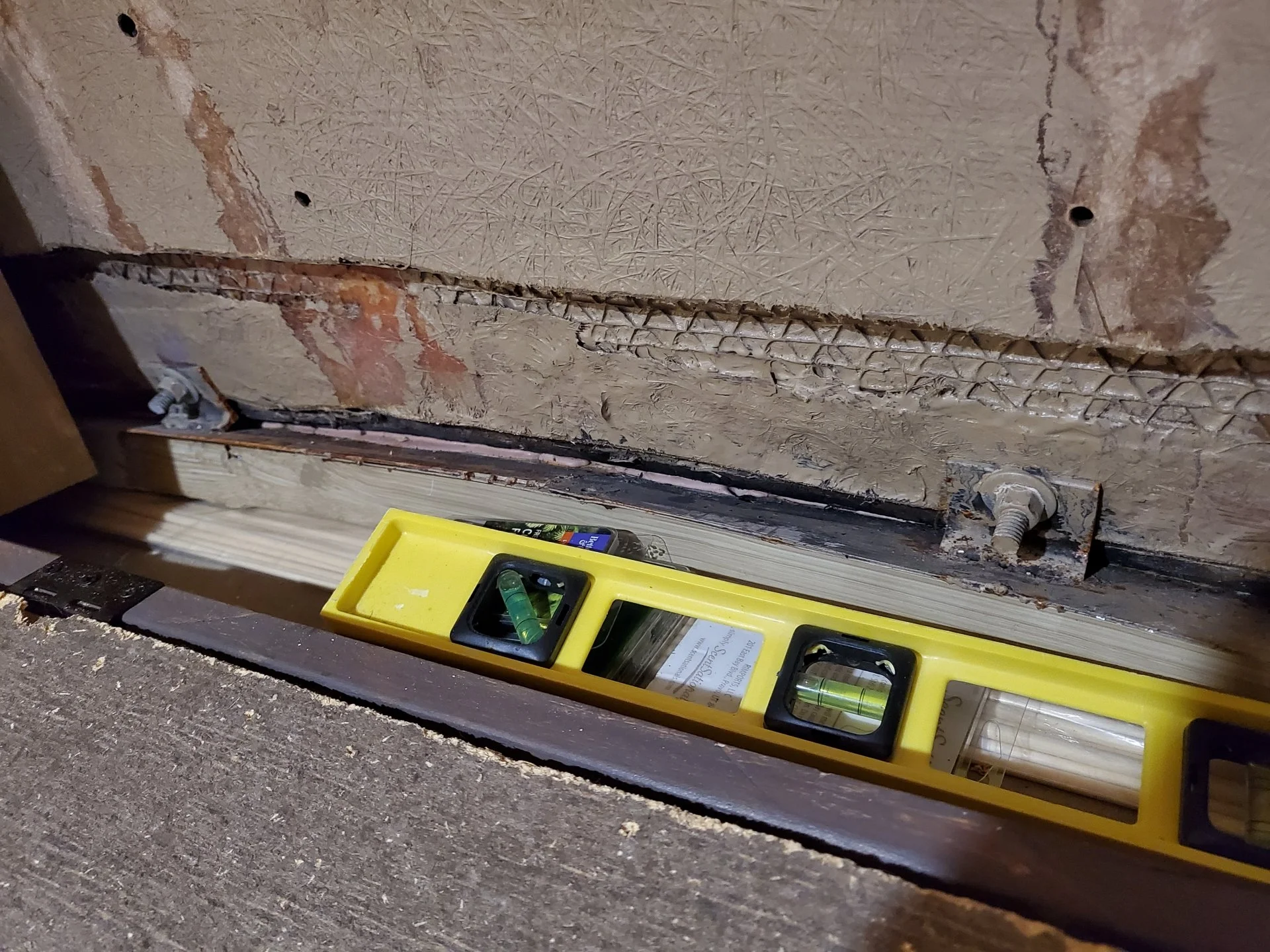

so I have braced it in 6 or 8 different locations across the top of the windshield bu welding in 3/16 tabs to the and through bolting it. I'll throw up a few pics to make it clear(er). The idea is to make it as solid as possible and eliminate any movement b/w the chassis and the fiber glass shell.
I think the issue is really the frame, it's 22ft.+ and not boxed in so it flexes A LOT. Aside from boxing it in partially or fully there's not much i can do about it so I'm thinking the "easier" fix is to create a flexible seam, doesn't have to move a lot, maybe an 1/-16 to an 1/8 at the very most but wont crack or break the seal.

2 of a total of 7 location across the top
I think your flexible joint idea is likely your best route. Sounds like you've made a strong attempt at hard mounting, to little avail. The shell sounds like it has too much flex to make a good solid mount.
I'd say clean the seam good and find you some type of weather stripping, maybe like a bulb door seal or something similar and slide that along the edge of the fiberglass shell. Then tighten down your fasteners and maybe put some silicone behind that just for good measure. Silicone should seal the seal to the top of the cab, door seal will give you that minor amount of flex to let the 2 move just a little.
