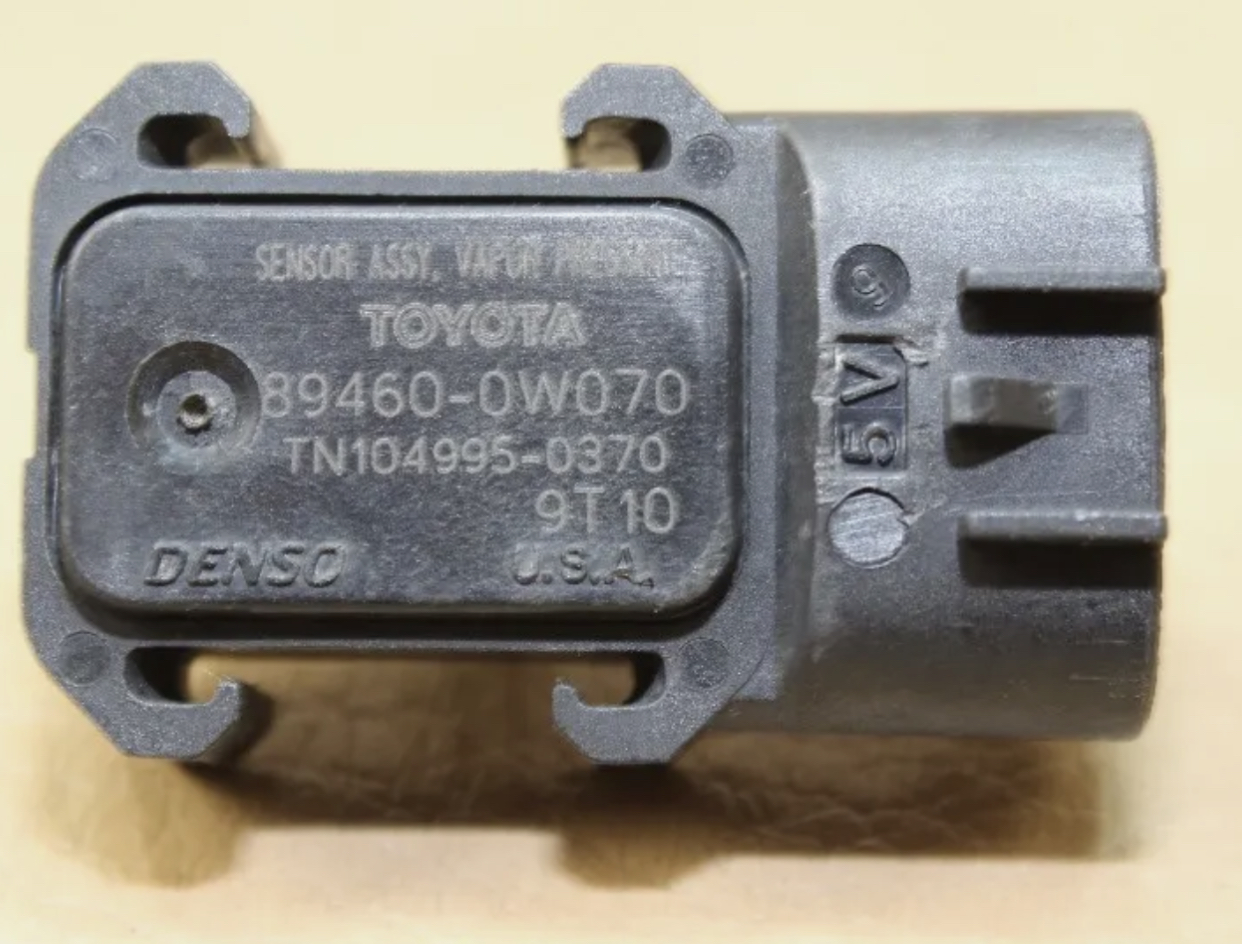

A few days after kayaking the truck’s check engine light came on and showed a PO450 code. Womp womp. The truck was sluggish and would shake when I applied gas. Not good. What I could find online showed this code was due to the vapor pressure sensor. It’s no longer available from Toyota but Luckily eBay had a used one from a low mileage 98-01 4Runner which plugs right up to the wiring and clips on the same place -p/n 89460-0W070. I installed it and while I was under the hood I installed new plugs and wires. While doing that I noticed a large crack in one of the vacuum hoses. The hose had different id’s at each end so I had to create a new one using two sized hoses and a connector I had in my air compressor hardware stash.

I just had this exact issue. I replaced the sensor with the one quoted above. I also fixed a cracked hose. I ordered valve 25860-75100 but didn’t need it. Things are still good after the repair,
Update so other than I am really slow and really busy. I was finally able to complete my Vacuum sensor replacement and check of all the vacuum hoses. The single MAP Sensor replacement fixed the issue for now. I will wait to call it 100% success till I get few 100 miles on it. I got the part from Auto Zone but had to wait about 3 days for them to get one to store. I had to cut off an alignment protrusion as it did not match up with my plug. After that it plugged in just fine. I had dead battery after letting it sit for 3 plus weeks and had to charge it over night. I just got back from 15 minute test drive. Yea for me.
