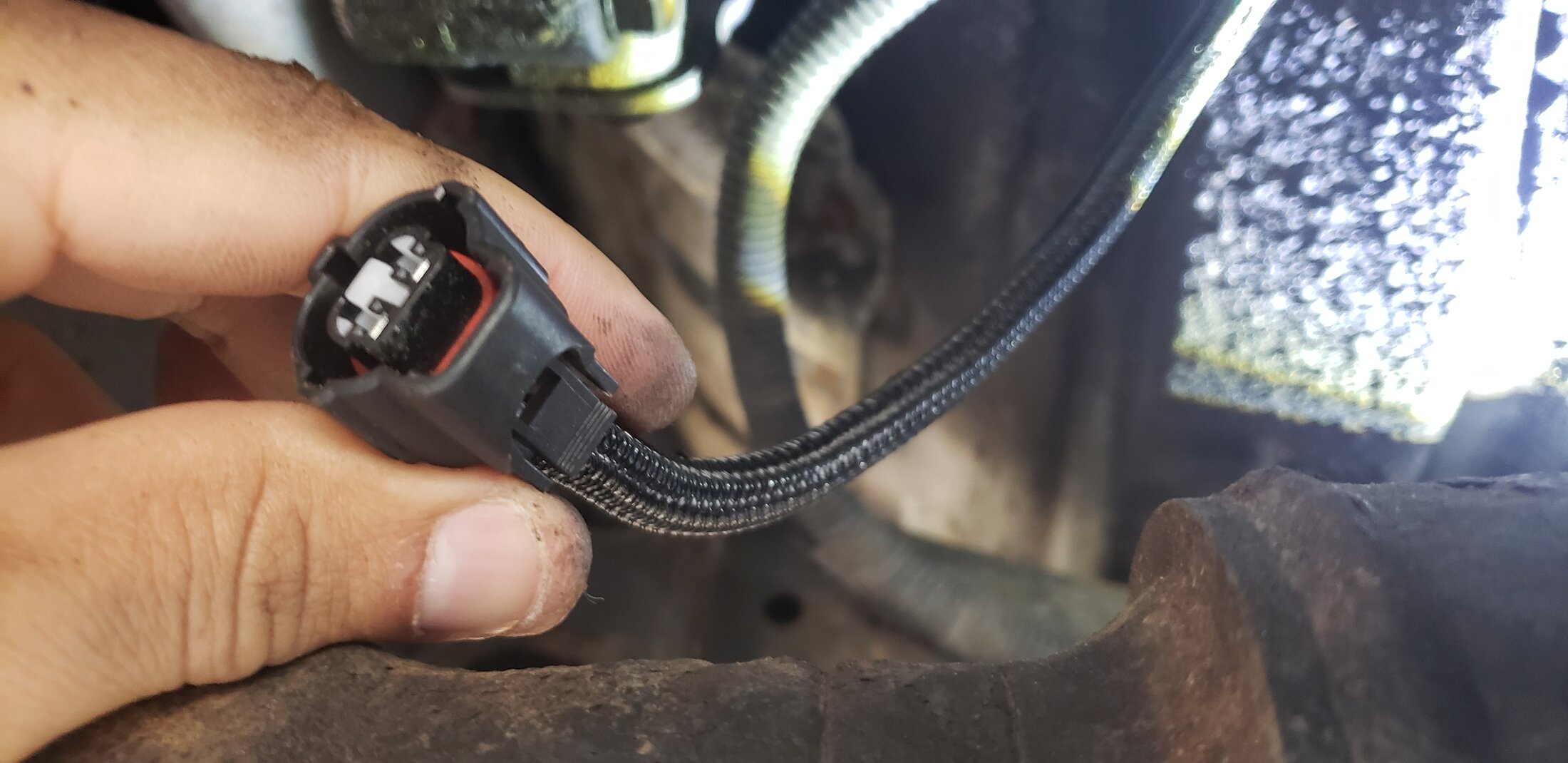

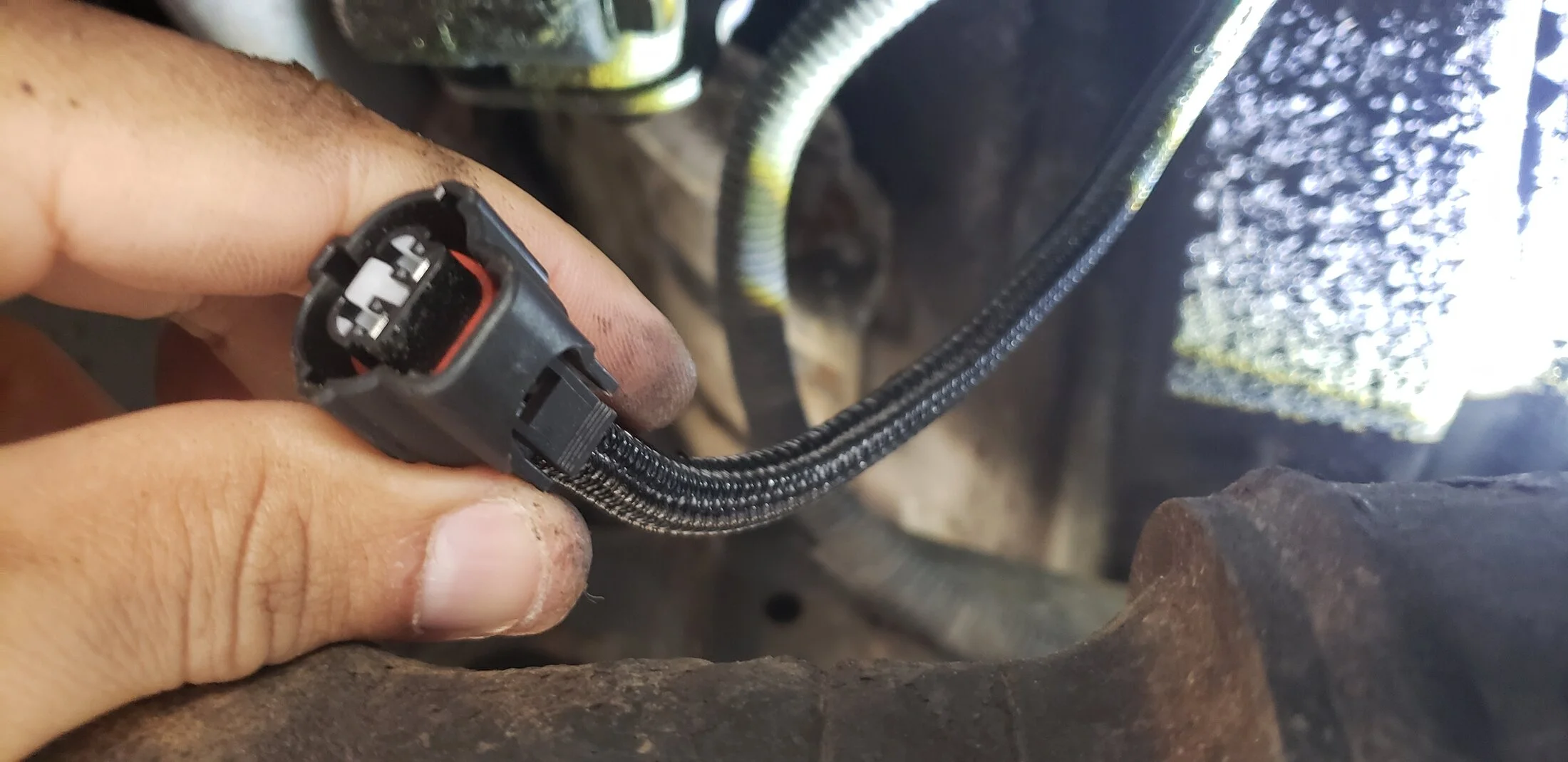

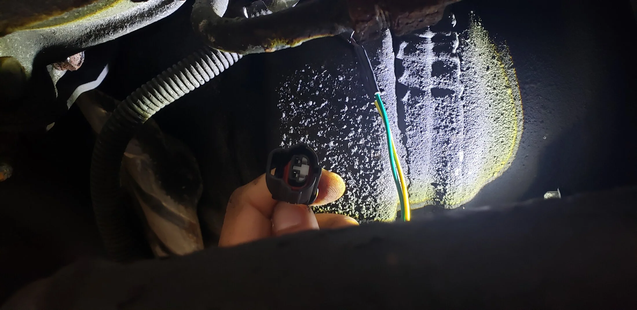

Crawled underneath to check the plug on the CDL position switch/sensor and one of the wires had broken off of the plug :doh:
It was like deja vu cause I had the same thing happen to the trans temp sensor recently after pressure washing the undercarriage (doh!!)

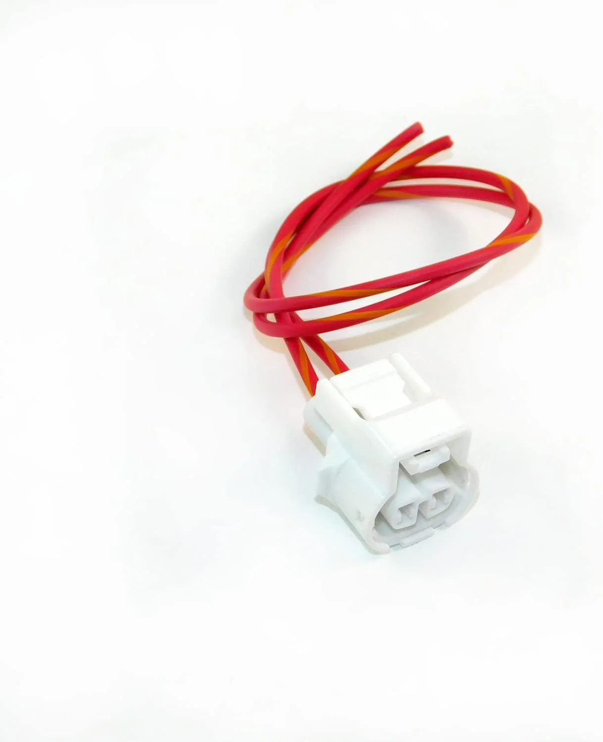

I wanted to order a new pigtail, so I tried pulling the plug to snap a pic and ended up breaking the other wire as well (both kinda brittle)
Appears to be the same plug used on the trans temp sensor and I already have it on order for tomorrow :banana:
Thing is, I don't know which wire goes where on the plug since both broke flush on the connector :bang:
Since it appears to be a basic switch, I'm assuming it wouldn't really matter either way as it just needs to complete the circuit, but does anyone happen to have a wiring diagram handy so I don't goof things up when soldering tomorrow? :meh:

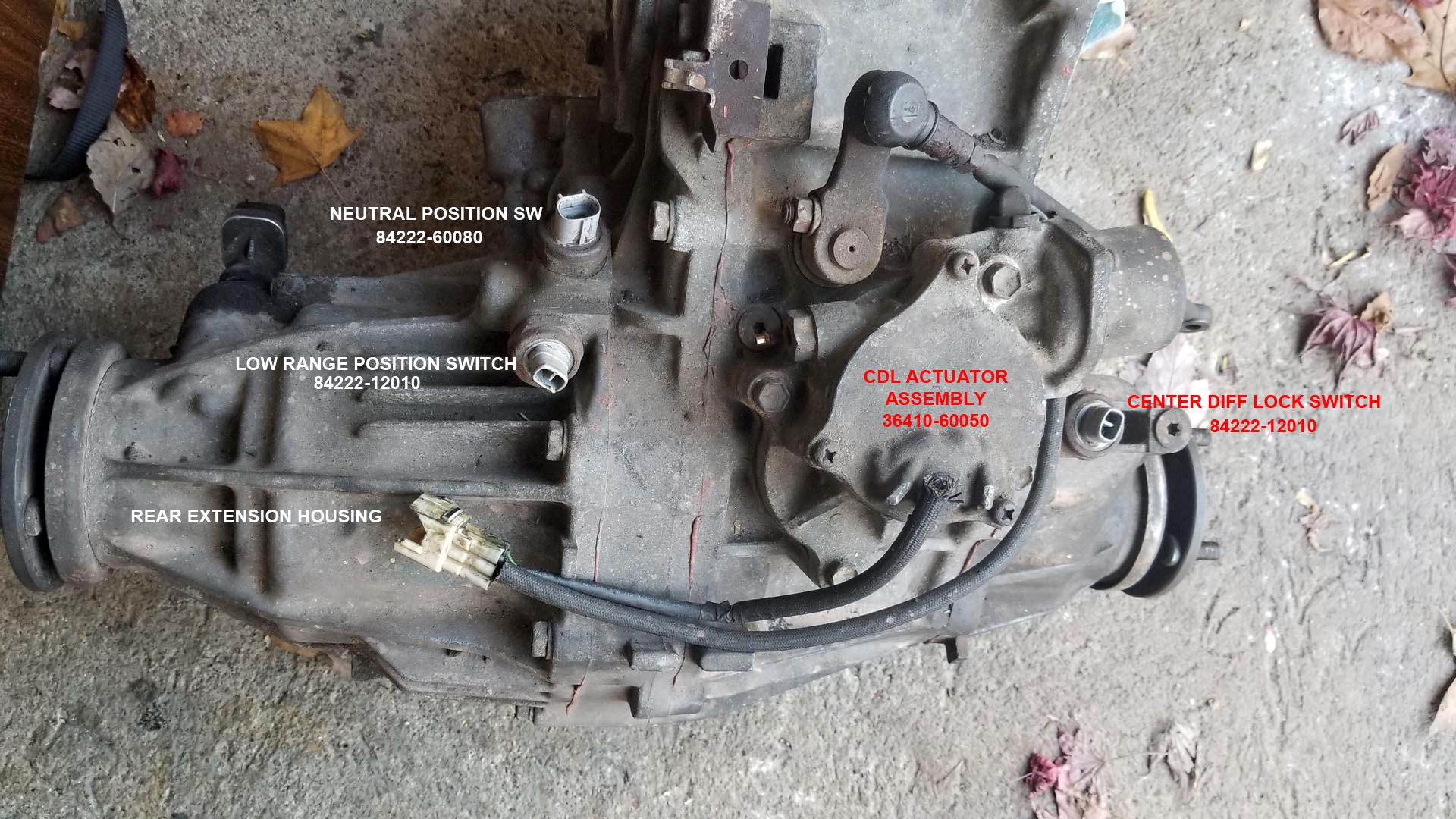

Ok, it appears I was mistaken 🤔
After checking out another CDL thread, I stumbled upon this pic of a T-case
The pigtail I need is for the Neutral Position Switch, not the CDL switch :doh:

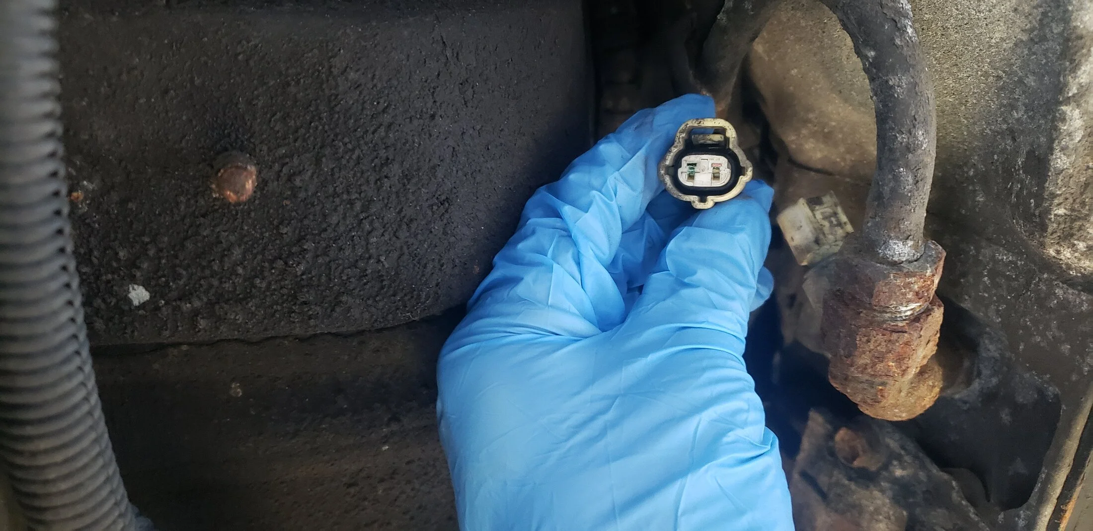

Just crawled underneath again to confirm the CDL switch plug is ok and it is, but then I noticed a loose wire on the Low Range Position switch :confused:
Pulled that plug and other wire on that one snapped off flush too :bang:
Ordered a pigtail for that one as well, but same dilemma with the wiring as to which one goes where on the connector :meh:
That being said, since I already have the 7-pin, is the low range position switch circuit even necessary :hmm:

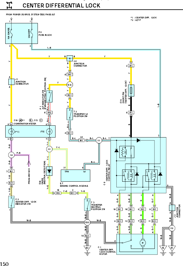

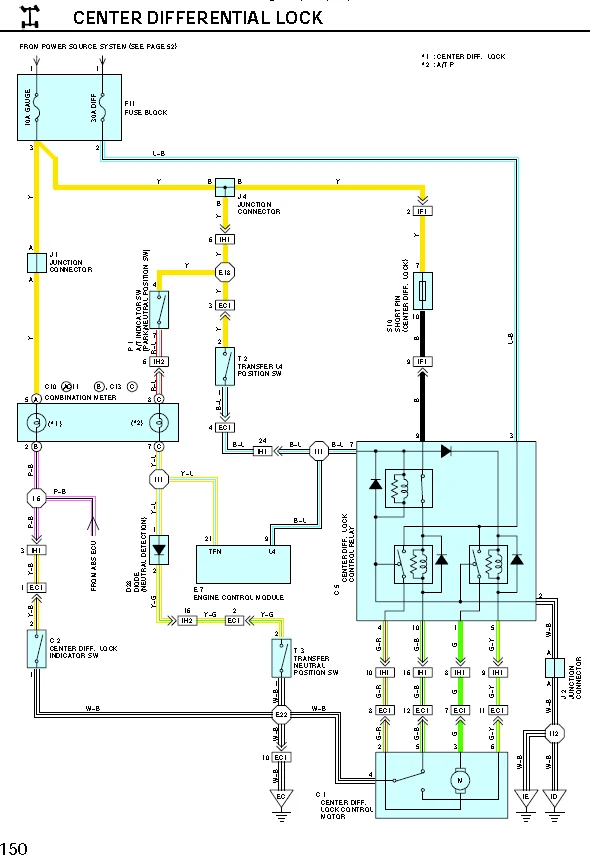

If you download the EWD manual from the resource section it will have the connector pin outs in it. Not sure about your low range position switch but I would think you want it all connected up just so it doesn’t get forgotten about.
I've been sifting through the EWD for over an hour, but can't seem to find direct pin outs on the center diff page (#152) :hmm:
Gunna repair with a new pigtail regardless of whether or not it still used :banana:

Yes, with the pin 7 mod the 4Low position sensor is just decorative. The Neutral position will have no bearing on the function of the lockers center, front or rear. The CDL sensor is the only critical one. Yes, they are just simple switches, makes no difference on polarity. They function by switching the circuit to ground.
The CDL switch is in the lower left corner. Pin 1: BLK/WHT Pin 2: YEL/BLK
As stated, it's a switch. Makes no difference what pin is what.
Pins 82998-12440

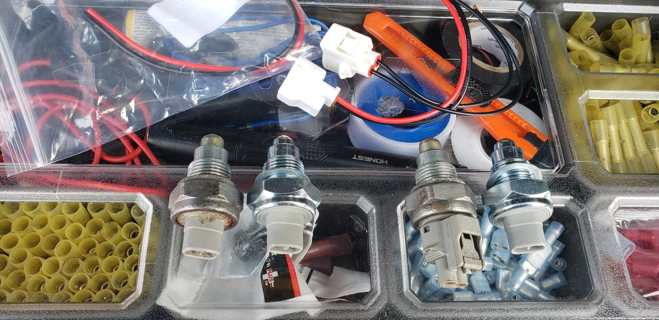

OK, while soldering in two new connector pigtails for the Neutral Position Switch and the Low Range Position Switch, I decided to pull all three switches for testing :hmm:
I cleaned them up, but they were all kinda hit or miss according to my meter, so I replaced both the Low Range (even though it's not being used with Pin 7 mod) and CDL Switches :cool:
All appear to be working fine, but I'm gunna order a new Neutral Position Switch as well and throw it in anyways :meh:
