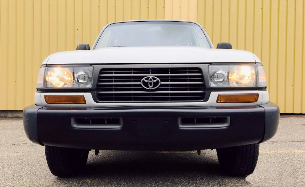

The front bumper was not as nice as it could have been when I bought the car, either. You can see in the photo that it was pushed in slightly at the center, which caused a raised area at the top. Not impossible to fix, of course, but it had also been rattle can painted black (which is not the correct color):

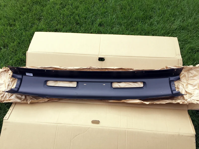

Lo and behold, new bumpers were still available when I looked, so I bought one. I got the ends too, but didn't take a photo.

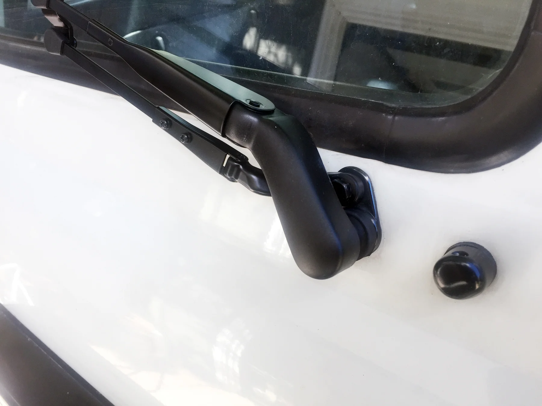

What else have I done recently? Let's see...I replaced one of the rear window wipers. The original was broken and had been repaired with baling wire as shown here:
Found a new one and bolted it on. Much better:

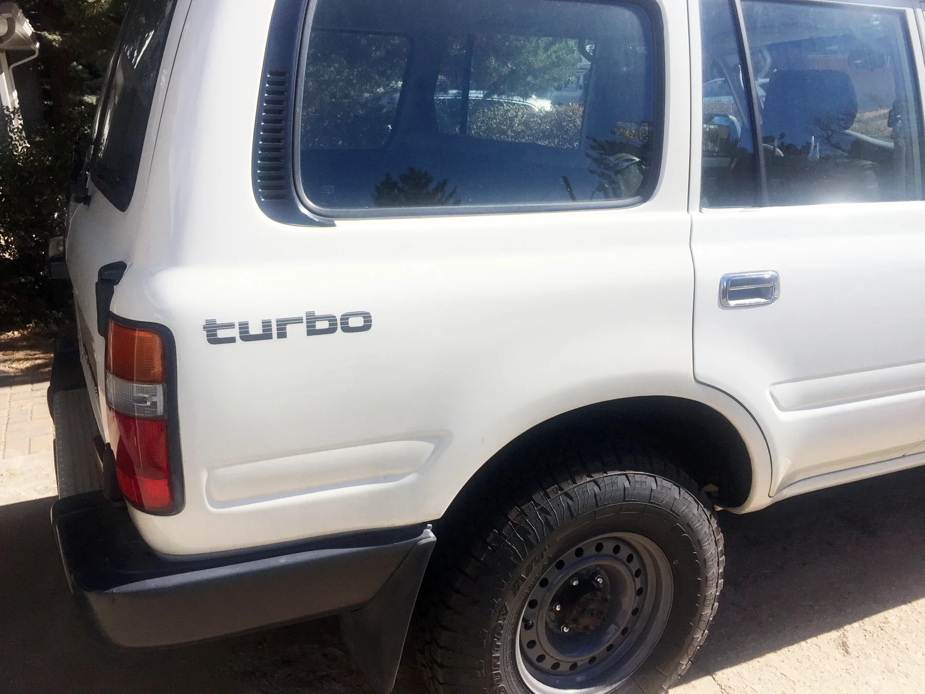

And I added a "turbo" sticker to the passenger side rear quarter panel. Sometime before I bought the car, the right rear quarter panel had been repainted for some reason and they didn't replace the "turbo" decal.
When it was repainted, they put clear coat over the white, which will never match the original paint on the rest of the car. I had thought I'd have it redone properly to OEM spec, but I got over it and just put the decal on.

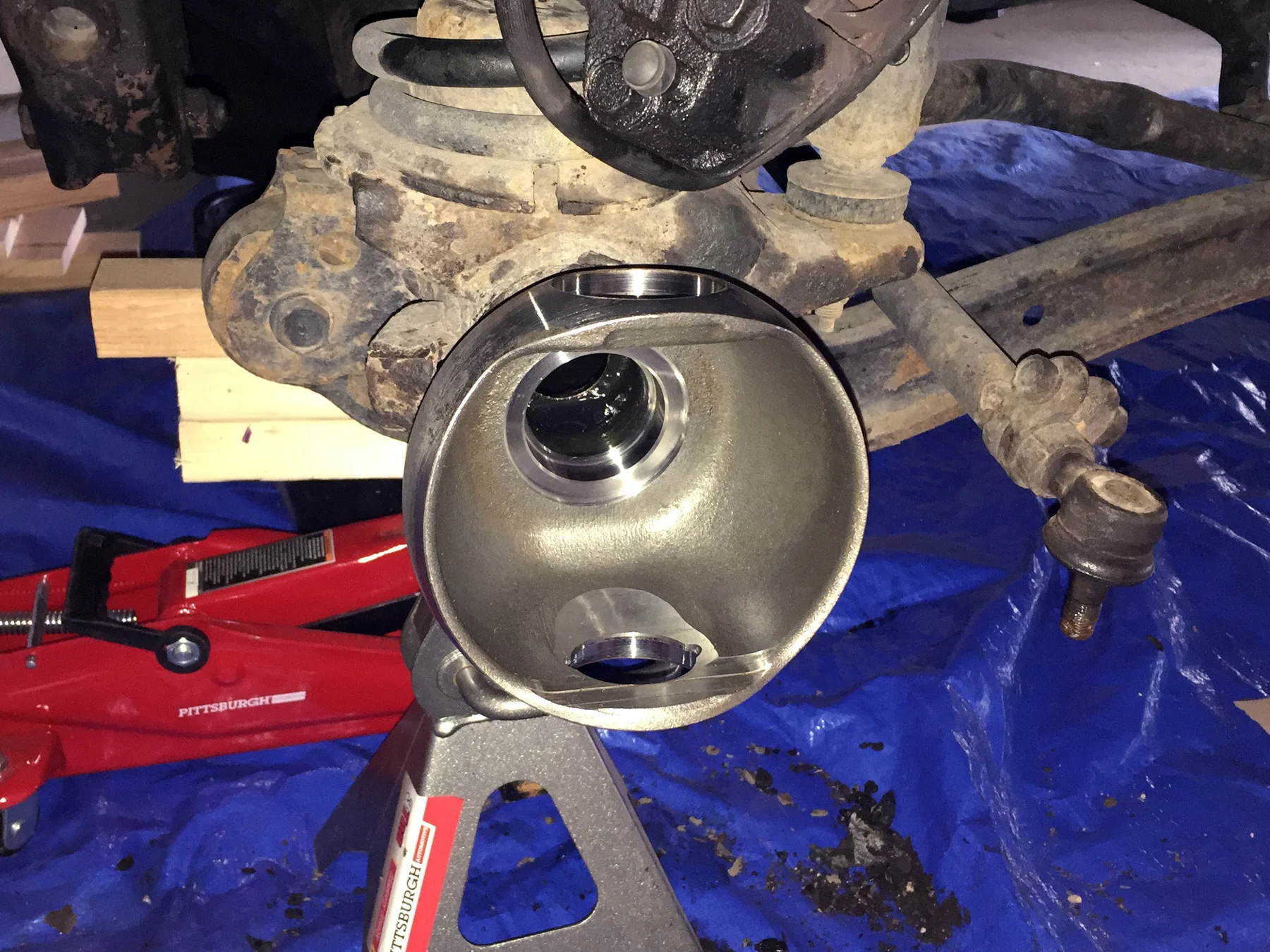

Now, there comes a time in every Landcruiser owner's life when he/she needs to tackle the front axle seals, and it seems like now was that time. So apart comes the whole kit and caboodle:

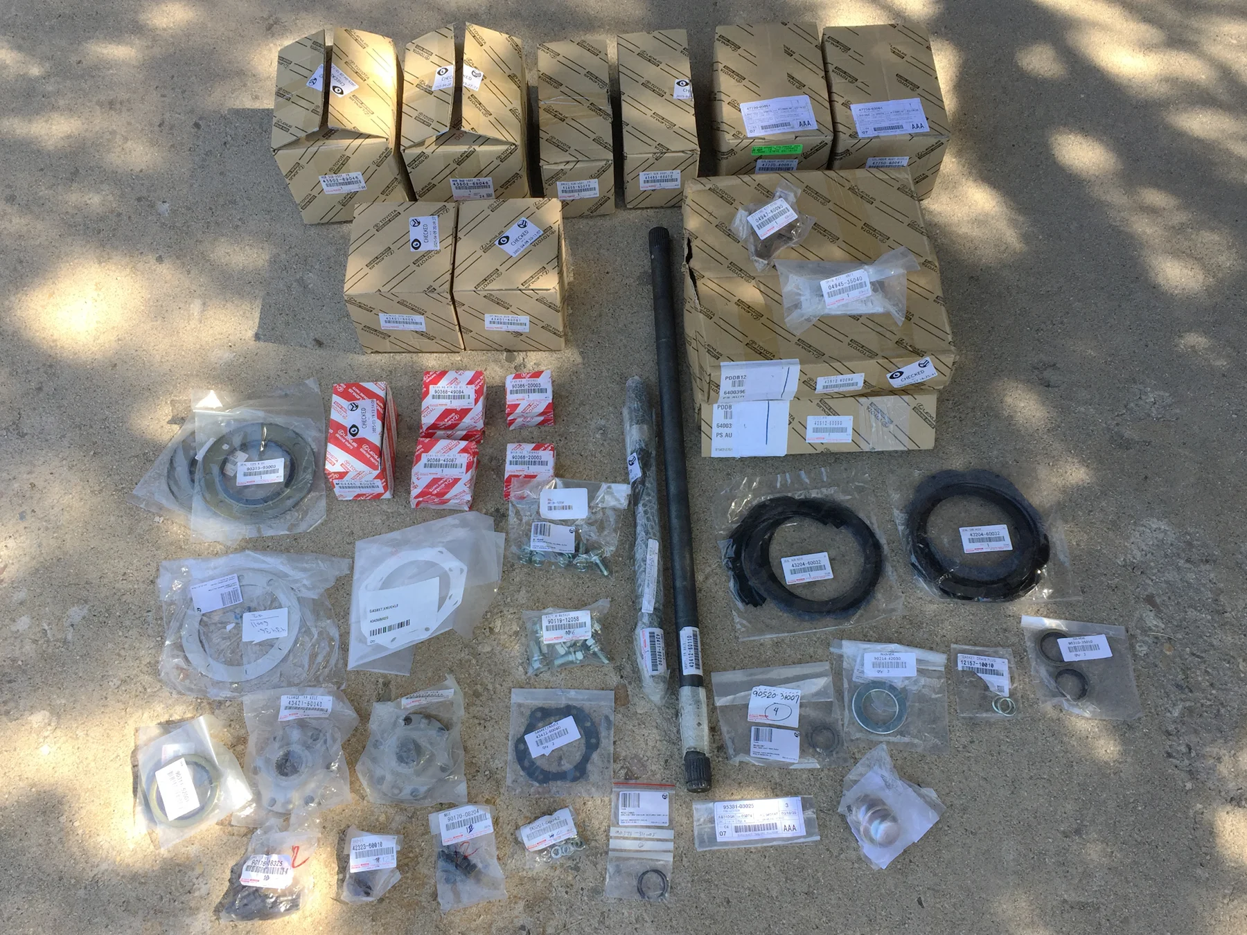

Parts were ordered:

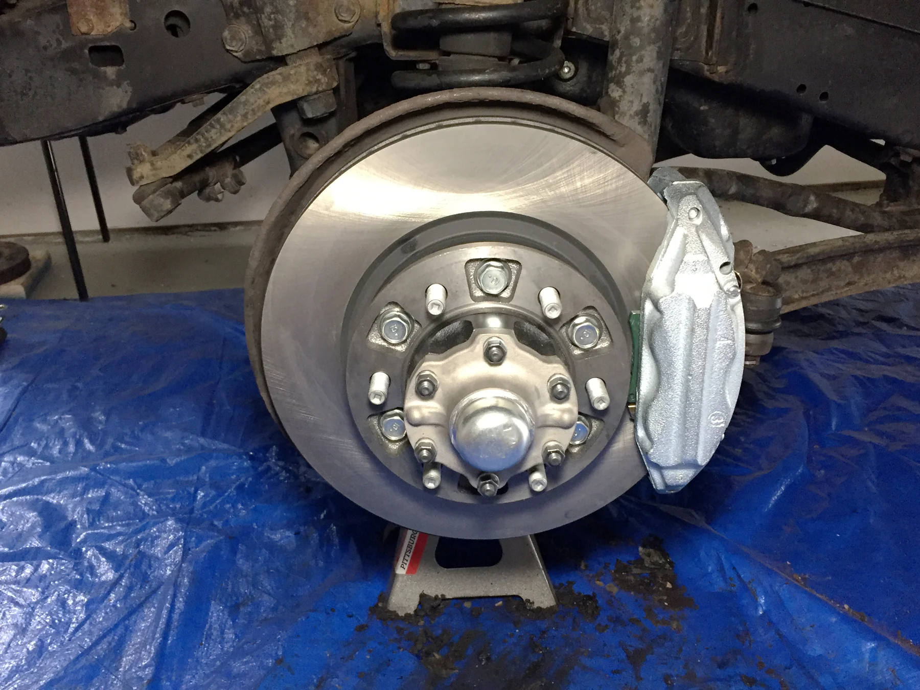

And everything re-assembled:
I started out thinking I'd just replace the seals, clean, inspect, and re-pack the bearings and put it all together, but, of course, it never goes like that. When I got the wheel off, I immediately see that the disc is scored from a sticking caliper. Add new discs and calipers to the shopping list (too far gone to be machined). When I'm taking everything apart, I see that some bonehead had apparently used a steel chisel to undo the spindle nuts, putting big divots in them and making them and the thrust washer useless for re-use. Hint: just get the correct giant socket. Same guy had knocked the bearing races out (probably with the same big dumb chisel) and scored the hubs pretty badly. Axles were grooved pretty significantly where the seal rides. You get the idea. So I just got everything, all OEM Toyota, all brand new. Should be good for another 30 years now.

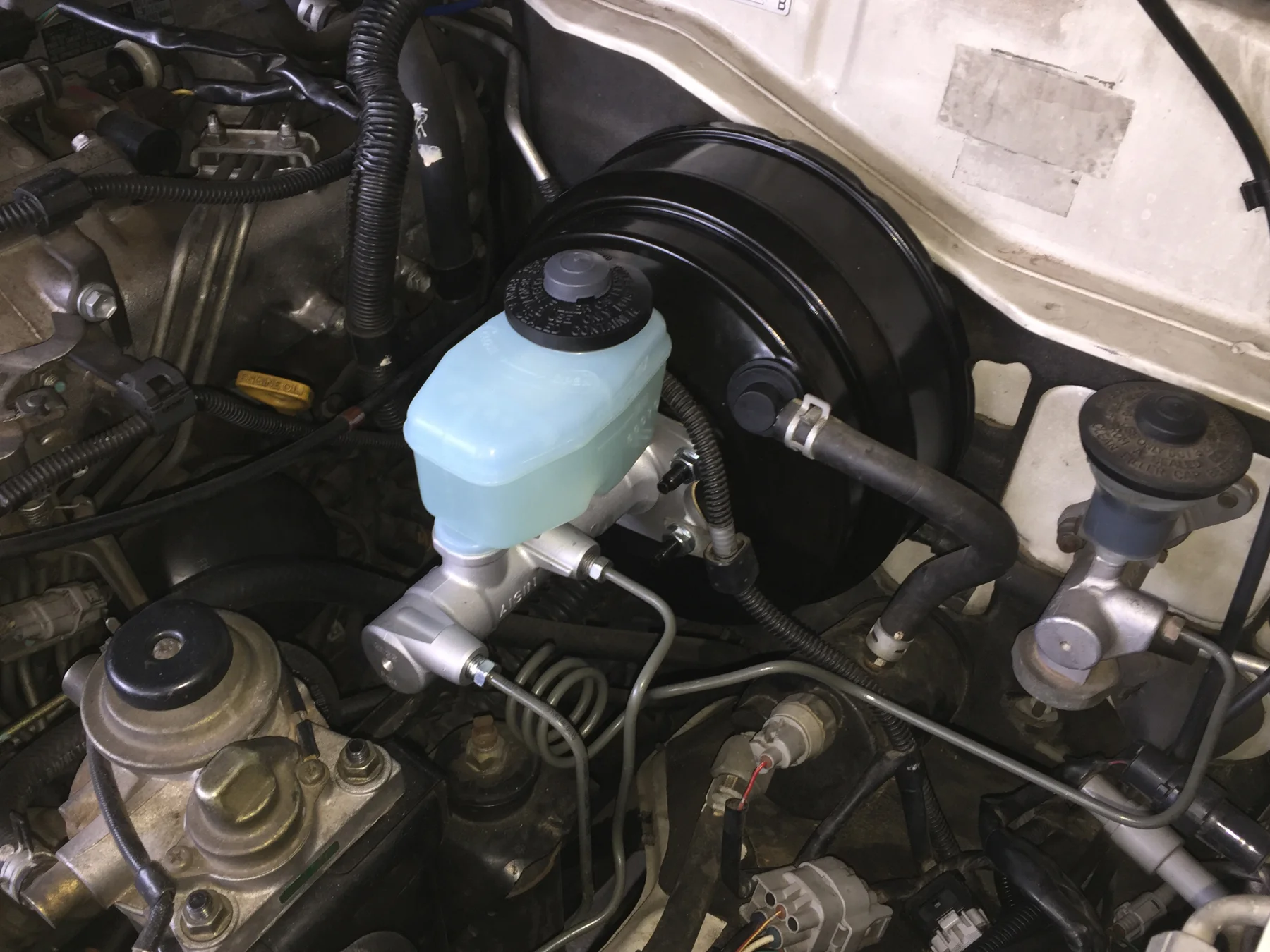

After I finished the knuckle rebuild I noticed the brake booster was starting to leak slightly. Difficult to find a new one, but eventually I did. Had to replace the master cylinder at the same time to get it all to work. Thanks to @cruiseroutfit with assistance on that.
Out with the old:
In with the new:
