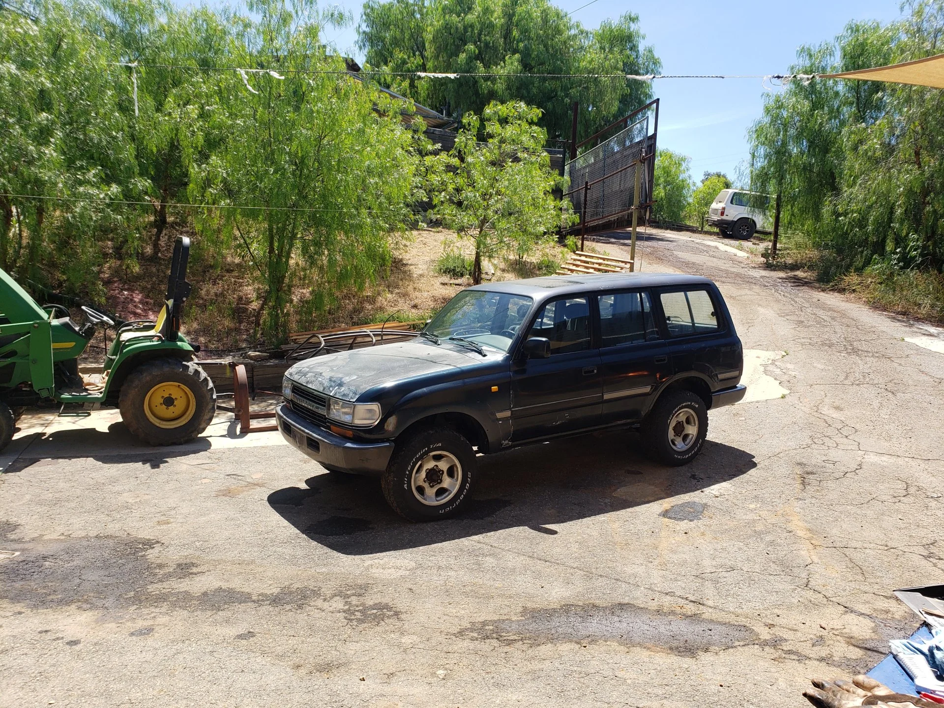

The photos I posted of my car driving off the ship upon arrival are actually stills from a video, I was just too lazy the other night when I posted to bother uploading the video to YouTube so I could post it here. But here it is:

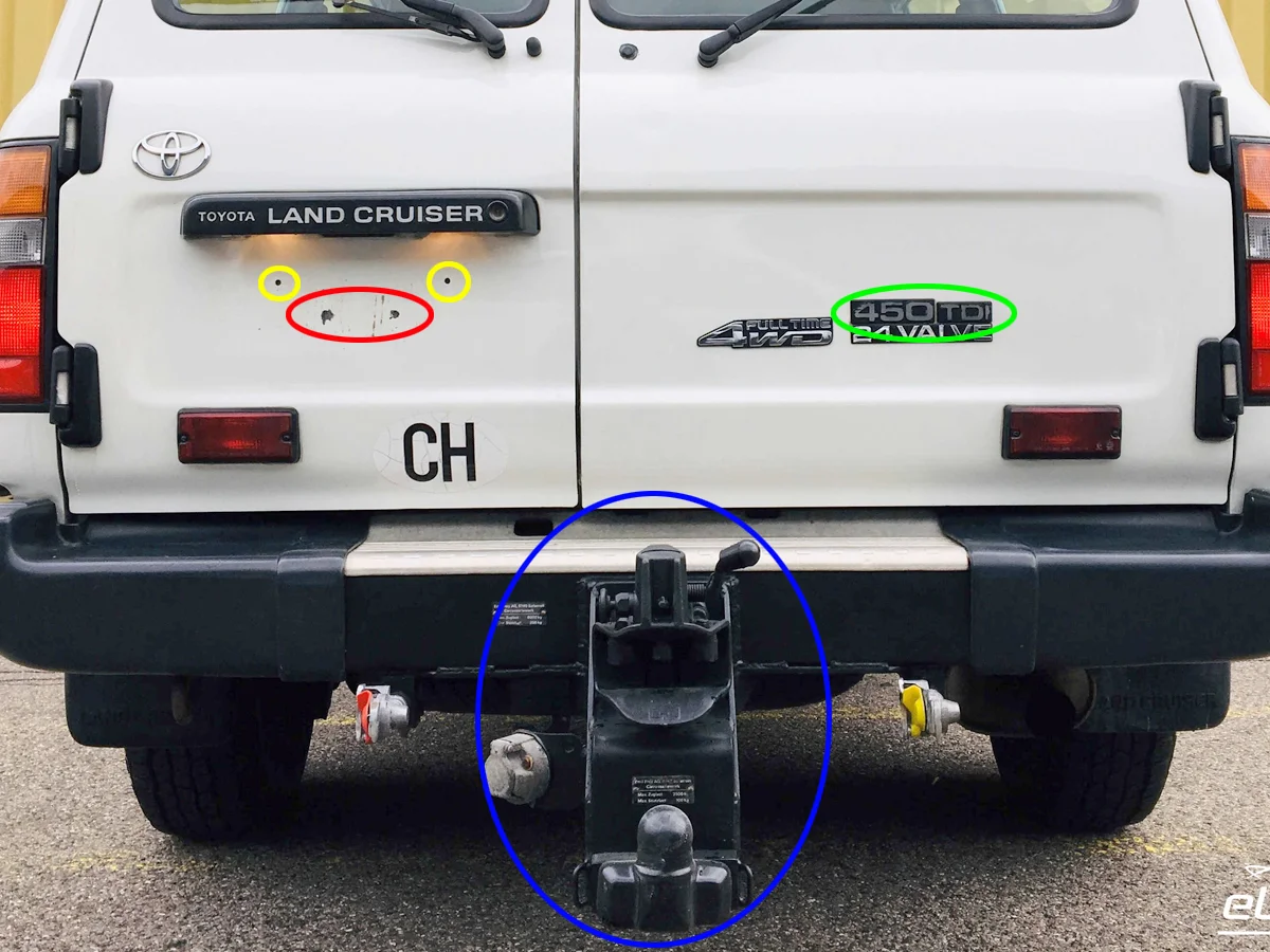

Finally had some time to get outside and do some cleanup and assessment today. First project was to remove the miserable cluster of a trailer coupling off the back. Besides it being ugly, I was concerned I'd whack my shins on it. The majority of it came off with just four bolts, so not too bad. The remainder is welded on, and will probably require the replacement of the rear frame member to put it right. That's for another day.
Here's how the tail end of the car looked when I got it:
Circled in blue is the hitch that's now gone.
Circled in green are the "450 tdi" badges that were apparently added by the Swiss distributor--I've never seen an 80-series marketed as a "450" anywhere else. It doesn't even make any sense. There's nothing 450 about the car. lol So I took them off.
Circled in red are some random-ass holes that a PO put in, probably to help hold the license plate on securely or something. Surprisingly bad engineering for a Swiss guy. I cleaned them up and put a small (M4) button head machine screw in each, sealed with silicon and backed with a nylock nut. Should be fine and it'll be behind the license plate anyway.
Circled in yellow are the license plate mounting holes that came from the factory. There are captured nuts behind, which is a nice touch, but a PO (probably the same guy that randomly drilled the other holes) used big sheet metal screws in them, rather than machine screws, and messed up the threads. They cleaned up OK with a tap.

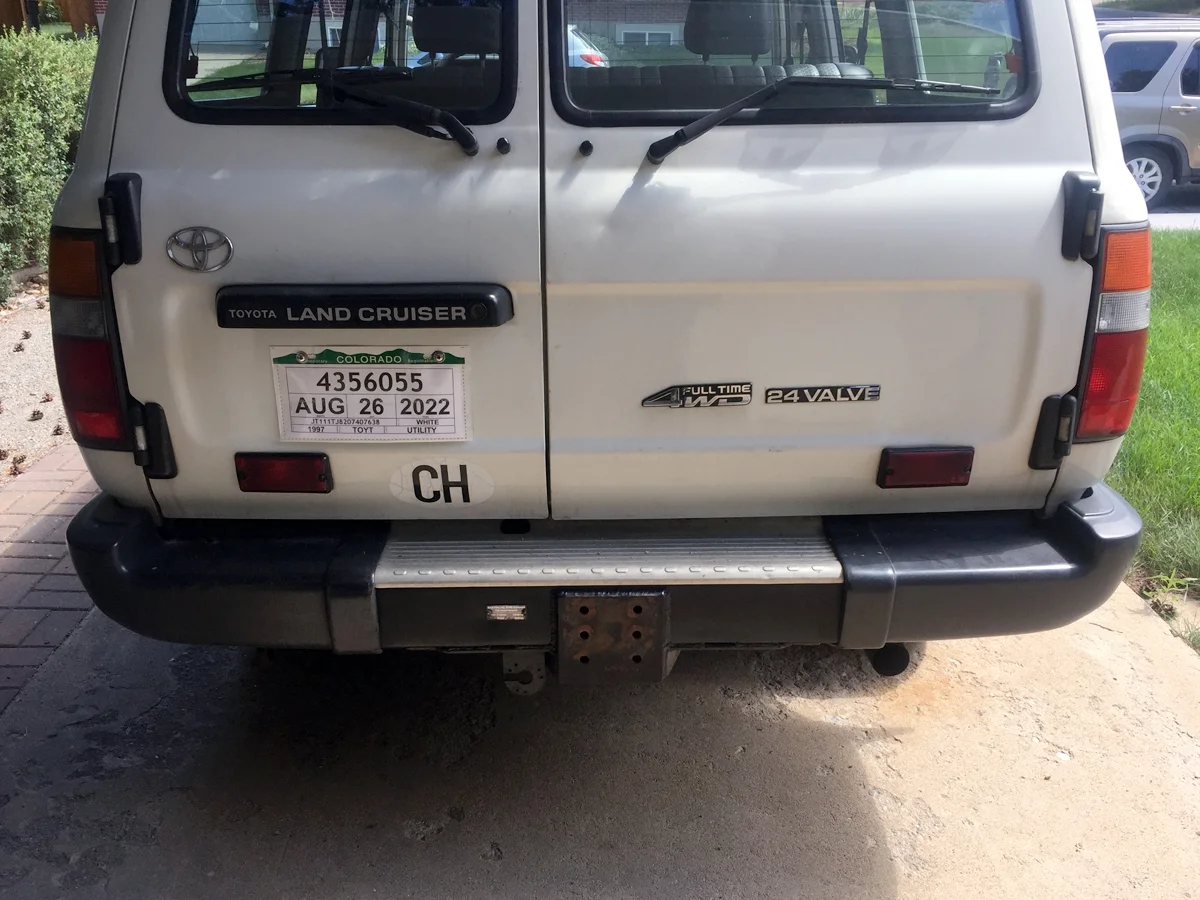

Here's how it looks now:

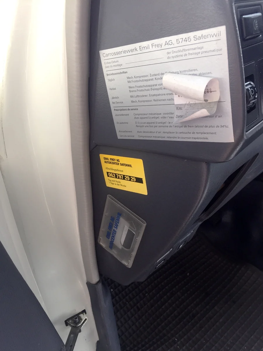

I also went around the car removing stickers. Europeans seem to love them. There were insurance stickers, shipping stickers, service stickers. They're all gone now. Here's a sample of Swiss handiwork:

And what it looks like now:

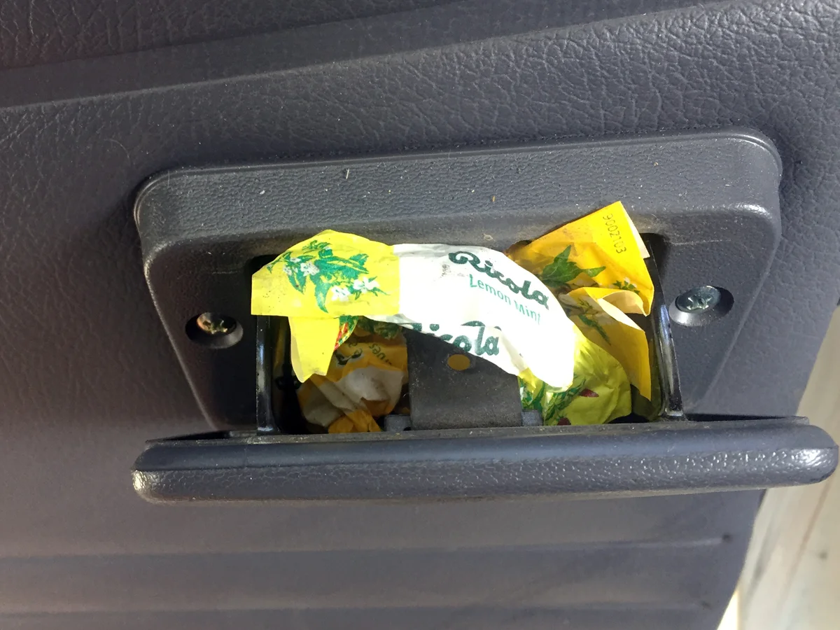

I would have left or relocated the clear little pouch, great place to store stuff especially if you get held up. They will get away with a few items but you'll still have a few other cards/ID.
I’m from Switzerland. Emil Frey AG is the sole importer of Toyotas into Switzerland and hence all the stickers with that name on them. I have the CH sticker on both by land cruisers. You going to keep it on the back? Gives the truck some provenance.
The CH sticker on the back is probably as old as the truck, so it would probably be difficult to remove anyway. I was planning on leaving it on there partly for that reason and partly for provenance, as you suggest.
BTW, I kept all the Emil Frey stickers, they're just not on the car anymore. I have all the service records and other documentation for this car in a file folder, and the Emil Frey stickers went in there.

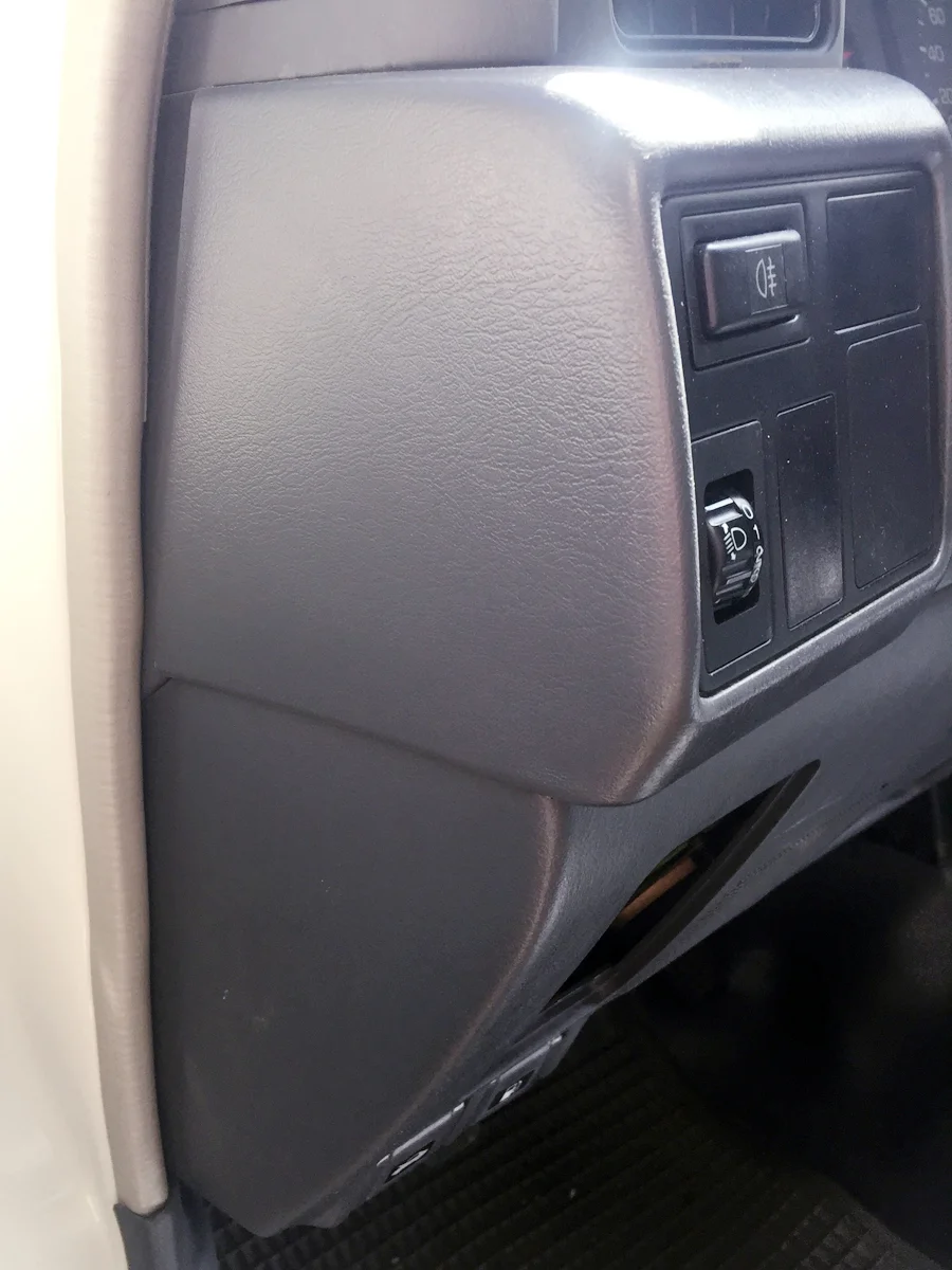

It translates from German as: "Headlight adjustment control switch"
and from French as: "Headlight beam level adjustment switch"
So, yeah, I guess it is. I haven't messed with it yet.
It is similar to the tundra then, based off load you can aim your headlights so you do not blind people.
