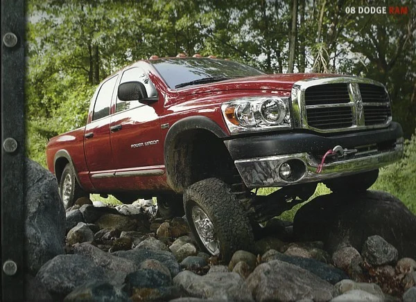

But it kinda makes the who comparison moot. A Ram Powerwagon with a 149" wheelbase getting a 655 RTI must absolutely destroy a 200 series in terms of actual wheel articulation.
2005-2009 Power wagon should be 140.5" wheelbase, and yes they are flex monsters. Dual solid axle helps a ton.
