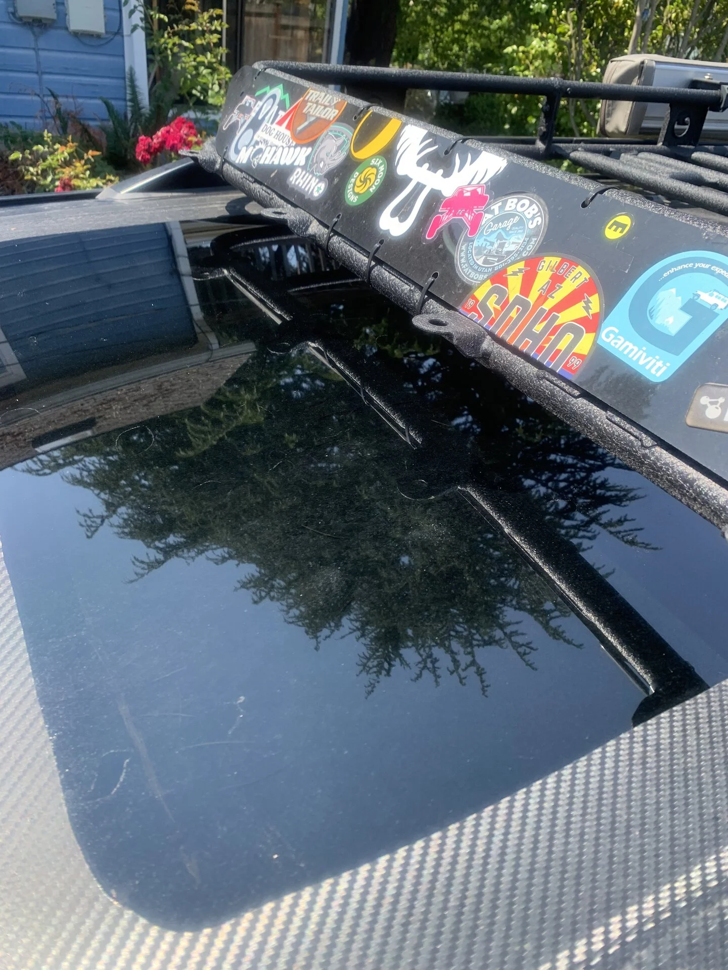

I mechanically fixed it by putting vinyl over the sunroof. That doesn’t address the cowl leak, or far more rare roof rack foot leaks.
My leak was a blockage, but then the cleaning tool poked a hole in the tube just after the sunroof connection. It’s in an incredibly hard to get to location, so I just blocked the rarely used sunroof. Moon roof is still an option.
