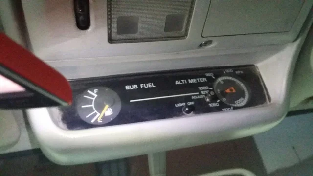

Hey everyone, recently acquired a 97 LC, the PO said the sub tank works, i read up on how to fill it up ( open the fuel lid, pull the knob up and fill), but whenever i tell the guy to fill it up, he says its already full and wont fill. the gauge next to the alt meter says empty (could be the fuse?, if so where would i find it?) but when i press the Sub T button, the small green light lights up for 2 seconds and then nothing happens..

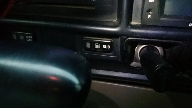

Show me a picture of your transfer button pls.
Here are the pics of the gauge, button and the tank

The Gauge:
Ok, thanks for the pics. I wonder if the PO installed this system completely OEM style if he used the ECU made by George on this board. Since you're in the middle east, you may have an OEM transfer system.
I'm not sure how the OEM subtank system works but I have the ECU made by George. If the sub tank is indeed empty, and I push the Sub T button, it'll only stay on for 2 seconds or less. This is because the Ecu thinks that the sub tank is empty and the transfer pump is NOT suppose to run dry and ruin itself.
So, what you need to investigate is whether or not the sub tank is indeed empty.
First and foremost, remove the plastic cover located in the driver side rear wheel well by removing three 10mm screws. You'll see the hoses that go from the filler neck to the two fuel tanks. Take a look at the filler hose that goes to the subtank to see if its kinked in any way. If it's kinked, then there is your problem.
If the hose isn't kinked then you need to find out if there is fuel inside the sub tank. You can try to siphon the petrol out of the subtank into couple of 5 gallon container to see how much petrol is in there. If only three gallons or so comes out, then your subtank is in fact empty.
If more than five gallons come out, then the subtank is NOT empty but your fuel level sending unit thinks that it is empty. At which point, further electrical troubleshooting of the sending unit is in order.

If the tank is indeed not empty, then given the gauge reads empty and the fuel transfer ends immediately, it's quite possible that the sender assy in the tank is faulty (maybe the float is no longer 'floating'). With the OEM subtank models there is an inspection panel in the rear floor (just like for the main tank) where you can pull the sender out to inspect it. Pull the carpet/vinyl mat in the rear up and see if an inspection plate is there (over the subtank area). That will give you easy access to the sender assy without having to drop the subtank.
