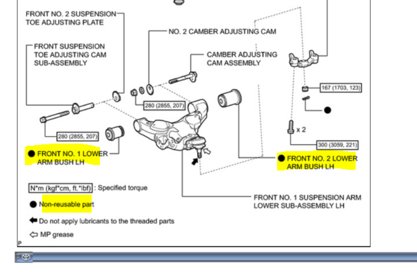

Also, the FSM shows the bushings as "non-reusable":
What would cause you to not reuse these? Surly they don't mean to replace these when you change struts/do alignment???

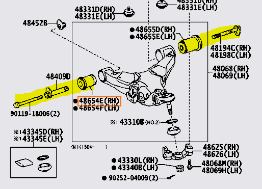

LCA bushing refresh looks like a bit of work. Not 100% sure this is for a 200 but it looks pretty close.

A whole new LCA with new bushings and ball joint is $300. I agree, I think I’d replace the whole thing rather than just the bushings.
