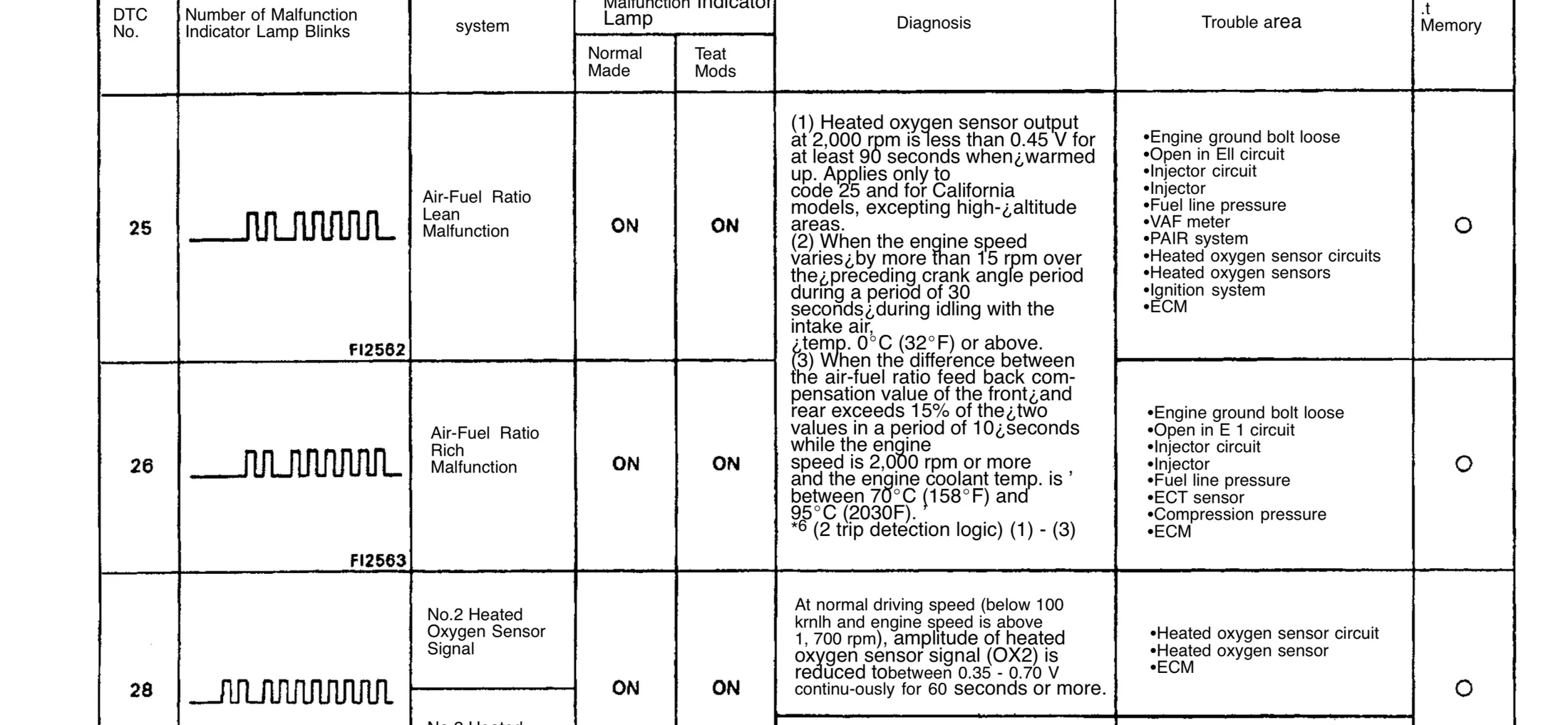

Only code that is showing is code 26, but I’ve had that code, intermittently for a while

I think the code 26 could be your issue

There are two temp sensors on the engine. One for the gauge, one for the ECM.
If the sensor for the ECM is having an issue, the ECM is not seeing the correct temp. During a cold start, the ECM places more fuel into the system and changes the voltage to the fuel pump and holds the injectors open slightly longer for a rich condition. This is open loop.
once the engine is up to operating temp, it goes into closed loop and it will change speed on the fuel pump and shorten the duration on the injectors to lean out the mix for a better air /fuel ratio.
If there is an issue with the temp sensor, it may be giving you too much fuel at the wrong time, causing a rich condition, and thus a code 26.

You don’t have a link for this temp sensor do you? I’m trying to look, and having trouble differentiating the two different sensors.

I think there are three, those two plus the AC high temp cutoff sensor.
Good visual here:
