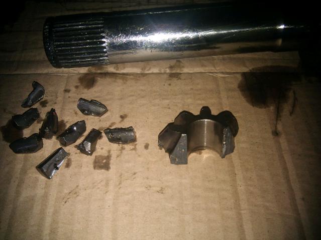

FJ60 with rear Air Locker troubles post-Rubicon. The Air Locker would not dis-engage, acted like a spool.
It had morphed into a spool of sorts . . . one of the "spider gears" had busted-off a tooth, which had fallen in between the gears and prevented the normal differential action, and dis-engagement of the Air Locker mechanism.

that's correct ..
when both hubs are locked .. like a Cruiser with the front diff locked .. :frown:
We got a winner!!!!

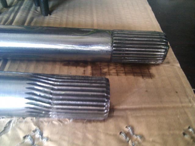

Have short side twisted inner splines sure they where holding all front axle traction.

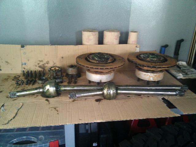

Still need to open the ARB to determinate the parts I need to order
Any write up on how to open the ARB?

Another question .. should I replace this twister spline inner .?
comments are appreciated ..
Chromo hub gears are not a bad Idea as if one bust and stripps the splines on the outside of the bif bobby wont warranty it. if you bust one of his chromo ones he will warranty them.
ABSOLUTELY replace the one with twisted splines, it is a time bomb waiting to go at this point.
