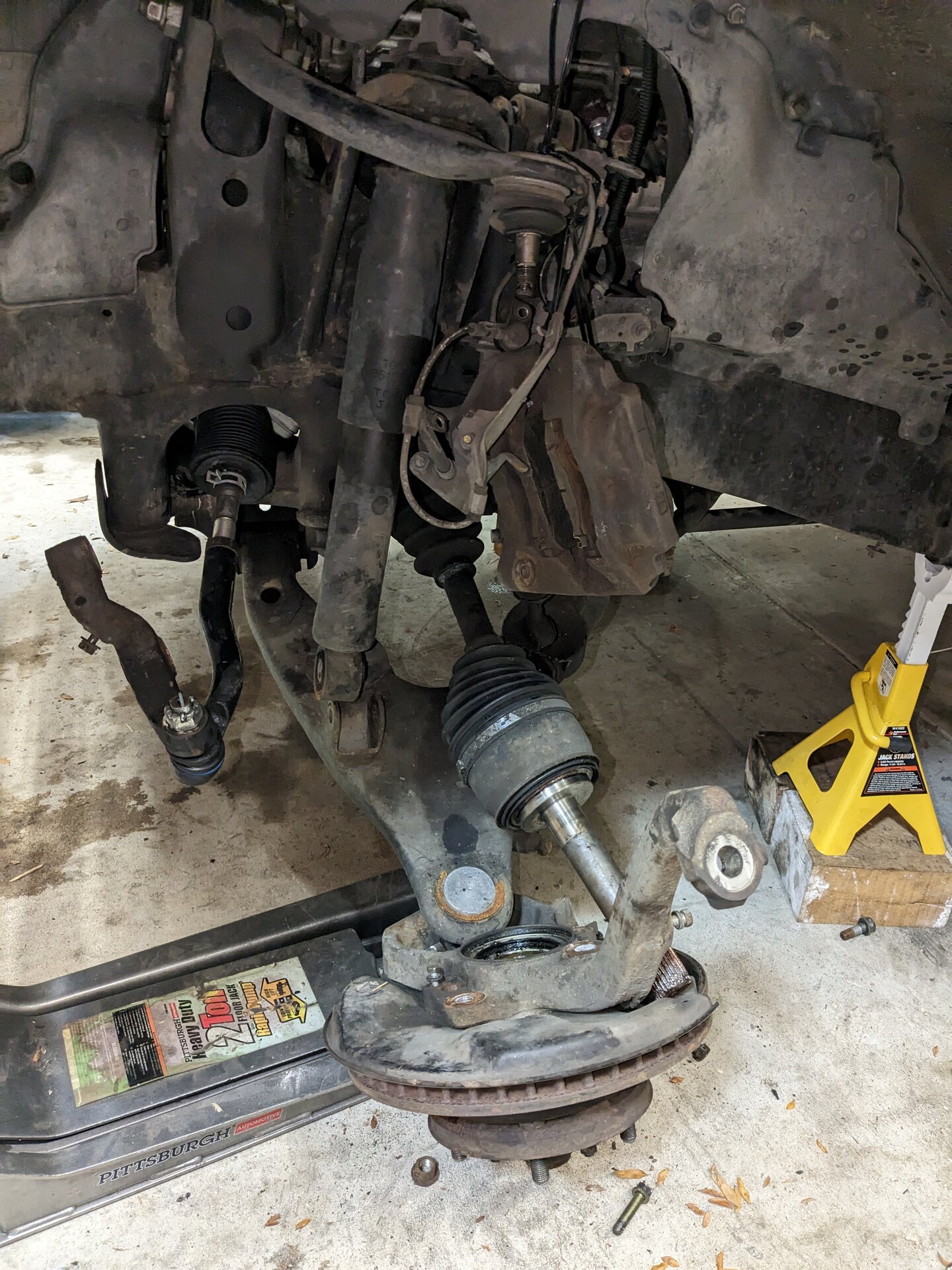

I started disassembly and noticed the bolts that hold the tie rod bracket to the knuckle have thread locker on them. Is it red or blue on reassembly?

What I've found on disassembly is that the wheel bearings are set up perfect. Zero play, backlash drag is dead on. Left CV axle is messed up. Loose, clanks when I move it by hand. The right side doesn't feel bad, but it has shed it's inner boot ring and is puking grease everywhere.
Additionally, the sway bar links are destroyed. The right one had no rubber remaining. The left one was so oil soaked it felt like it was made of foam. So, 🤞 what I think was happening is the right CV was probably overheating (I had only driven in 20-30 degree weather on the freeway previously) binding, and then the slop in the other one was causing the vibration. I hope.

After some delays I got it all back together with the GSC CV axles. All seems improved so far. Replacement was not the easiest job but there weren't any major hiccups. Still need a long freeway trip to verify but I think it's a success.
Well just did 150 miles on the freeway and some gravel as well and these new CV have cured the vibration. Front end feels fantastic. The sway bar links have also made a huge difference in cutting down slop up front. I'm feeling much better about this as a road trip rig now.
