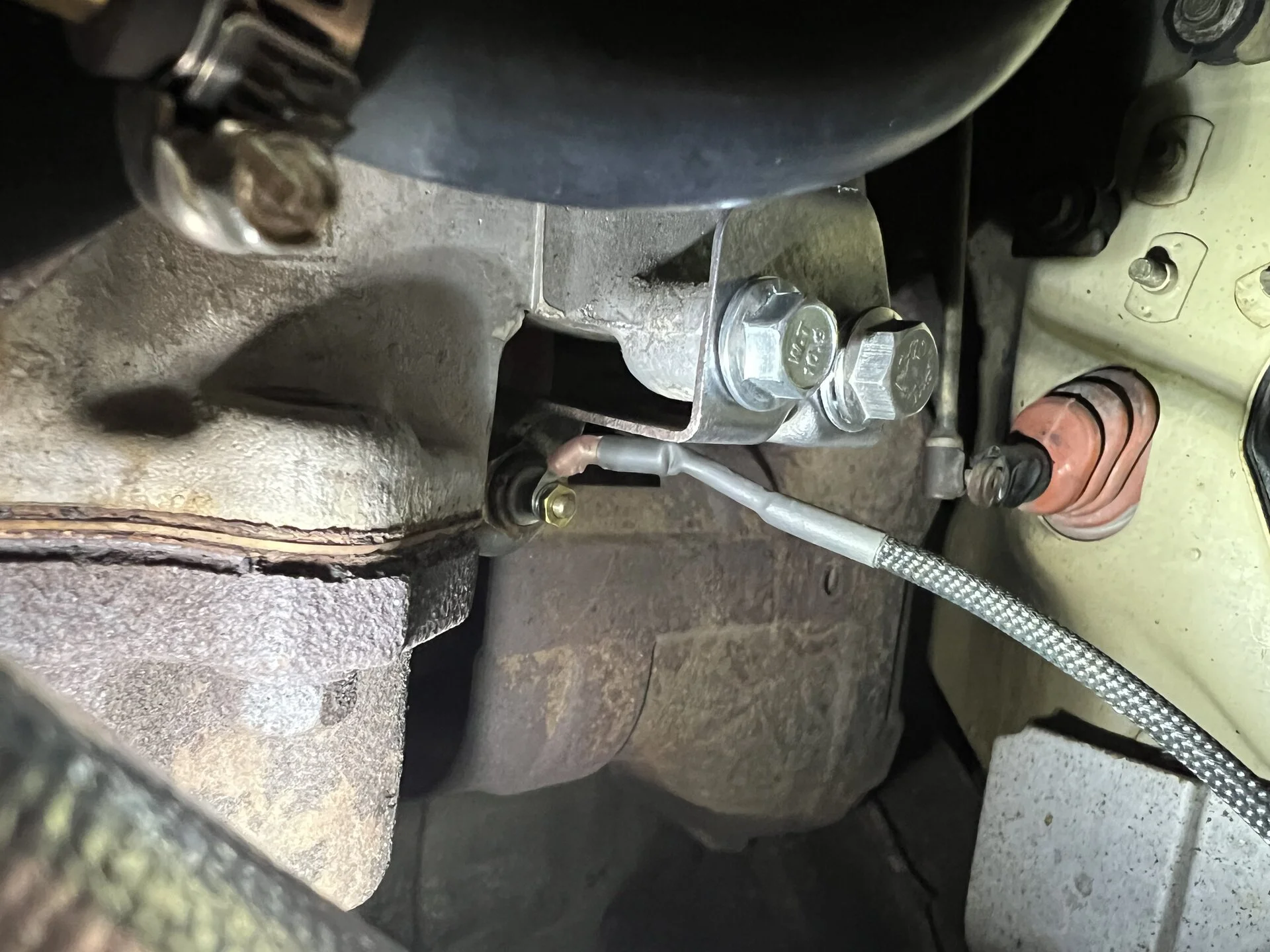

Strange carb cooling fan issue.
All snug and decided to go with the original sensor versus the other one they/ACC garage supplied me with. Maybe it’s best to leave it all OG lol.
…and have no idea why there is electrical tape covering my linkage just to the right….yet again, more hidden secretes left by the PO.
…,and verdict is in. Fan working normally and with no issues (after a 5 min run and no ground jumper) It is either the original bracket, placing the sensor further under the manifold or the sensor I was using with the 62 bracket was not efficient. I am Siding to a combination between the two, but I suspect the replaced sensor is weird. But who knows. Thank you all @Engineer8000 and @45Dougal qnd @mattressking for all your input. I will also be adding some fire braid to the hard fuel
Like across the valve cover for added cooling going forward.
