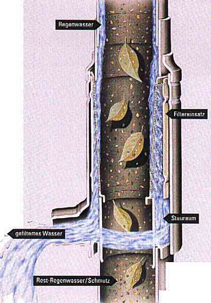

To catch the water from the downspout i did mount a raincatcher in that downpipe. Over here in germany they are called regensammler.
You put that level with the max. height of your containers so they dont overflood.
