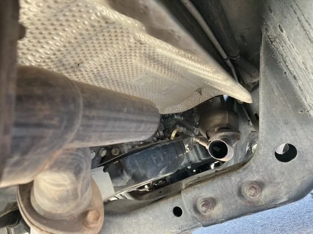

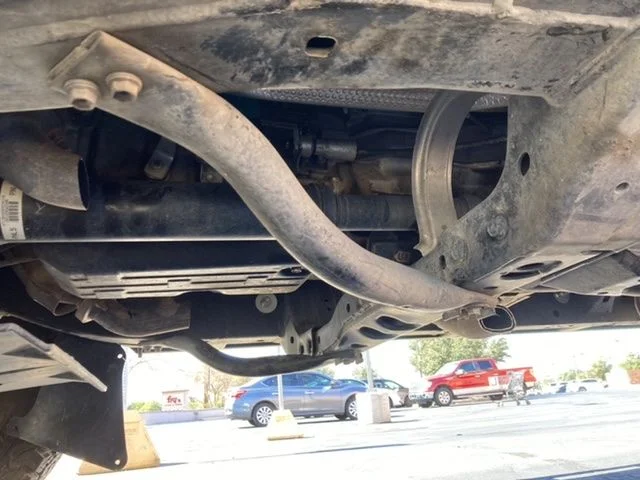

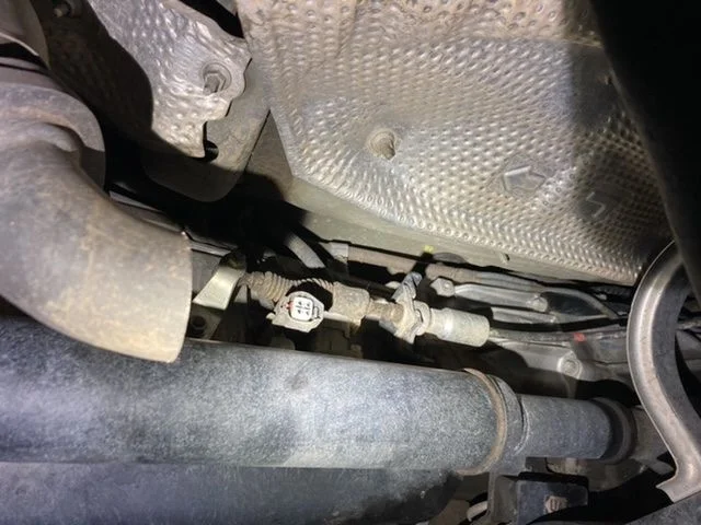

Hey everyone, I have had an interesting week. I found out that my our v8's sound like absolute monsters with a straight pipe exhaust... but I found this out the hard way by having my catalytic converters sawzall'ed out. At least, that is what I think they are. I just got the vehicle back from the dealership and these are the parts that they said are missing/damaged. The main question that I have are these...
  1. Is a "pipe assembly, exhaust" the catalytic converter?
    1. Part number 17450-50450 & 17450-50121
  2. What are my options while maintaining reliability and the ability to pass emissions?
  3. Is there anything outside of the obvious that I should look for that they could have damaged?
I have tried searching and haven't found any threads specifically describing this and with the high price of precious metals right now, I doubt I'm the only one who will have this issue. For context, I live in AZ and have comprehensive insurance through USAA. The price quoted to me by the dealership was $4155 for parts and $210 for labor so it must be 4 bolts basically I guess 🤣. I'm currently thinking of pocketing the money from insurance with a quote from lexus and finding a solution that will pass emissions and not sound like a hotrod.
Total parts list:
  • 17410-50450 Pipe Assy, Exhaust
  • 17450-50121 Pipe Assy, Exhaust
  • 89467-71020 Sensor, Oxygen (x2)
  • 89465-35690 Sensor, Air Fuel (x2)
  • 17451-74051 Gasket, Exhaust P
  • 90080-43036 Gasket, Exhaust P (x2)
  • 90917-A6005 Gasket, Exhaust P
Time to pour myself a stiff drink and figure out my options...
Thank you all for any help you could offer and I hope others find this useful as well. I'll post some pictures in a reply of the carnage.

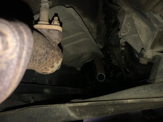

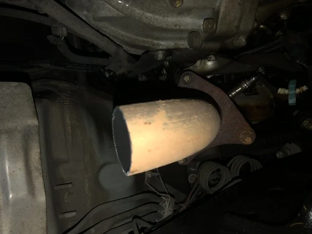

Thank you all for your help @Rednexus, @HomersCanyonero and @Acrad. After crawling around underneath and comparing it to the parts catalog, I think that I got lucky. You are completely right @HomersCanyonero, they are behind 02 sensors, so I should be able to pass emissions just fine regardless of what I install. Below is the parts diagram with red lines 'drawn' on where they made all their cuts. It will be remarkably expensive to replace with OEM at the dealership, but I may be able to get a nice check from insurance and then fix it nicely myself. It seems like it is essentially 8 bolts, 2 isolators, 2 o2 sensors and 4 gaskets. Thankfully they didn't appear to have damaged the 02 sensor plug so I think I'll be able to plug and play on that.

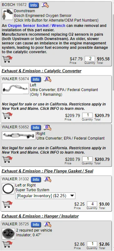

Does anyone have experience with Walker? It looks like I can get a complete bolt up solution on Rockauto for ~650.
Alternatively, I can get some welded up, but I need at least one 02 port included as well.
Will this make a noticeable difference in the exhaust tone? I think the exhaust tone is mostly accomplished in the muffler and exhaust pipe, but I have no experience with these systems. Ideally I'd keep it close to stock and have it pass first inspection as stock in the future when/if I ever sell it.
On a positive note, I think this will make a great excuse to the wife to invest in a full skid set from RCI as they will will mostly stop this from happening again :)
intact O2 port?
Cut isolator
Edit: added photos from mobile
Walker mufflers have a reputation for rusting out, though maybe that's not as big of a deal on AZ. I'm not sure on their cats.
Here is a link to the Mangalows. You need both sides which are around $900. They include O2 sensor bungs and are also mandrel-bent stainless steel (perhaps a bit more free-flowing than stock).
For the sensors I would recommend Denso instead of Bosch, because Denso made the OEM sensors (Bosch stuff is OK for domestic cars but I prefer OEM sensors for Japanese stuff).

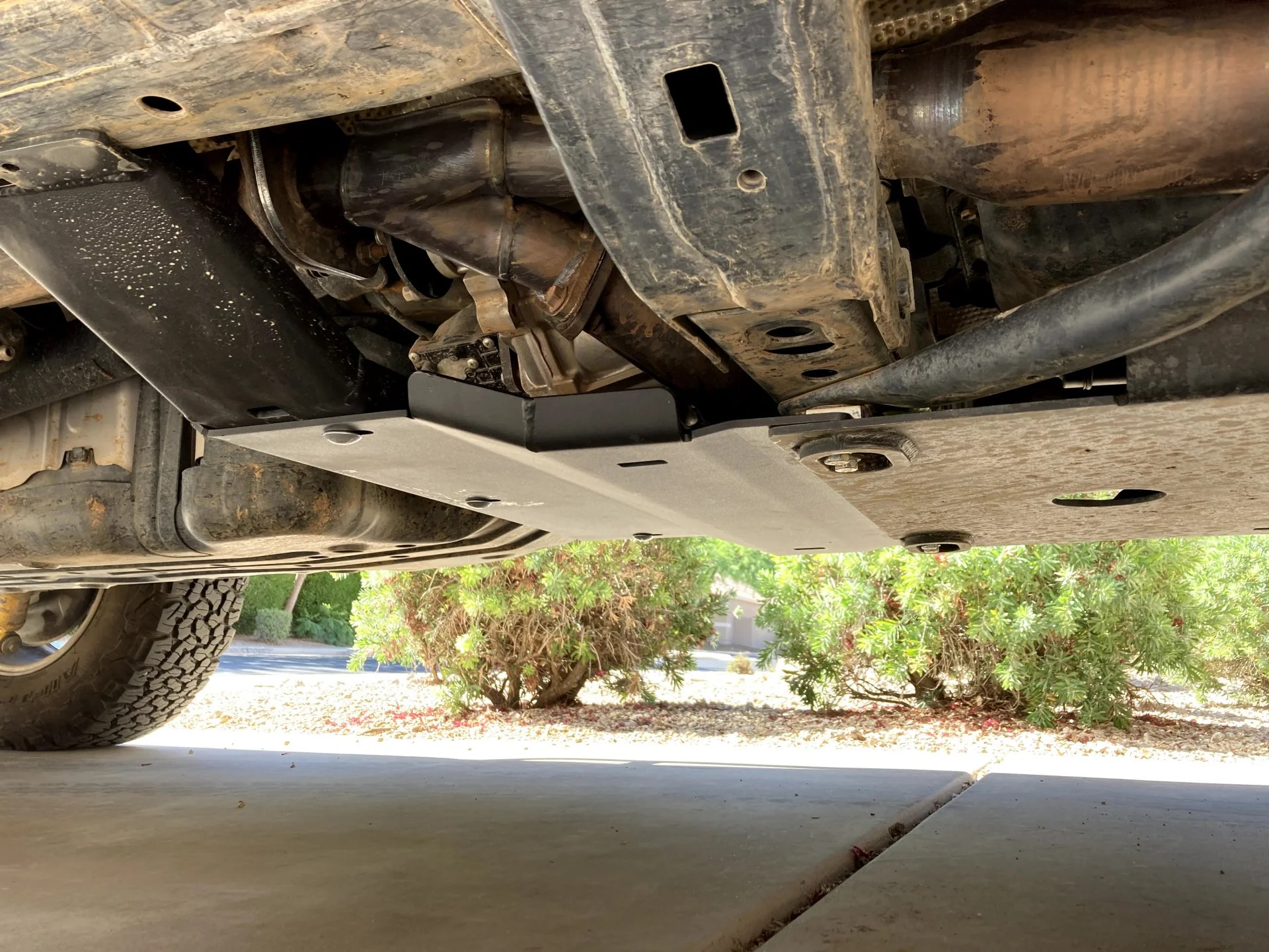

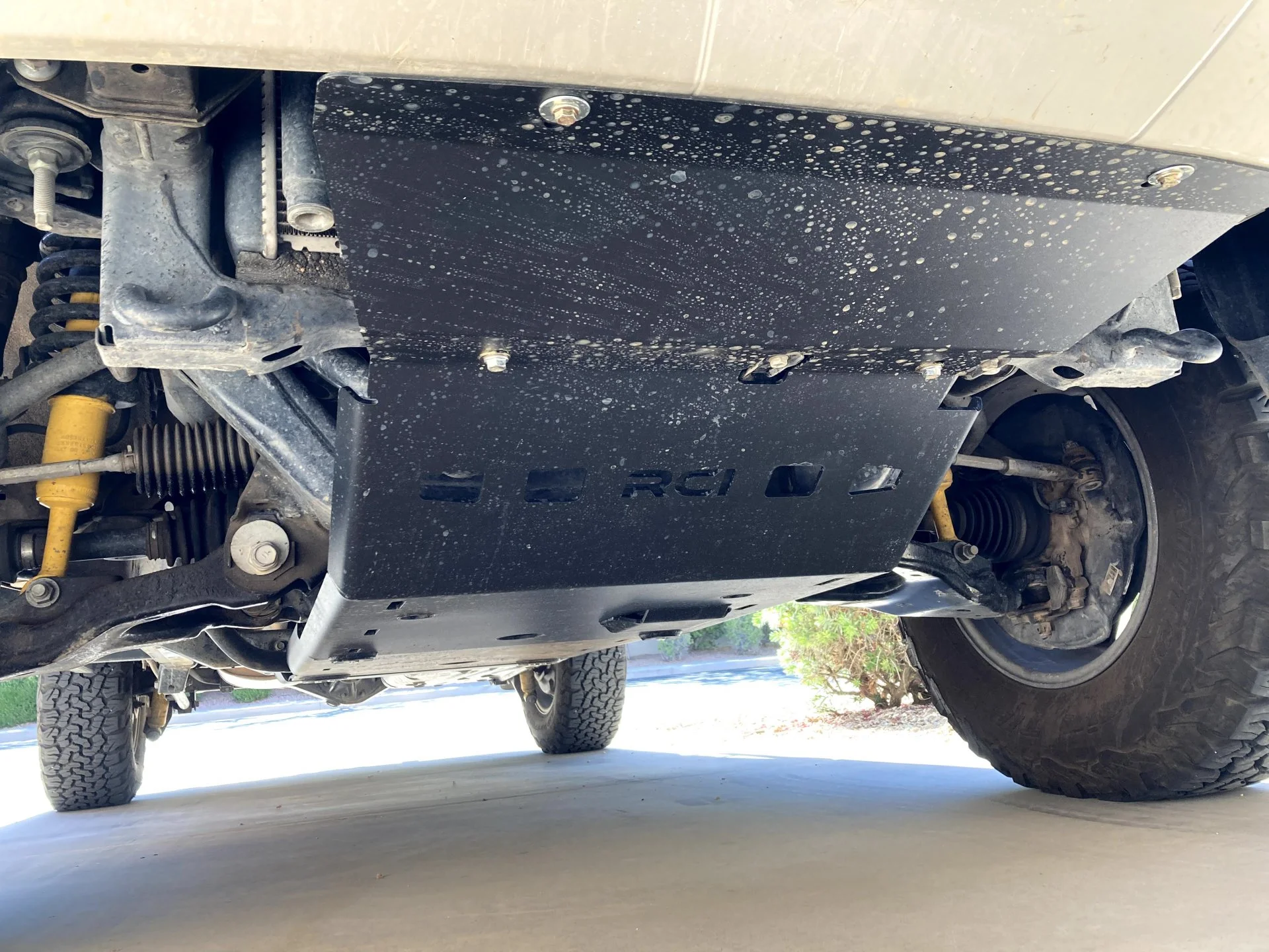

I owe everyone here an update, thank you all for your help during this crazy time. In mid-late February I got the appraisal from USAA (entirely conducted over the phone!) and they covered everything, no questions asked. I decided to do the following with the nice check from insurance.
  • Requested indy mechanic fix the cats/02 sensor (Late Feb)
    • They replaced the two rear catalytic converters with Magnaflow cats, so far they have been great. I wasn't concerned with OEM since there are no sensors behind them.
    • They replaced the drivers side rear stolen 02 sensor with a Denso O2 sensor
  • Ordered a full set of skids from RCI
    • Engine skid, transmission skid, transfer case skid, bumper filler plate (all 3/16" steel with black powdercoat)
    • Install went smoothly

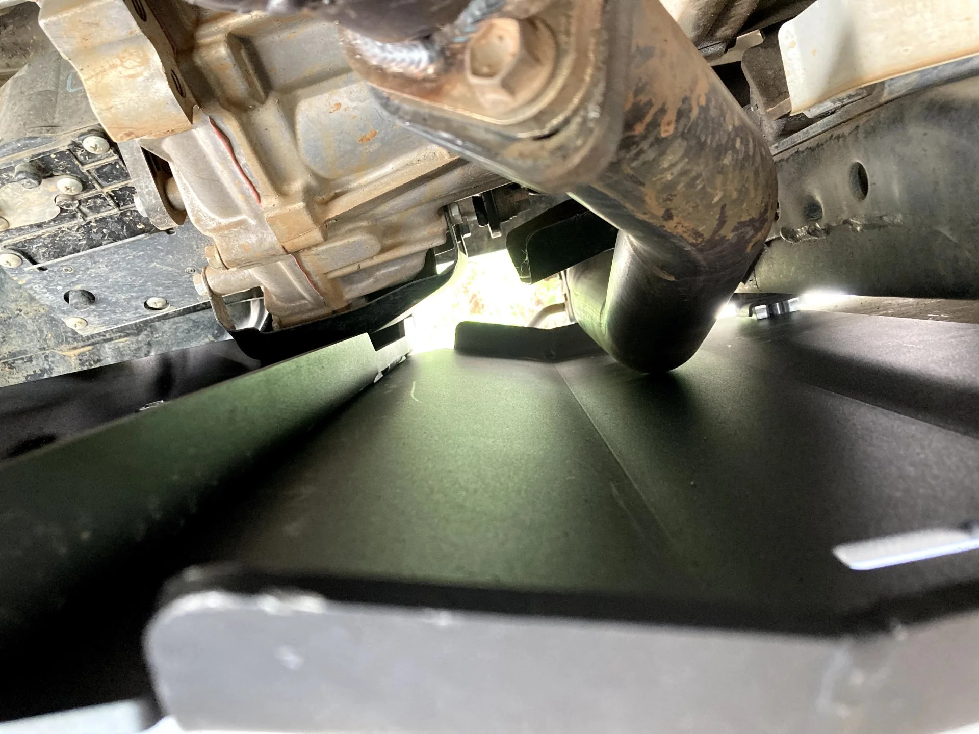

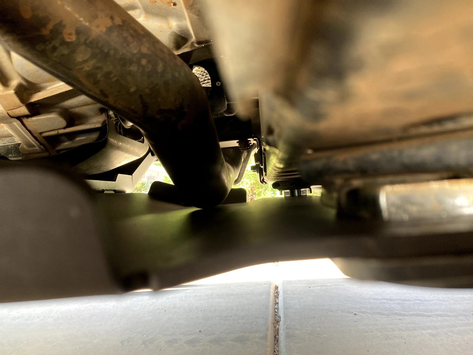

    • Only issue that may pop up is I may need longer bolts and several spacers to clear the Y-pipe crossover, it is currently contacting the transfer case skid (photo below)

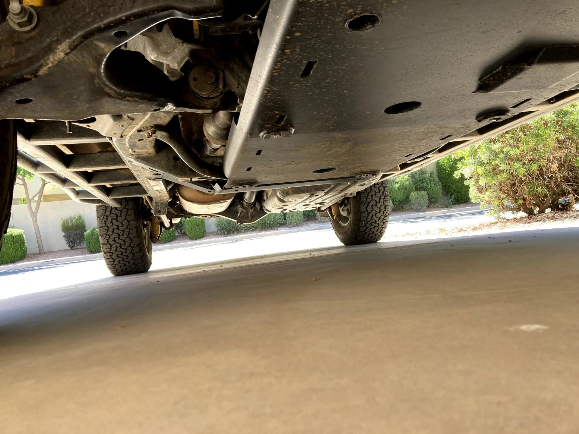

By my estimation, the skids have closed up 3/4 of the cut points that the grifters used. For the 1 cut that they could still easily make, it is now a much tighter access point.
So in my book, the skid install serves a great second purpose. I was planning on bashing the existing skids and then replacing, but the insurance money helped that happen sooner and also will deter the catalytic theft in the future. I don't think it will prevent if someone has time and is determined, but it will deter.

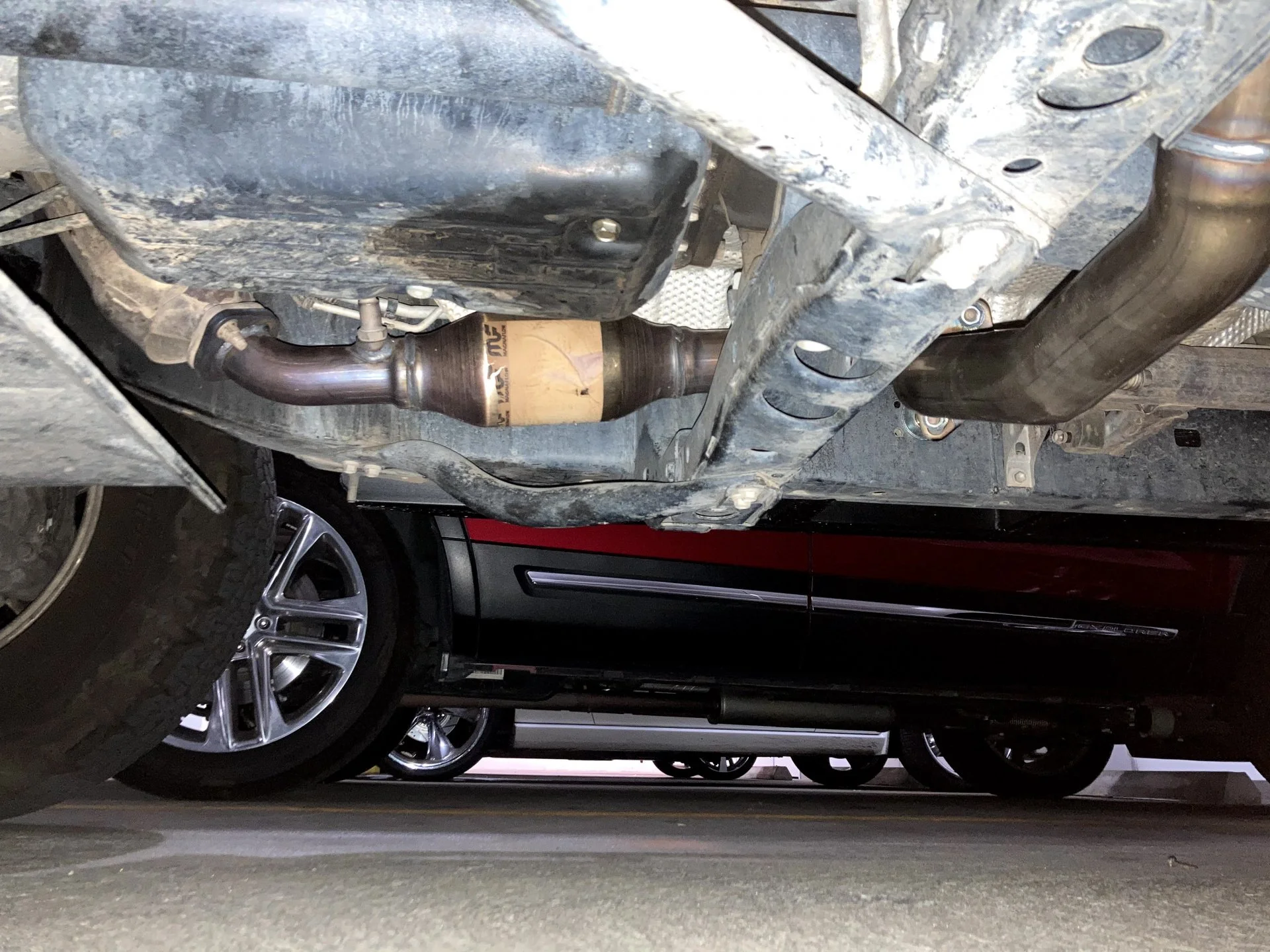

New Catalytic Converters with paper prior to "burn-off"
New skids installed
Cat pipe contacting the transfer case

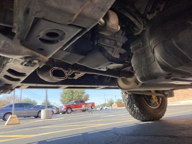

Our drivers side cat was cut out Monday night. Some POS.
Also have a Gen3 4Runner that is even easier to get under than the LC. Need to weld a cat plate in the 4Runner tomorrow.
