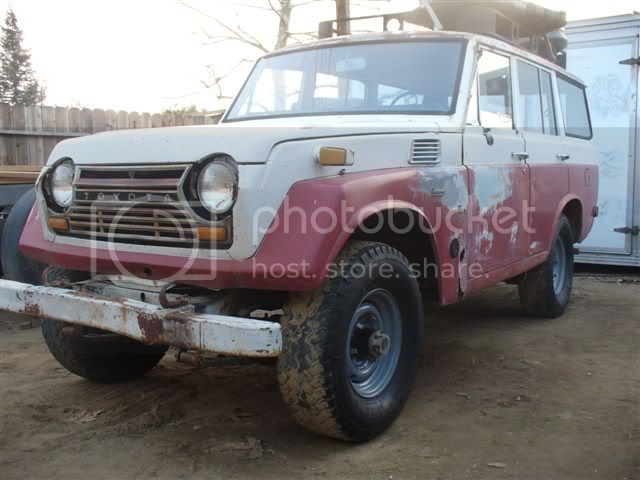

Do all Toyota wheels feature the clips to hold on the hub caps or are the later 78 and 79 wheels for disc brake pigs different? The reason I ask is that the wheels on my 78 pig appear to be the same color as Ige's but lack the clips like the grey factory wheels to hold on hubcaps and I want to run hubcaps also.
eperry0303, Yes the local dealer can order them for you or CDAN if you don't have a local dealer who discounts, but shipping would probably kill that deal.
Are my wheels stock 78 Toyota wheels or aftermarket? I can't find and TEQ or Toyota markings anywhere on them.

They may also be mini pickup wheels which look almost identical if they are not cruiser rims with no clips. I had those on the rear of my cruiser that fit the drums but they didn't fit the cruiser discs.
What is the BS on those john?
Would there be a certain mark distinguishing the drum brake rims from the disc brake rims without having to mount them to see if they fit?
Yes!! Drum brake wheel have rivets on the back side that hit the caliper, disc wheels have no rivets at all (all welded).

Chevy wheels also fit the 'Cruiser so wheels without clips could be Chevy wheels too.
drums have rivets on the backside holding the center to the outer rim, where disc rims are welded, also, it's very difficult to see, but the rounded portion (where the clips are) is kind of "flattened" on disc rims...much more rounded on drums.
