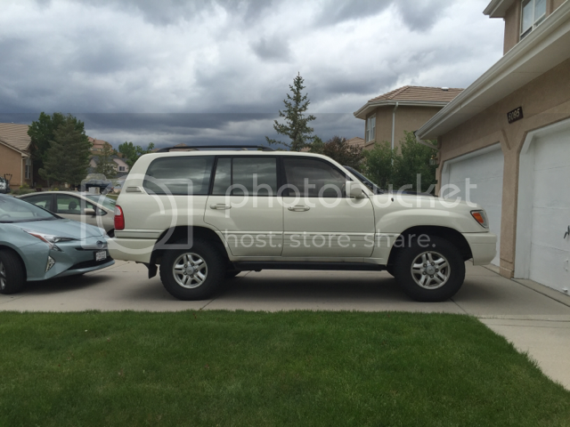

Has anyone lifted their 100 2.5 inches and left the stock tires on? I plan on buying the lift kit soon, but the tires will be coming later on down the road because the truck has brand new tires on it now.
If you have lifted and left the stock tires on and have a pic. Please share!

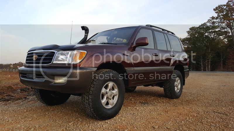

Here's mine at the tire store with lift and stock tires ( 275/70/16)

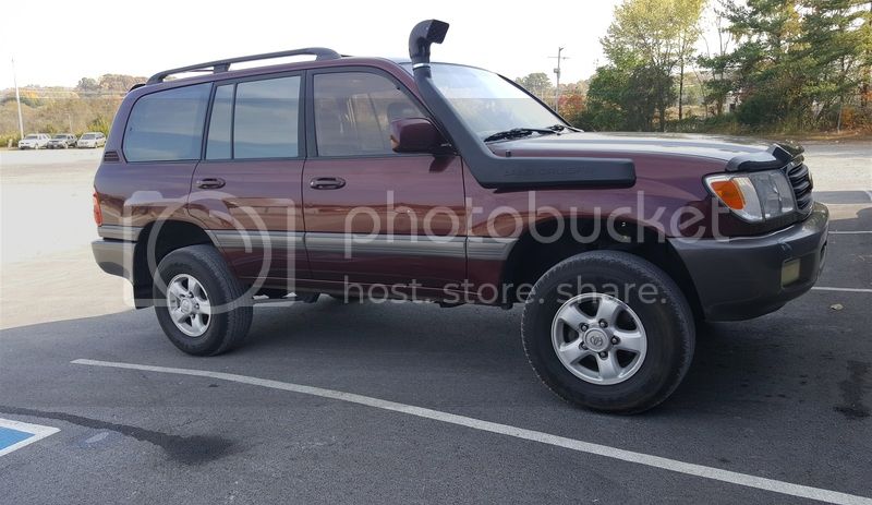

Here's after with 295's
