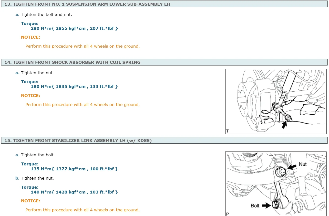

I noticed that too when we first bought our 200. Unfortunately I ruined it when I had the factory coil spacers installed. Now it bounces all over the place on washboard dirt roads and even bumpy paved roads.

I’m not sure. It was done at a Toyota dealer although they have never installed them before. The ride difference is so different that after spending $500 for the install, I’m contemplating having them removed for the great ride comfort we had before.
Something isn’t right. If the install is accurate, your alignment might be significantly off.

Not likely the spacer as it has no impact on preload or spring rate.
What did likely happen is that they didn't torque the suspension points per the factory service manual procedure. Specifically, the major pivot points of the suspension articulate on rubber bushings. These bushings are bonded to the inner and outer casings, and flex and deform, rather than slide for the suspension to articulate. It's important that when they tighten the bushings down, that the full weight of the vehicle is on them, so that the rubber bushings rest in a neutral state at ride height. What they likely did is torque the suspension while it was in full droop on the hoist. Essentially adding a ton of pre-load to the bushings (and suspension) such that it doesn't articulate nor dampen suspension movements properly anymore.
I would go back to the dealership, give them an earful, and ask for the suspension points to be loosened and re-tightened on the alignment rack. Then fully re-aligned. If it's been some time, be aware that this may prematurely wear the suspension bushings.
This is just a snippet of the FSM. Note the text in orange.

Thank you for this. The truck is actually at the same dealer for a radiator replacement so I’ll mention this to the mechanic.

I did. I asked them to see if the master mechanic originally performed the procedure per the factory service manual and instead of saying yes or no, they told me they loosened everything and re-torqued everything per manual yesterday while it was still in the shop. I only drove it home from the dealer so I can’t say I notice a difference. I’ll know for sure this weekend when I get it on some fire roads.
