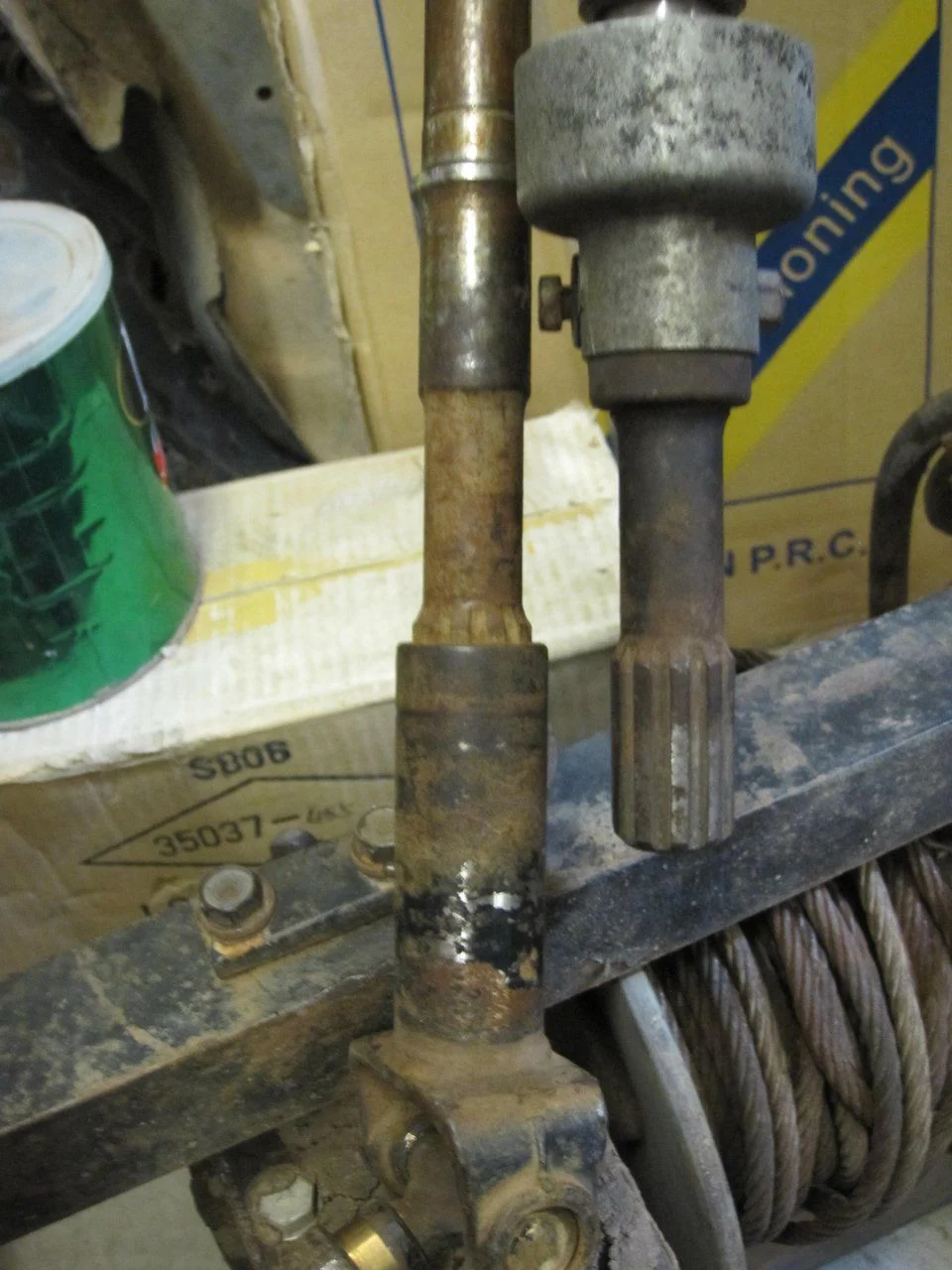

Here are few pictures of the welds a PO used instead of a shear pin. Need to get the U joint apart to get a Dremel grind out the weld to save the end of the shaft and collar.
Rust splines why the PO destroyed the pillow block to get out. One to the right gives a idea of how the shaft is in the collar. With the U joint apart could probably use a brass punch to break away.

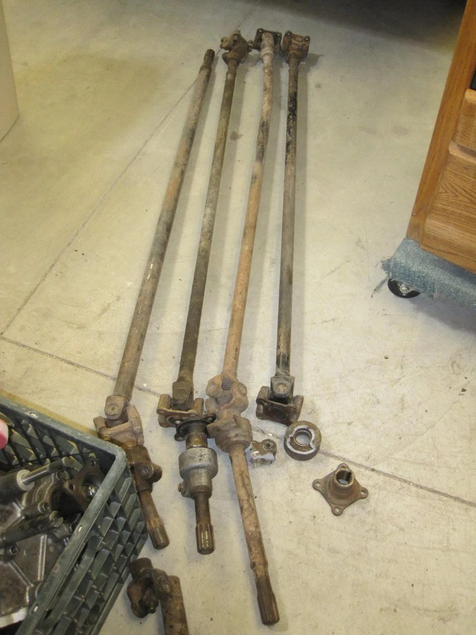

Pictures of shafts including one from the 77 FJ55 which is real close to the 81/82 FJ40 design. Never noticed it only has U joint in the middle and no flange. The housing on the pillow block is steel not aluminum. Broken aluminum pillow block is also the picture.

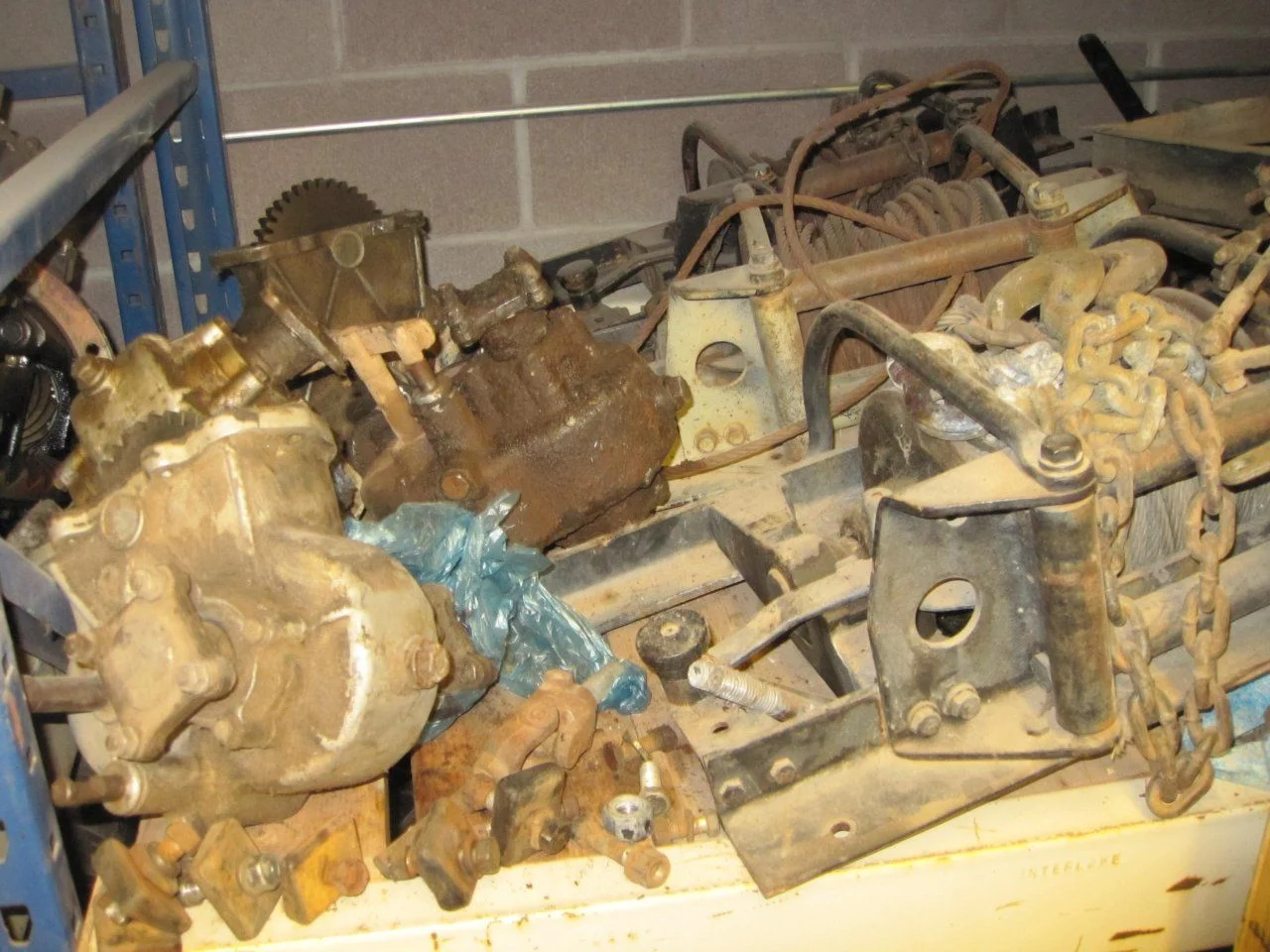

Some of my PTOs and winches Need to organize my shelves. Would be easier to do if the A/C in the boxes in front of were out of the way and cooling the garage instead.:rolleyes:
Noticed a lot of pto winch parts in your pictures. Looking for thr fron rad bracket mounted pillow block and shaft assembly. Do you have anything available?

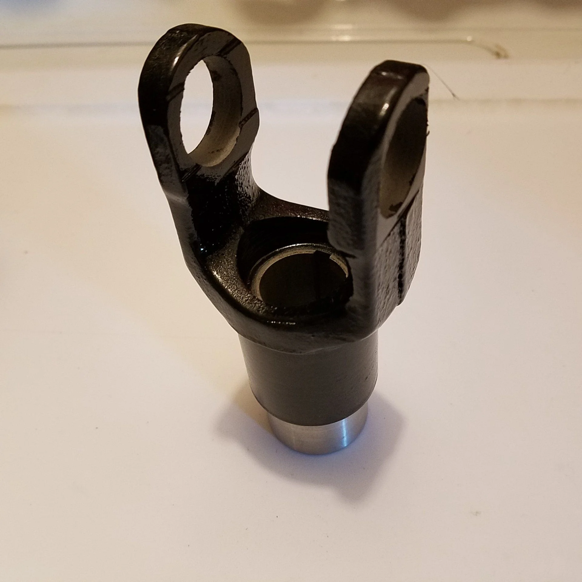

Modified 1000 series for bj60 pto.
Yoke was shortened, reamed to fit pto shaft, turned down and fitted with a 35mm sleeve for seal surface. I will be using 1000 series part for the rest of the driveline.

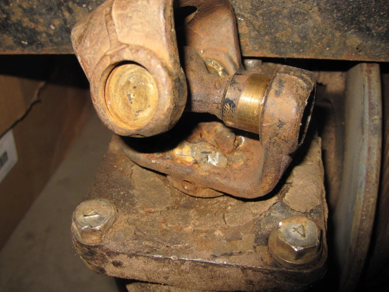

When it comes to the winch end of the shaft you want to try and get the shaft as straight dead on to the winch as you can get it, when the shaft attaches to the winch on an angle they tend to increase the rate that the coupling flogs out on the shaft with the continual lateral movement and force, when the coupling flogs out and becomes loose it puts more stress and load on the shear pin
Having said to modify as little as possible if you can use a different coupling onto the winch it'll save you a lot of headaches with broken shear pins, the Toyota couplings use a 4mm shear pin which is significantly under rated for the winch load capability and fails easily, unfortunately the coupling doesn't have enough meat left to drill it out any larger, some people have successfully managed to weld collars onto the end of the coupling so they can drill them out to a larger shear pin or sometimes use a spare yoke from a PTO shaft and machine the centre out to fit the winch shaft and drill that out for a larger shear pin, my Nissan winch uses a 8mm shear pin as opposed to Toyotas 4mm, my winch uses an identical wormgear and bronze wheel as Toyota use they are so similar that I'm pretty sure you could probably get away with swapping them over between winches so you could say both winches are basically identical strength. I've only ever broken one 8mm shear pin when I first got the truck 5 years ago and it gets put through a number of our local winch comps and tough truck comps out here without destroying the winch, you do get to read the winch and can feel and hear the loading and treat the winch accordingly when its working and working hard
