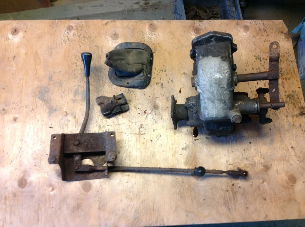

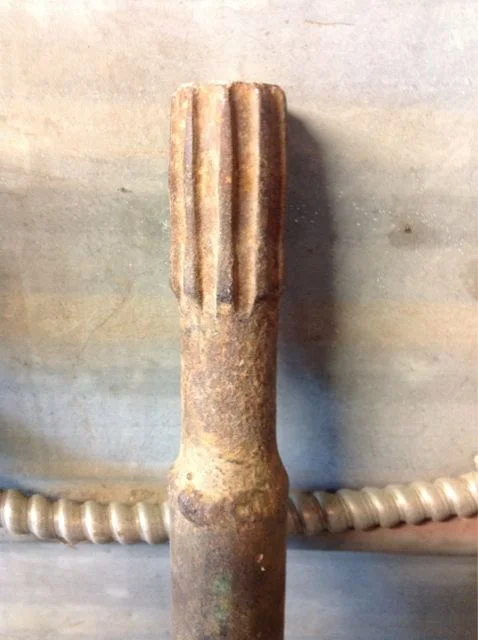

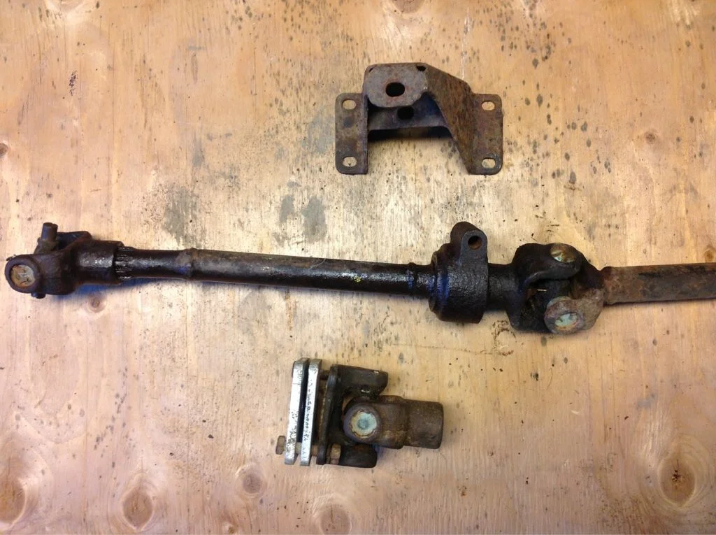

Here are the mesurements and photo out of my 1980 bj40.
Picture first.
On the pictures, you will see it as is and jammed. I tryied making mesures that are useful, let me know if you need more.
Front shaft is 40 cm long from yoke to yoke center.
It is 35 to 22.3 mm in diameter.
Bearing is 41 mm x 79mm and bolts to a 49.7 mm bracket.
At splines it is 26-27 mm in diameter. There are 10 splines.
Flanges are about 5.5 cm long each and 75 mm wide.
The bearing bracket sits 42mm from the frame and goes to 10cm max.
Back shaft is 112.5 cm long from yoke to spline end (end of shaft).
Splines are about 4.5 cm long.
The yokes are 10.8 mm in diameter and 61.6 mm wide.
The linkage 43 cm, the last 5 cm is the adjustable end link.
The handle is 30 cm.
The linkage bracket is attached to the body at an angle.
The pto box flange is 52mm center to center bolts.
Let me know if you need more.
Jean-Marc
Very very cool, this is a big help for me. You have a forward and reverse gear box that is nice. The linkage is a real help also in seeing the set up.
I believe I can reproduce the bearing hanger from that picture with a few mods. Would it be possible to ask for some pictures of the linkage at different angles so I can start on that parts as it looks to be a good place to start. I have some steel rods so I will use your pictures as reference for the rest.

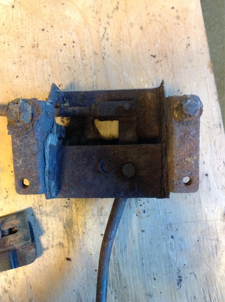

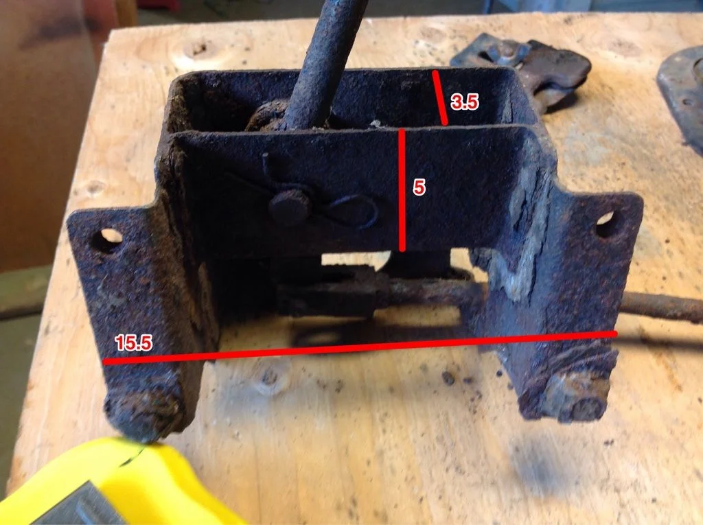

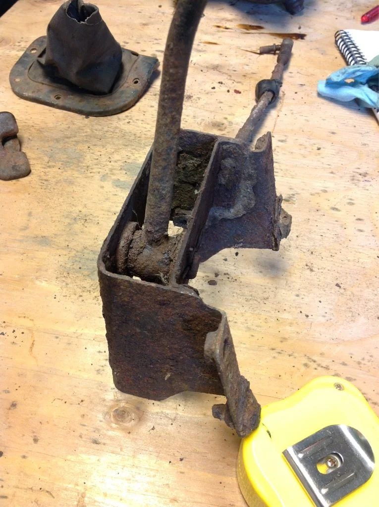

As for the pictures of the linkage assembly, here it is.
I hope that is what you need.

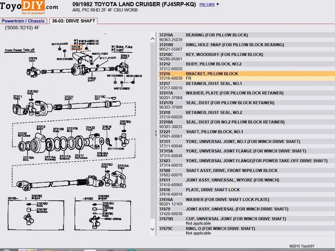

There was the cable you need for the shifter in the Mud classifies. I'm using mine on 79 FJ40 and 65 FJ45 so will use the 83 and later style since neither is correct and I like the later style better. You got better measurements of the then I could provide. 83+ has a extra pillow block. My 82 frame only has the mounting hole for the front pillow block which is the same as the information I've found on line.

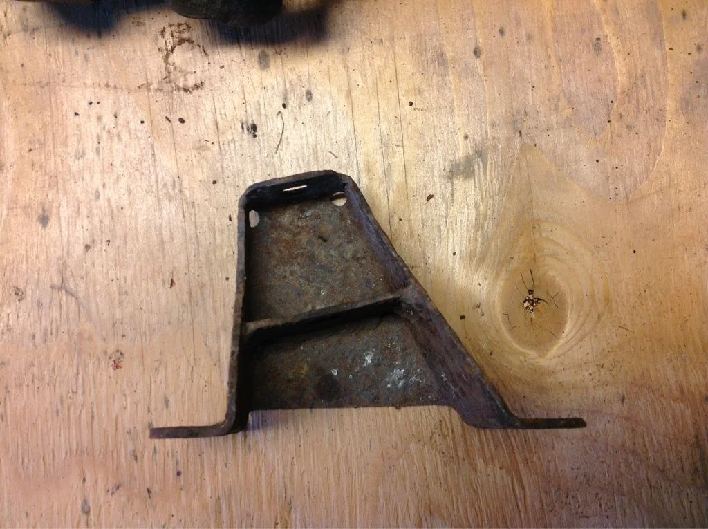

jmphilion super job on that bracket measurements, I believe I can build that with what you have given us. Yours looks to be a little on the weathered side but with some cleaning and sealing it will work for many years.

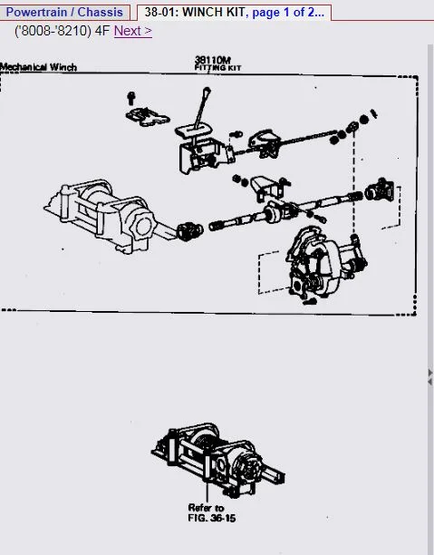

Living in the Past I was just looking at the parts diagram on the linkage and the cable system, if possible I am going to go direct shaft linkage
to the system. Also the diagram show the one pillow block for the 82 model so that is a plus seeing what imphilion has posted in his picture. I have a nice photo of your linkage you posted also to use as a template.

jmphilion, I am now starting construction on the shifter lever box like the one you show in the pictures, can you tell me just were was this box was mounted on the truck and how. Diagram is a bit vague.
Thanks.

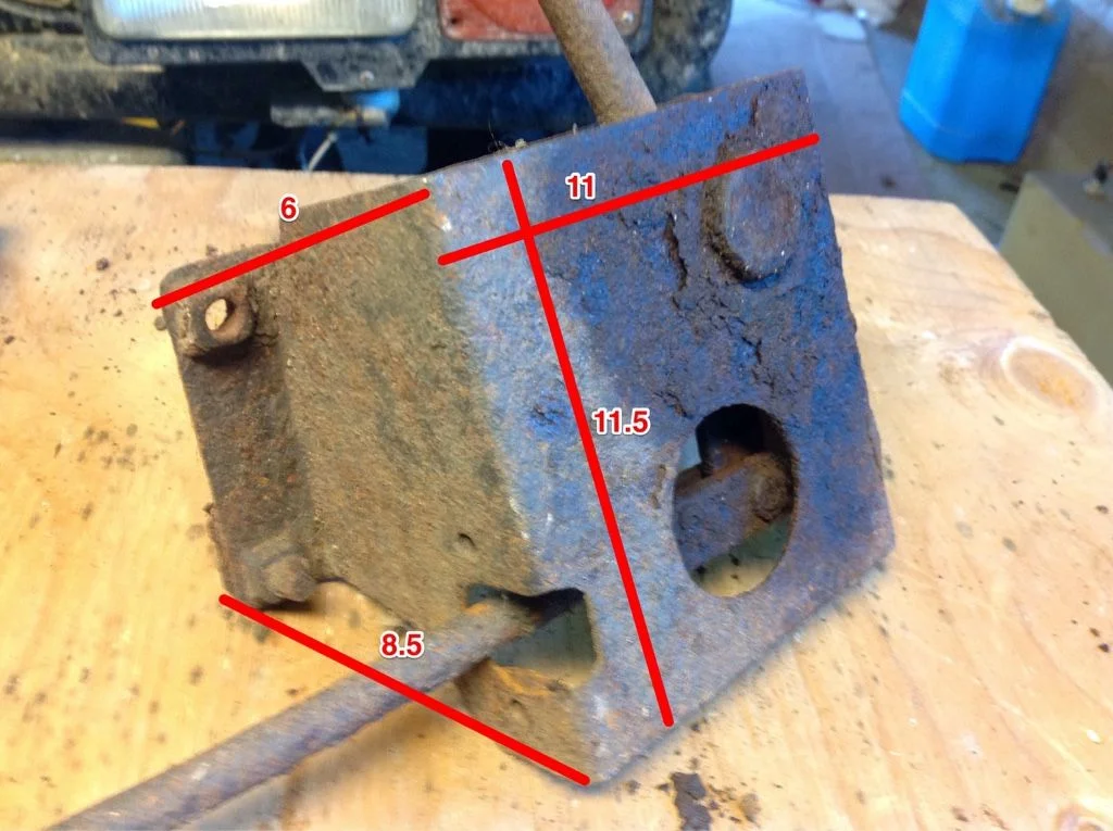

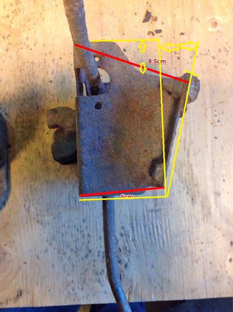

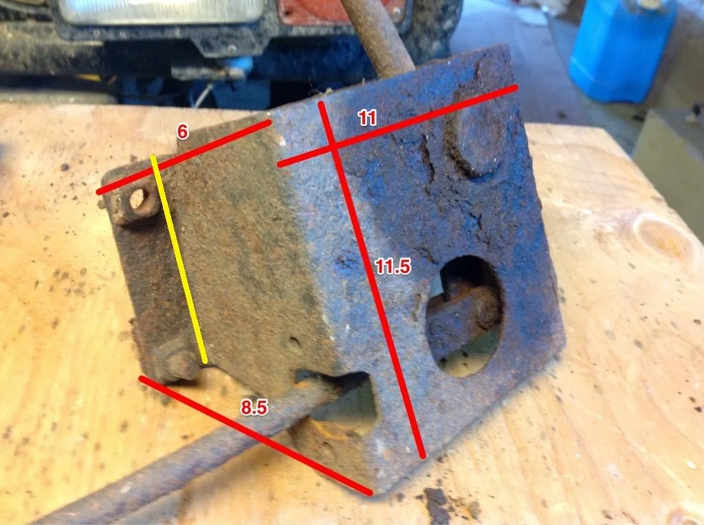

jmphilion, I was building a mock up of the shifter housing from your measurements which are working out very nicely. I would like to ask if you can measure the angle part of the mount and the lip mount height. I included a few of your pictures with the yellow to possible aid in my question. I can find the angle pretty close but with the cutaway part (scrolled cut) of the side of the mount kind of put in in a gray zone.
Thanks
Sorry I also needed the link shaft opening area measurement also. Thanks again.
