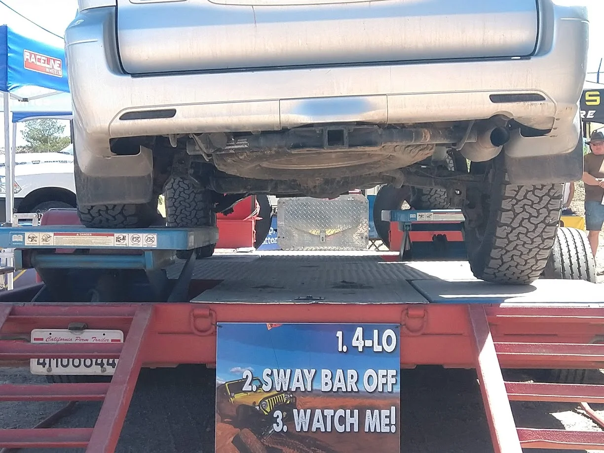

I did a CTI test in Moab during jeep safari this spring with Metal Cloack's CTI (corner travel index) table (but forgot to air up airbags, and didn't air tires down to 15 per their "controlled" standard for comparison purposes).
