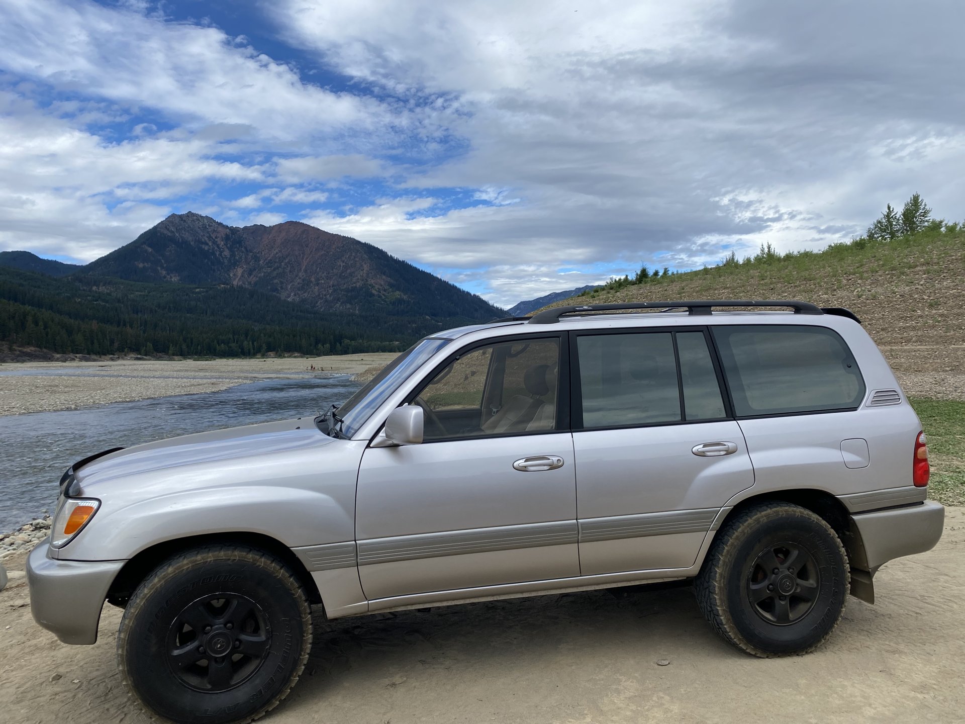

“Steve” 1998 UZJ100: a daily driver with stock needs but overland dreams
Steve has been running great! Put some miles on him last weekend. Ran out to the harbor and went crabbing. Turn around and drove up to a friends cabin and brought crab with us.
Wanted to drive across the river but didn’t try.

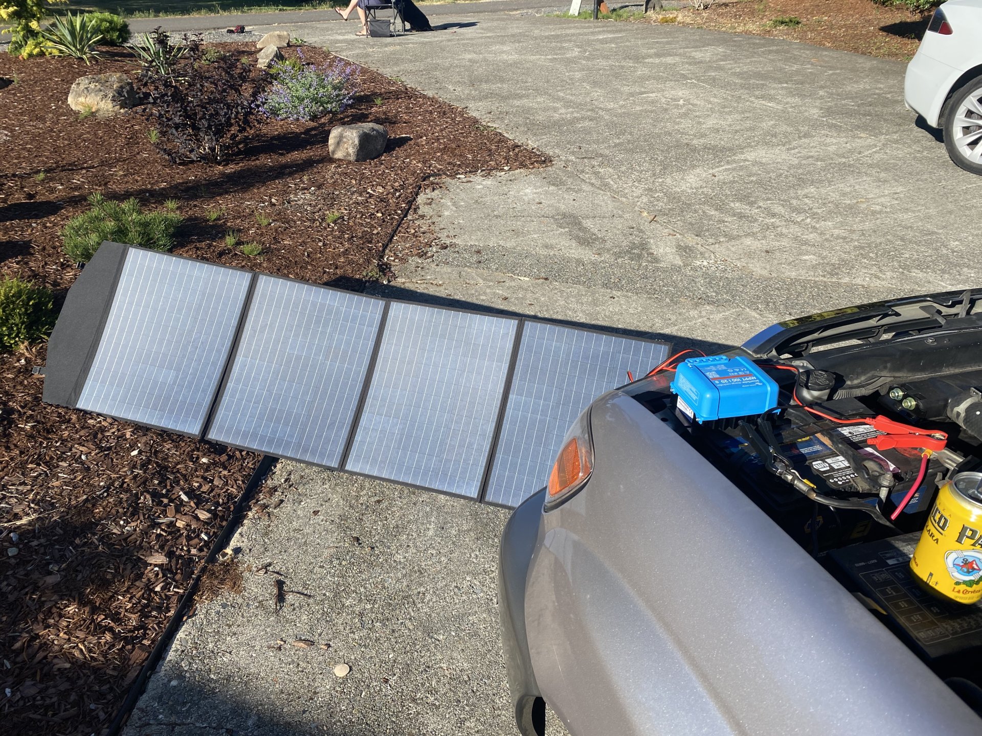

Added a 200w mobile solar set-up to move between the boat and different trucks when camping.

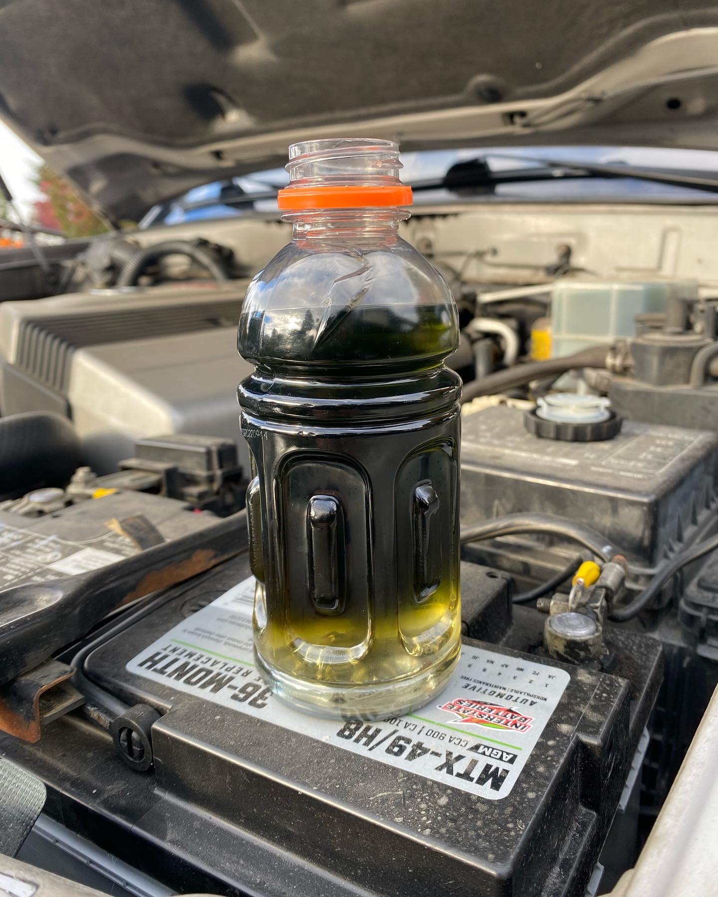

Next up Group 49 AGM so I don’t kill the tiny 24F flooded any more. It doesn’t have the capacity to keep the fridge going with the length of my commute. Maybe if it was an AGM or larger output alt and I had a longer commute?

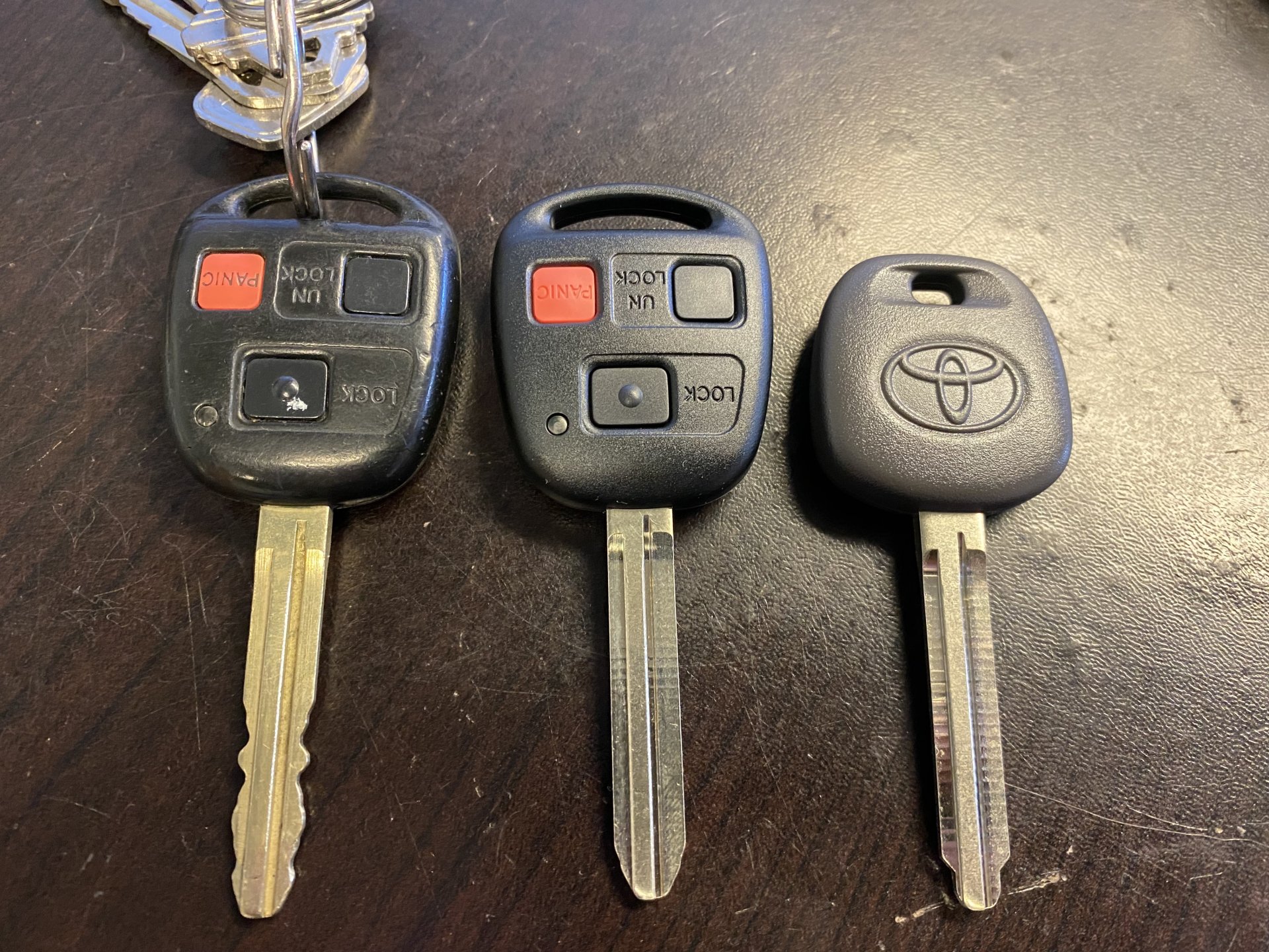

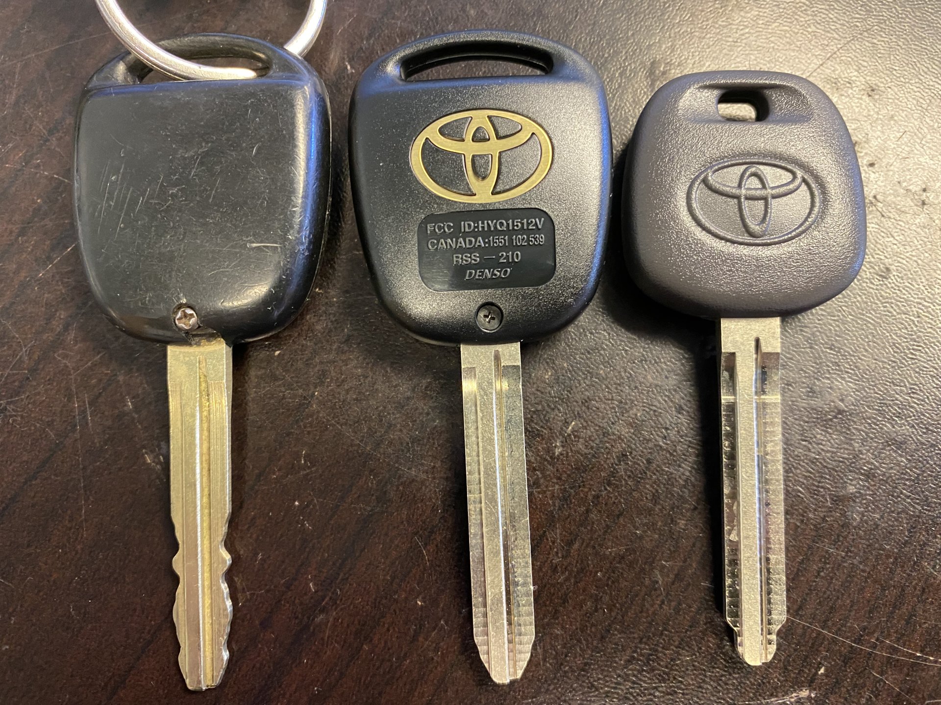

Order from your local Toyota dealership. I'd ask them to cut the key to the same vin code.
Remote Key incl. Transmitter:
1998.01 – 2002.08 = 89070-60090
2002.08 – 2005.05 = 89070-60750
Pulled from this source:
I will say that getting the new key programmed is a 2 step process. One to program in the new immobilizer, the second is to get the remote locks to work.

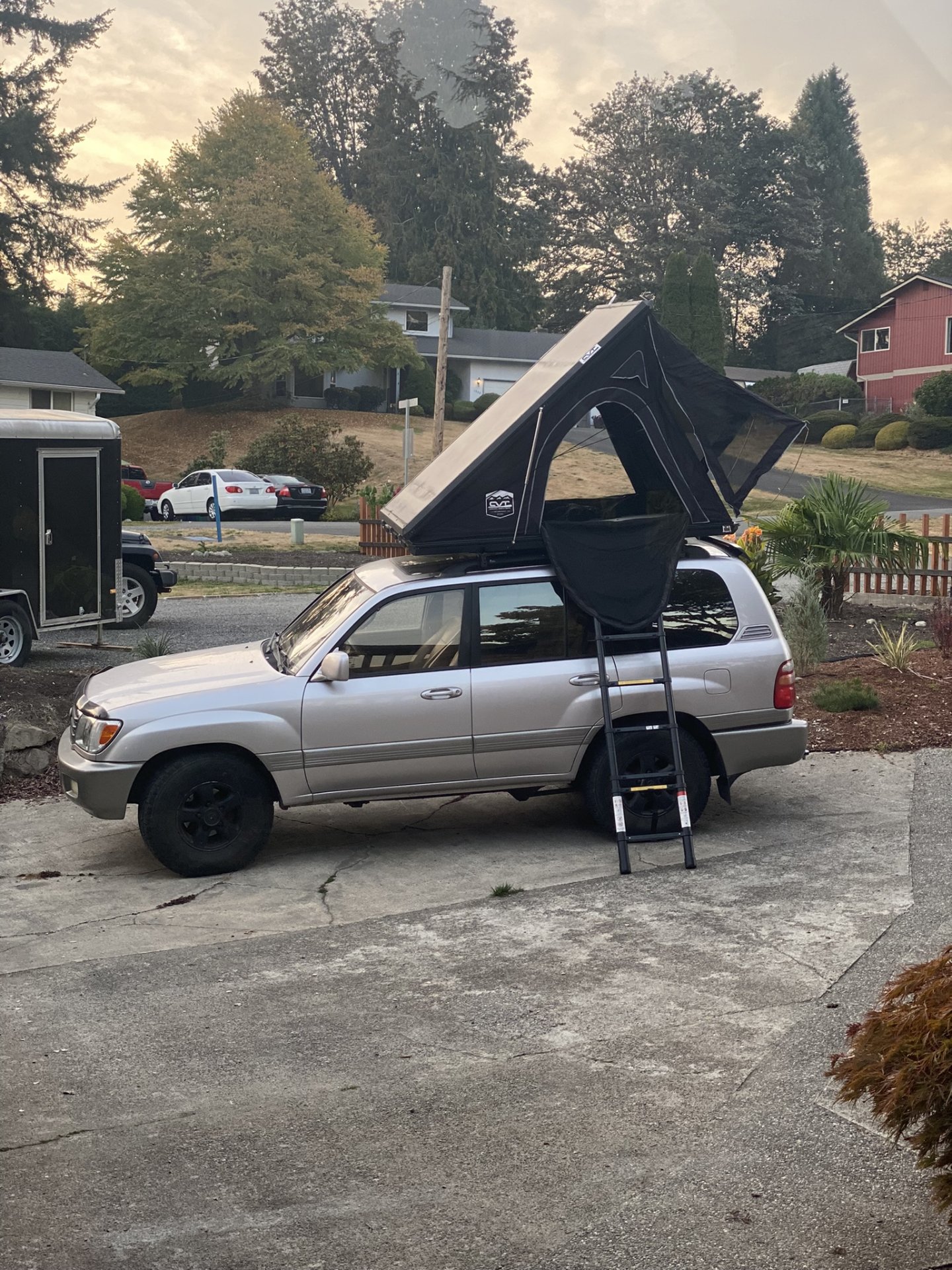

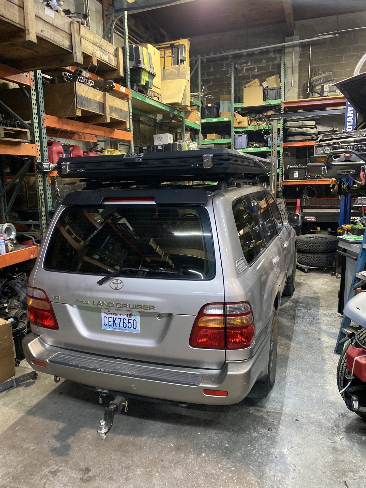

With the RTT up top the driving experience is much different. Getting used to it but much more too heavy. Wonder how much a new suspension would help with that vs currently.
Need to firm up a tent mounting solution for the top.
Currently have some Yakima bars mounted to the factory roof rails and then the tent mounted to WEW brackets (which are really nice).
Ultimately would like to have a ARB Base Rack but cost is keeping me from jumping in on that. I have other Cruiser mouths to feed that haven’t have been fed in a while.
Part of me wants to remove the stock rack and make mounts then add extruded bars across it. But right now everything is reversible to stock and that would add a more permanent aspect to it.

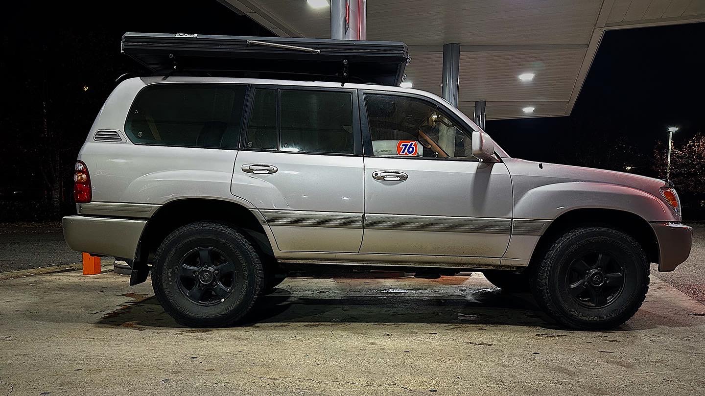

Take a look at Steve! Spent a couple hours playing with the suspension to gain back some height from the RTT and drawers. It’s like he has been hanging out with the Bang Energy crew at the gym for leg day!
This is a “left over lift”, just like taking chili cooked yesterday and has been building flavor over night, some things are best the second time around.
Steve got hooked up with a set of 3” lift 80 series progressive Dobinson rear springs! (C59-613V)
These had been run in a buddies truck for a while and he ended up swapping them out for another set of springs for his 80 series.
To level out the front we added a little extra twist on the torsion bars. We marked (starting position on the Mount, nut and socket) and cranked the OEM Torsion bars 5 full rotations on both sides. This ended up netting out to a 3 in lift in the rear and 2 in in the front.
We use the RTT as a point to measure along front and rear on the to ensure we were even on an iPhone level app. If you didn’t have that, you can use the top line of body cladding on the side to help check. Starting measurements from the ground to the fenders are also great starting reference points. Some considerations for torsion bars: over cranking them will limit down travel, you may need to re-align the truck after modifications to the torsion bars.
I can say that so far the new(er to me) springs ride just as well as the tired OEM ones. The shocks had been replaced with Bilsteins at some point and I’ll rock those for a bit longer, they have life left in them. I picked up a set of remote resi Icons I need to look over and clean up and see if they need to be sent out for a rebuild.
ARB base rack moves: I have a plan to use the mounting kit for the base rack and extrusions cross bars for the CVT. It should be much more secure than the system I’m using now, and lower the tent about an inch. I think that I can use the ARB base rack wind deflector to even mount to the bottom of the CVT to further cut down on wind noise.

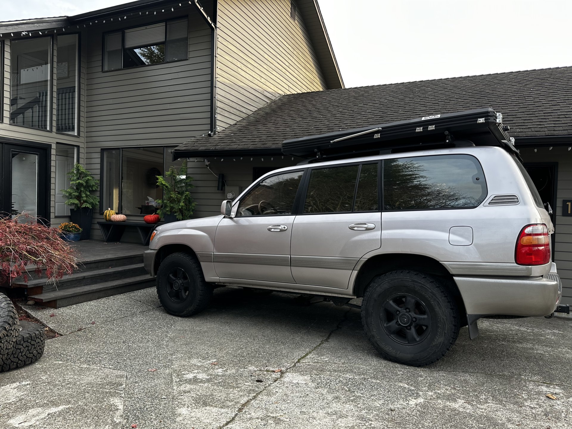

Before:
After
Wasn’t the biggest fan of the 18 wheels from a tire and sidewall perspective. But the deal for KO2’s and 18” LC wheels was to good to pass up and they do look much better.
