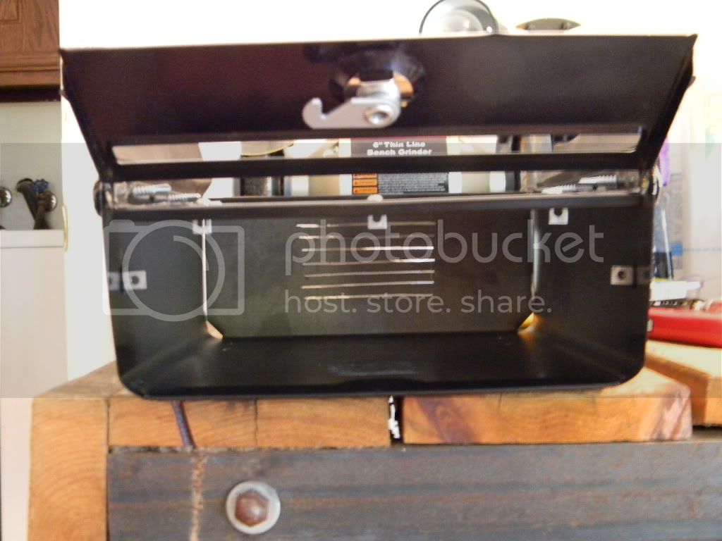

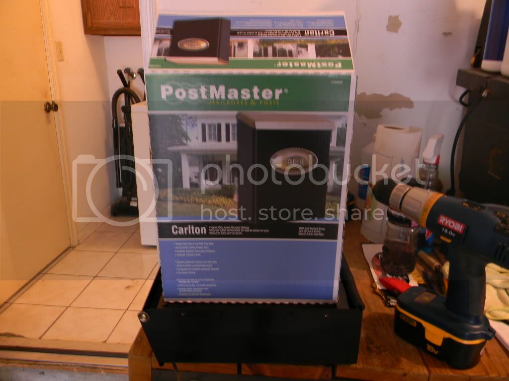

Not being a fabricator, I needed to find an inexpensive solution that I could purchase and modify to fit. Hence the logical choice of a humble mailbox - $30.

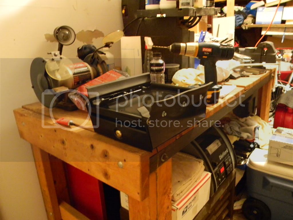

I removed the brass colored lid with tin snips, rounded the hinge points, and drilled some mounting holes. This unit comes with a lock and pre-formed vent slot! ;)

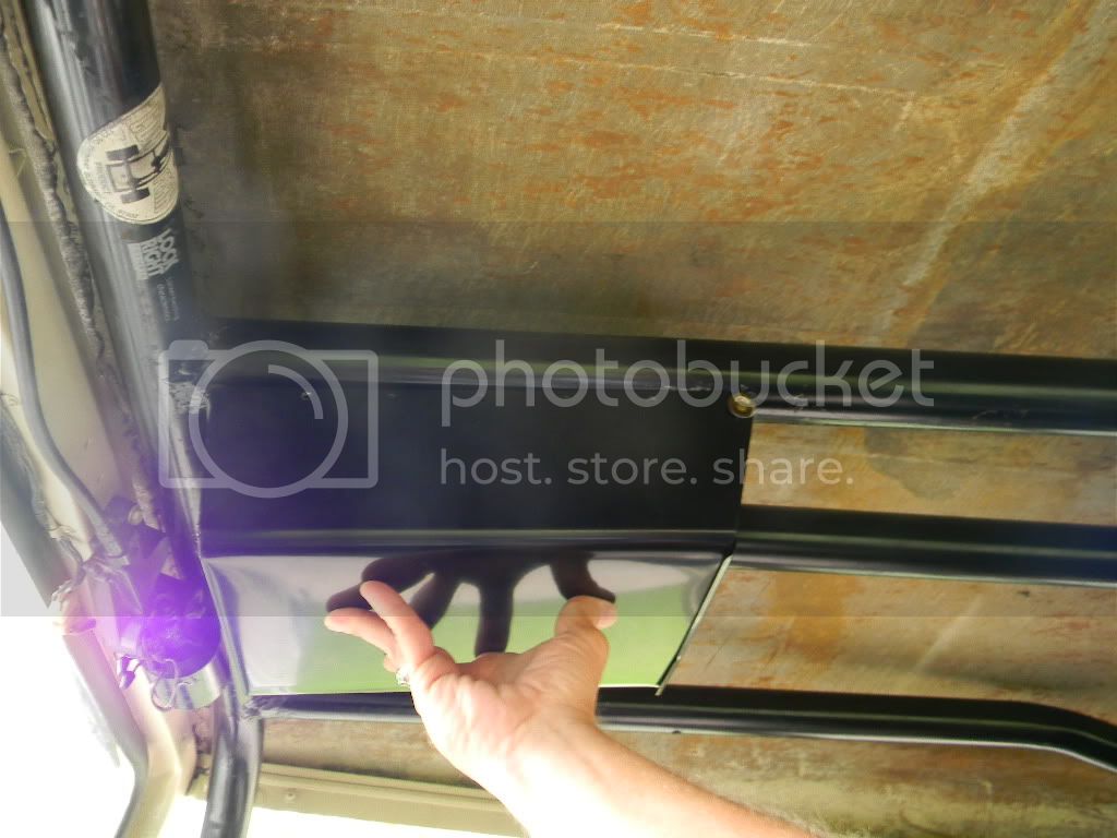

Looks like it will fit pretty well!

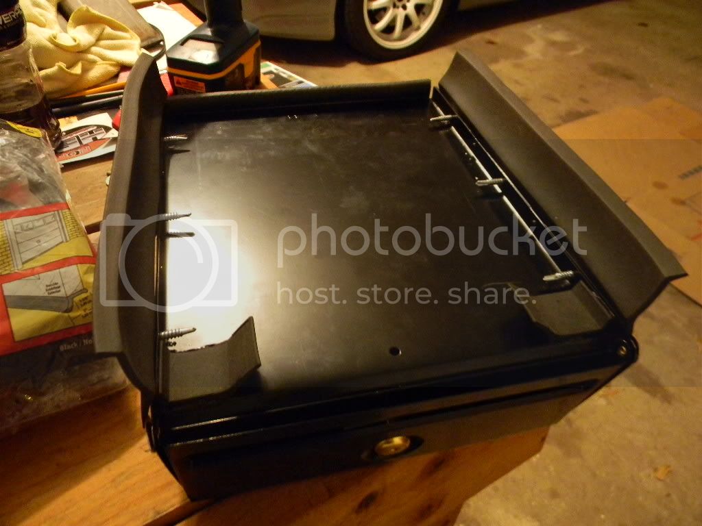

I wanted to shock mount the console to reduce the vibration experienced by the HU, so being a cheap ass I improvised. Some fuel hose cut down the middle for the back where it rests on the cage, and some garage door weatherstripping from Lowes - $10
It's not a 16 ga Tuffy, but it serves the purpose and has all the features for 1/4 the cost. Plus it's custom....:cool:

I'm diggin the ingenuity :cheers:. Way to think outside the... or use the.. er... you know what i mean. Nicely done.
I'm going to cut some more vents in the bottom and replace the screws with bolts. Those two little pieces of weatherstripping on the top are covering up holes. I'll build them up so they rest on the spreaders.

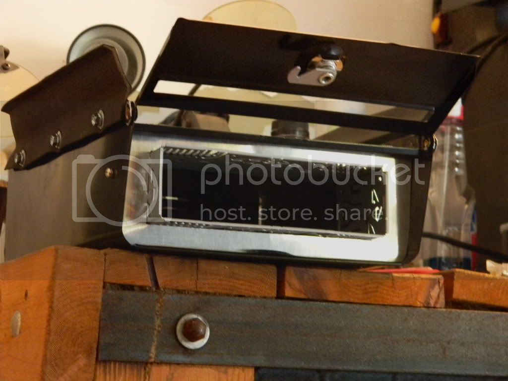

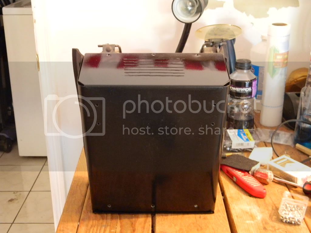

I bought my system, so now it's time to get the mailbox ready to receive the goodies. I used a Dremel Tool, ruler, drill, and file.
Mounting holes drilled and vents cut out of the rear

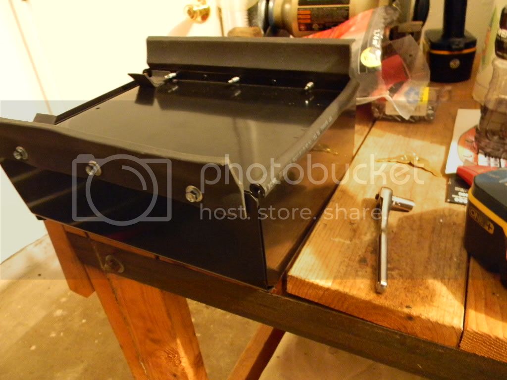

I decided to make a DIN mount from scratch - some 22ga aluminum sheet metal and lots of little homemade L brackets. I would recommend 16ga for this, but I didn't have the means to cut it accurately.

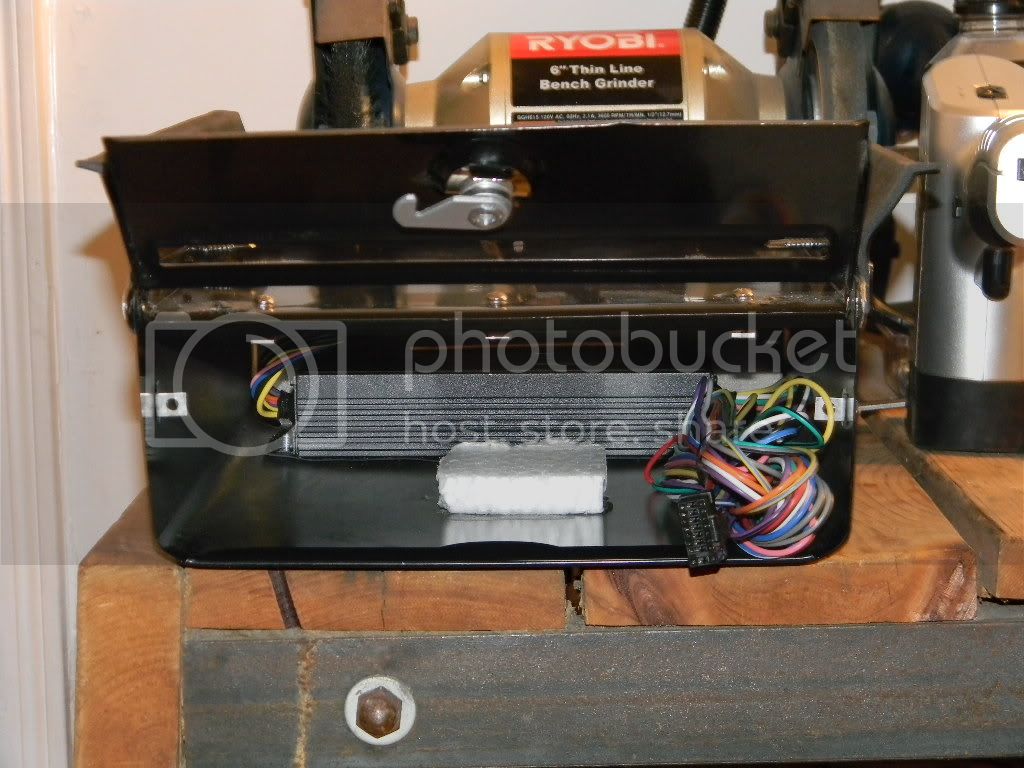

Amp installed and the lower foam piece for HU support and shock suppression. I still listen to CDs so shock suppression is important in a 40....

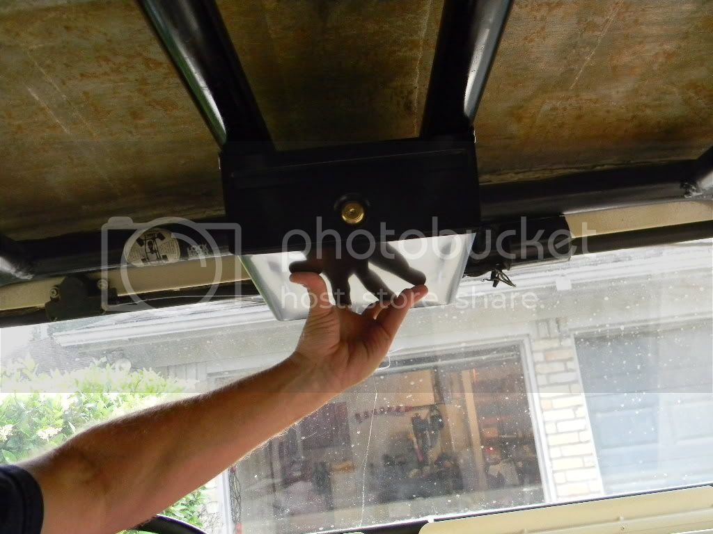

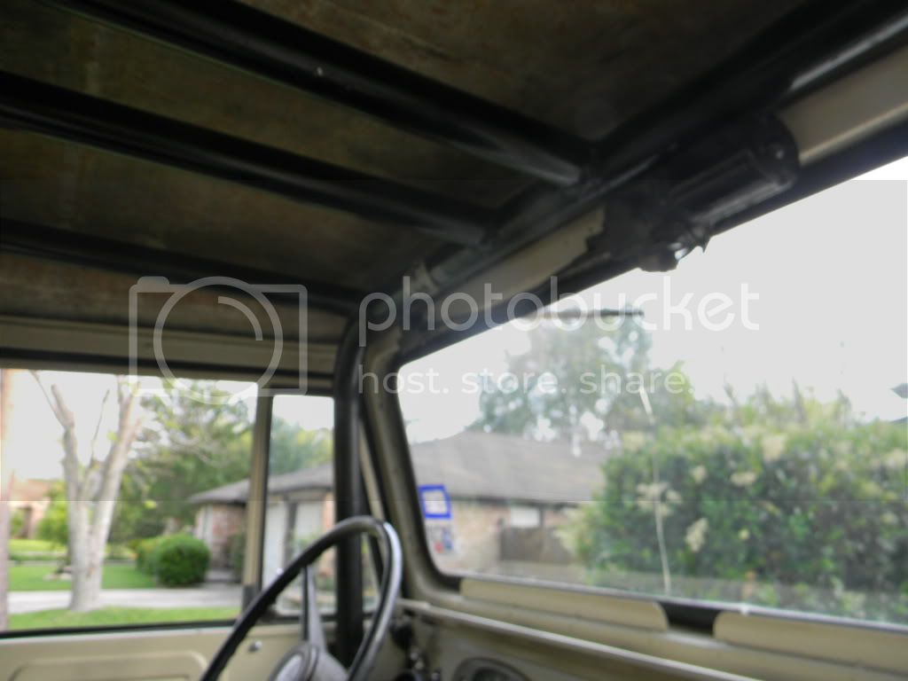

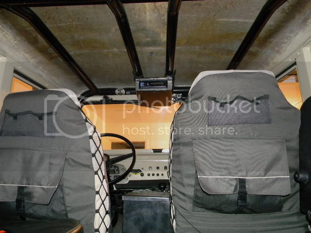

I'm happy with the install. It was very time consuming getting everything lined up and in place, but when I snapped the HU and DIN sleeve into the aluminum mounting plate, it made a resounding thunk - tighter than a gnat's ass! I'm afraid to admit that I mis-drilled every one of the 8 holes that hold the mounting plate to the box so I had to individually hog out the holes so the screws would go in.

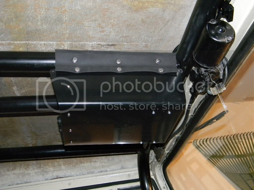

The wires run through a 1.25" hole (for the 20-pin plug) I drilled in the top of the box, along with a grommet I got from Lowe's. I have ample wire to run across the top bar along windshield frame and the harness tucks in nicely behind the wiper motor. The XM tuner and antenna are mounted to the top of the box between the speaders.

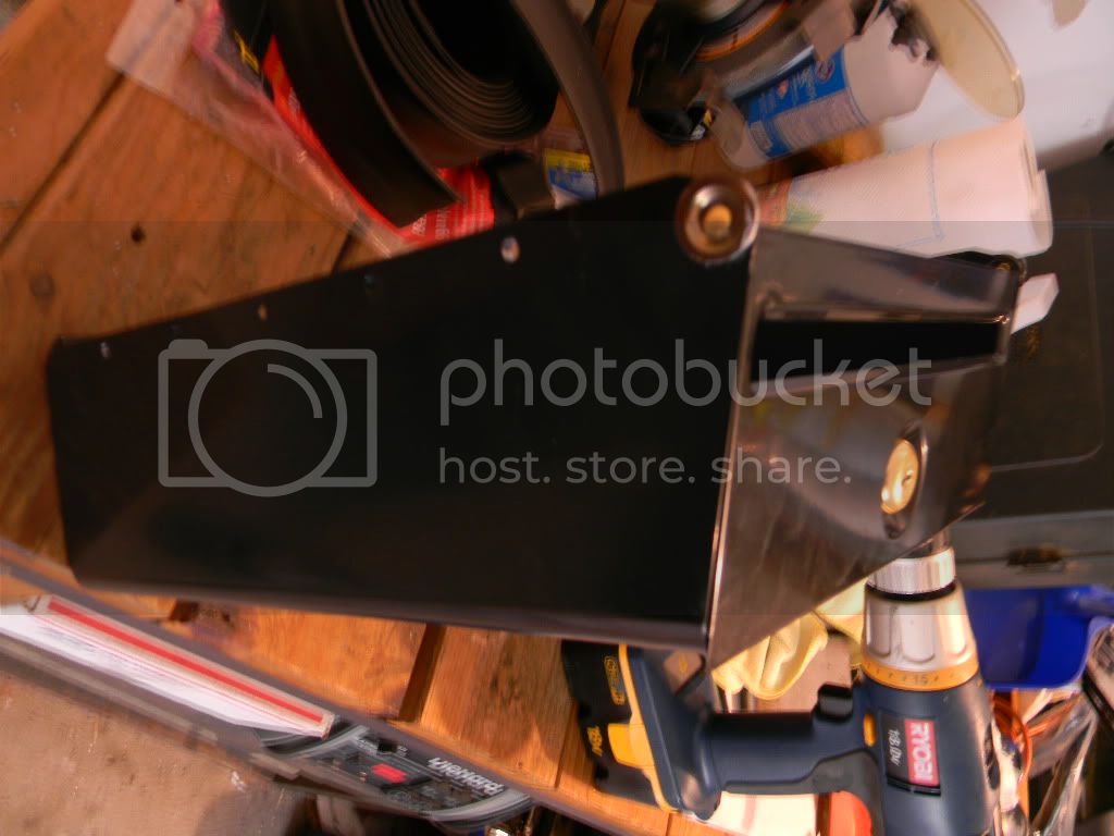

From the back

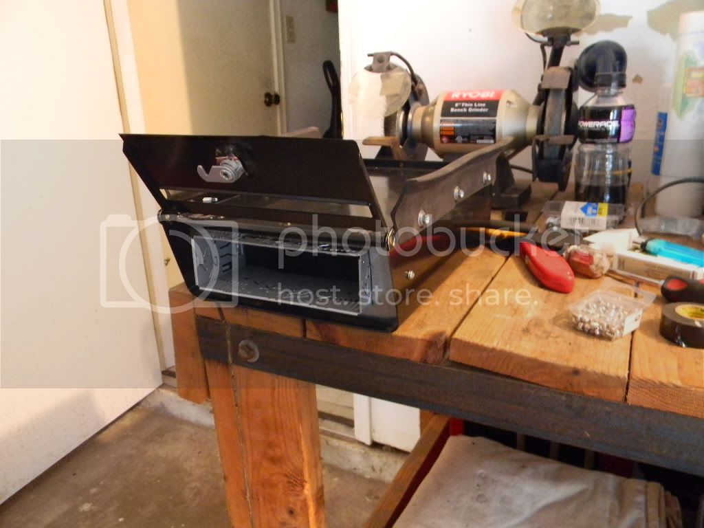

Side view

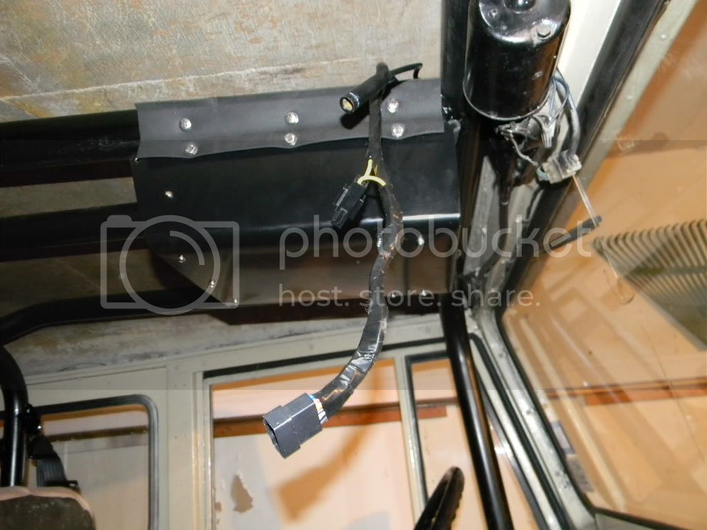

Wire harness, antenna wire, and fuse which hangs right by the wiper motor when installed.

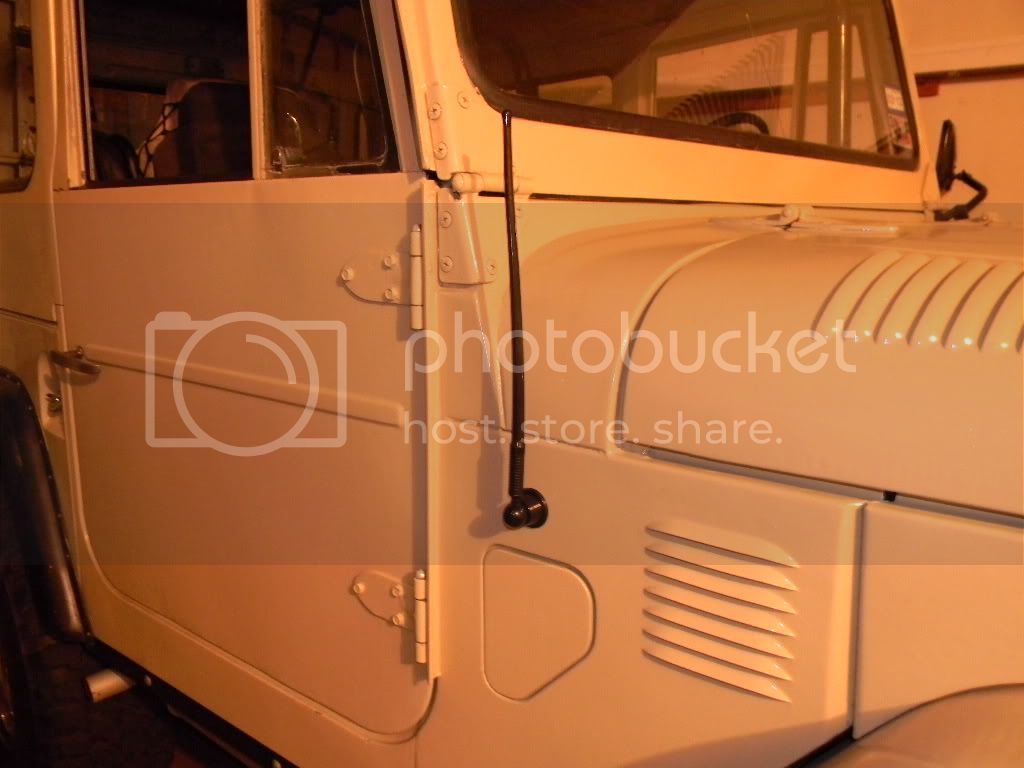

New antenna
