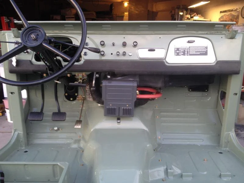

I refurbished my wheel. I used a moldable plastic epoxy from home depot and rustoleum paint and clear coat. Turned out great. Had it done start to finish in one day. there are several how to videos on Youtube.
So the rehab on the wheel is awesome. Can you give me a little better description of exactly what you bought and how you prepped the wheel?
