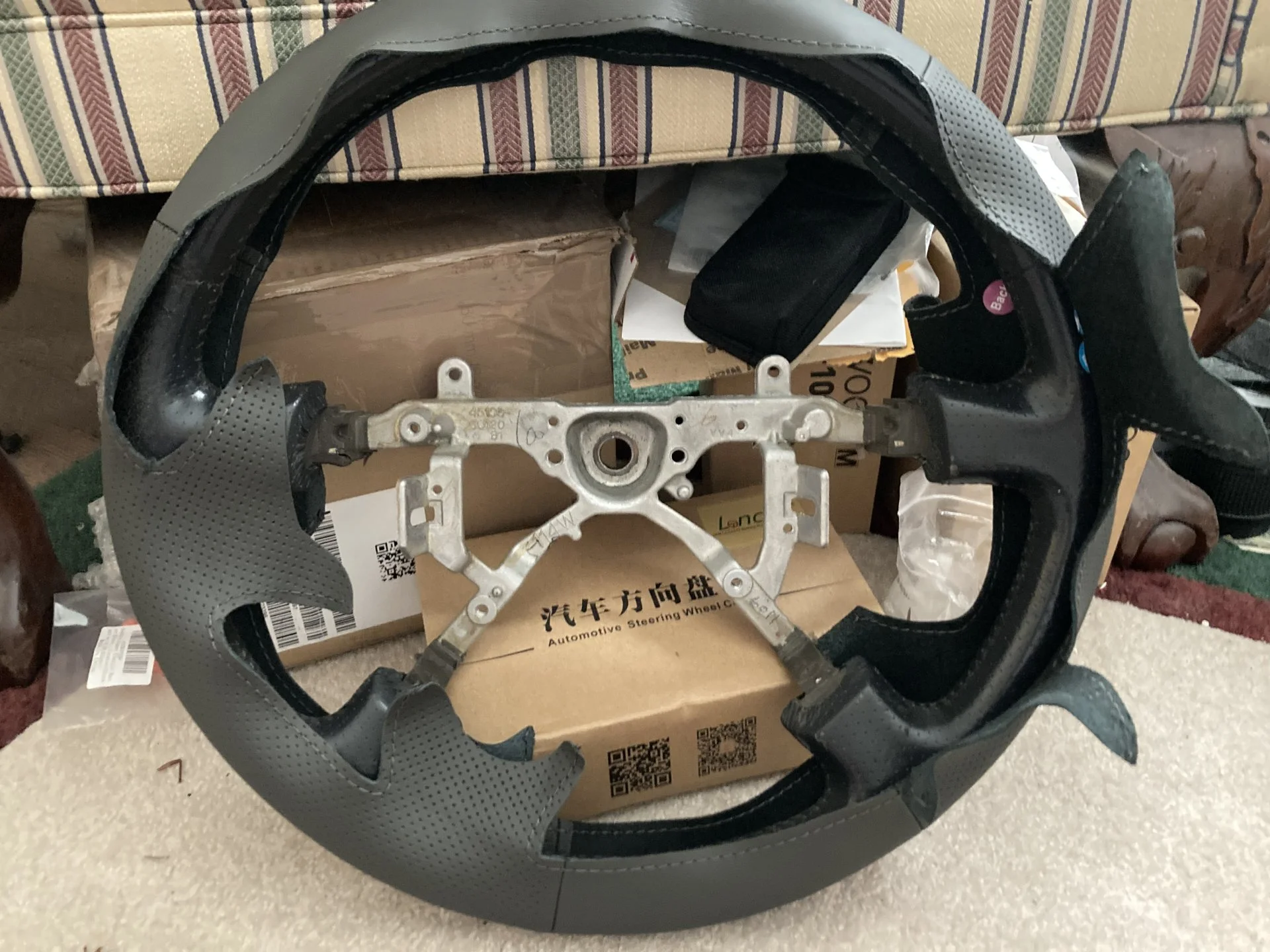

I just got mine in on Friday and considered Sunday a good day to do it, but after about 3 hours, I can't get this thing to fit!
My 5 o'clock and 7 o'clock spokes are not lining up at all while all the others do. I've tried with the wheel on and off and just can't get it to work. I'm pretty convinced I may have received the wrong cover, maybe the one for the LC wheel without the media controls (not sure which years)

This one looks correct with the non perforated section at the bottom of the wheel, mine is perforated through the whole bottom.

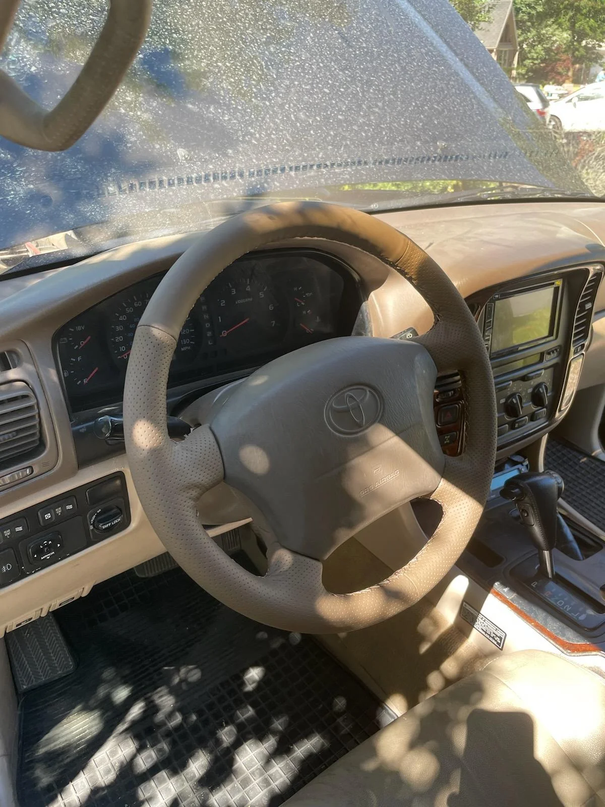

Well worth the time spent. Once I got the pattern figured out it is pretty easy. Do not start near the parts that go inward to the center. Start at the 12 o clock position and work outward one way, then do it the other way. Likewise from the bottom, start at 6 oclock and run outward, followed by 6 oclock again outward the other way.
