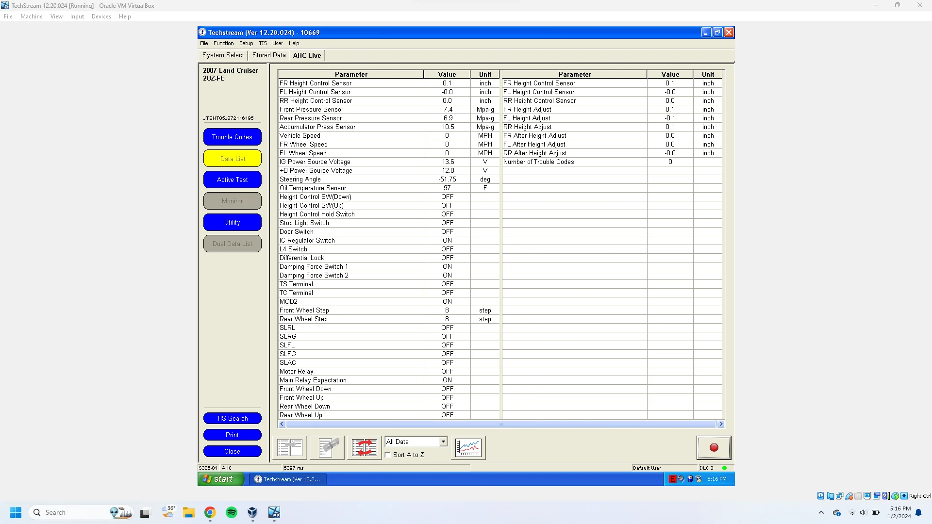

I recently acquired a 2007 Land Cruiser. 50k miles. Excellent condition overall. I was following the handy AHC guide here and doing some poking around with Techstream and everything looks pretty good there however... the steering angle sensor reading is wrong. When the wheel is pointed straight ahead it reads around -50. This is problematic because as I understand it the Left/Right Block Valve is activated around this angle. I performed an erase memory and then a test mode on VSC and everything goes smoothly but the steering calibration is still off. I did notice that it seems like 0 is automatically figured out based on the middle of the max - and max + rotation. I should also note that steering rack was replaced at some point at the dealer many years ago. Any ideas? I am thinking maybe when wheels are straight the rack isn't at the center and that because of this the algorithm used by the VSC to determine 0 degrees is confused. Or am I overcomplicating this?
Techstream Screenshot with Steering Wheel Dead Center

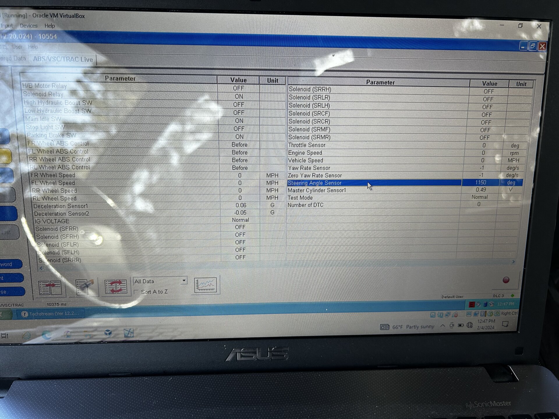

I just cycled through this 3 times with no luck. Still showing 1150 degrees in Techstream. Anyone have similar issues getting the steering angle back to 0?
Looks like you're in VSC/ABS ECU not AHC. The discussion above is about AHC.
When you turn the wheel does the steering angle change? If not, you probably have a bad sensor or wiring issue.
If it does change, have you tried doing a zero point calibration?

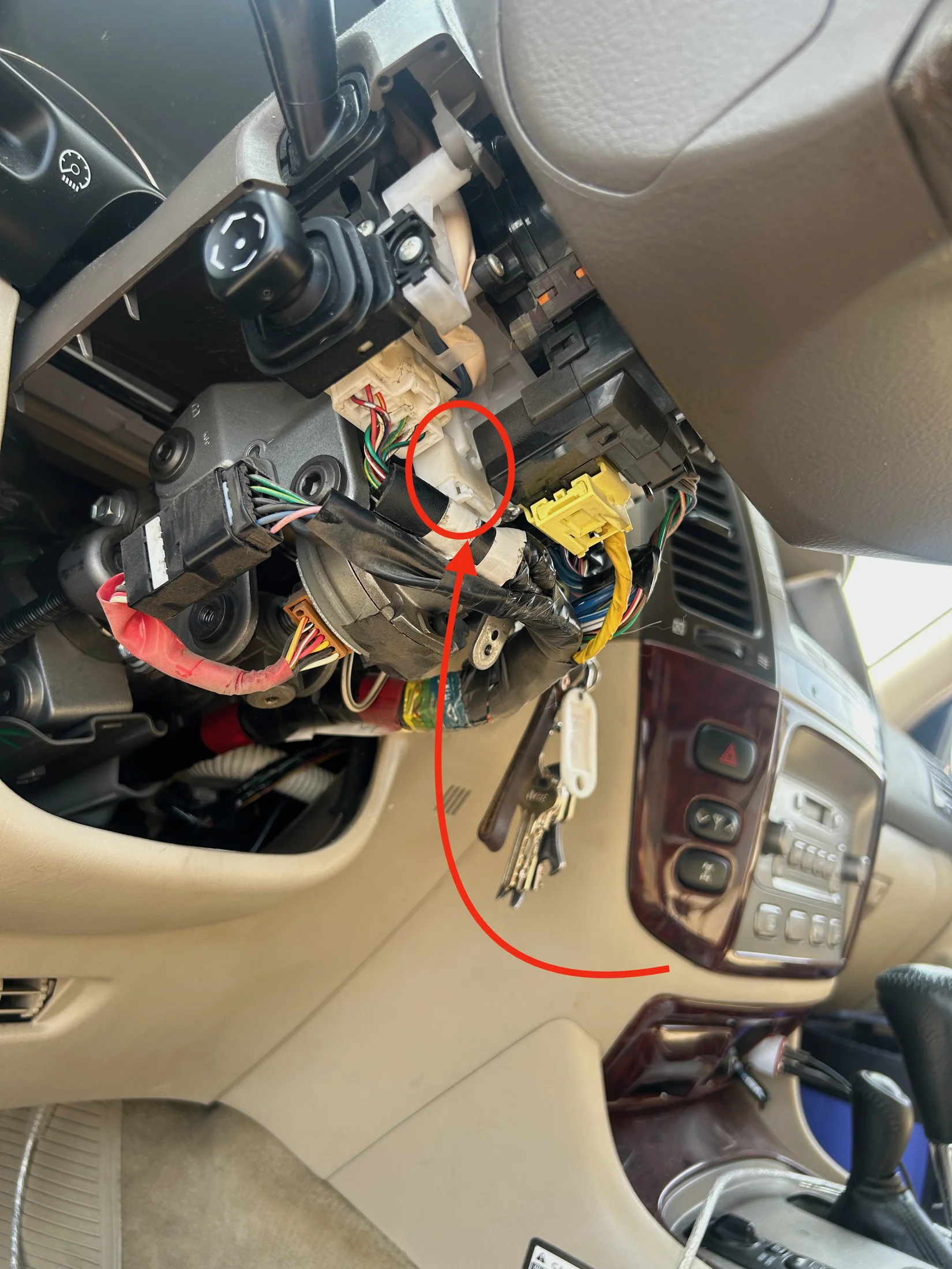

Thank you very much! I was able to follow these instructions and get my steering angle back to 0 in the AHC menu inside TechStream. Hardest part was taking off the steering column (which was still very easy).
For anyone like myself who stumbles across this thread while trying to solve this issue, I was able to figure out exactly which connector needs to be unplugged. For reference, this is a 2007 Land Cruiser w/ AHC and VGRS.
