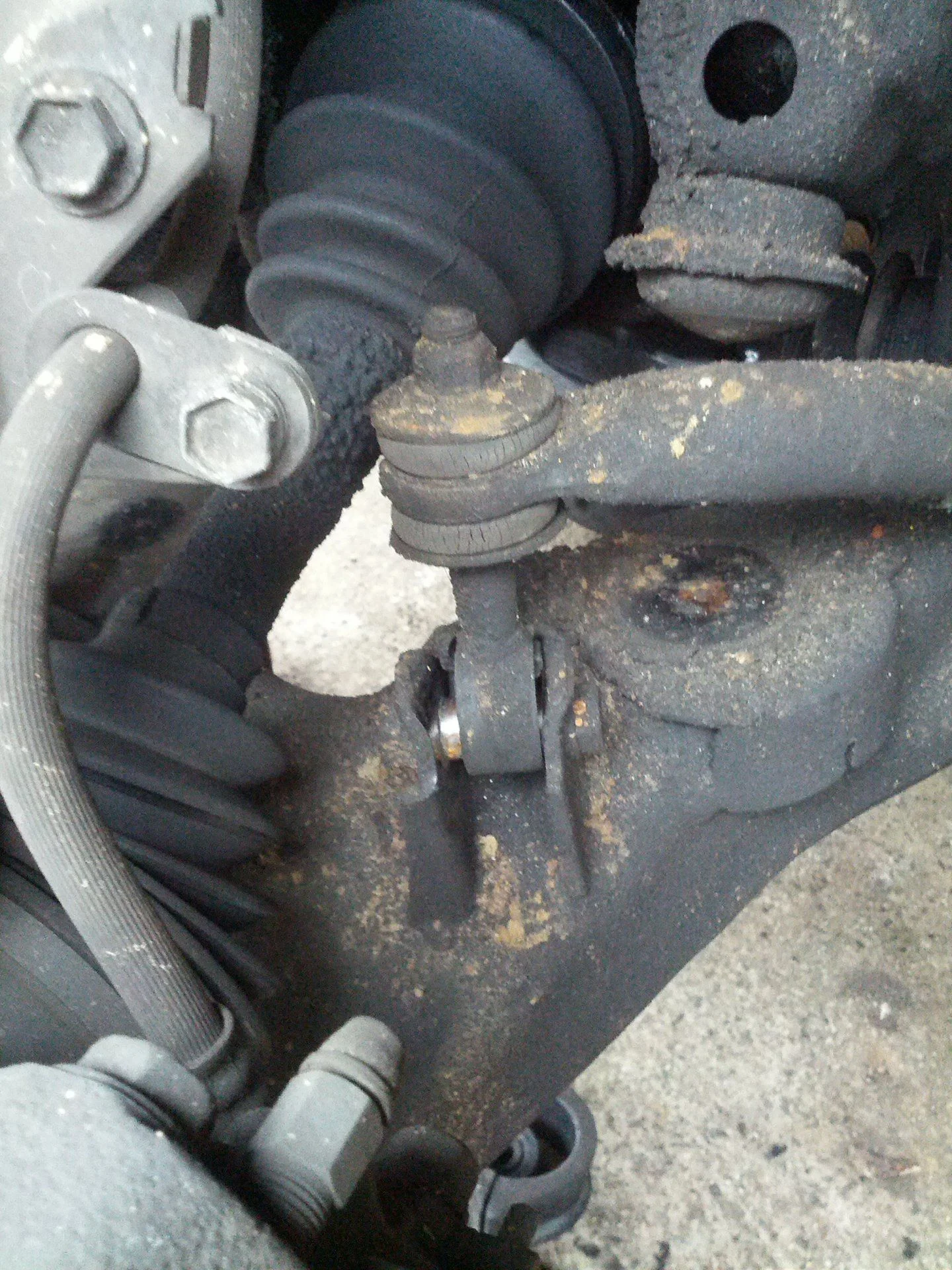

New front sway bar end links, old:

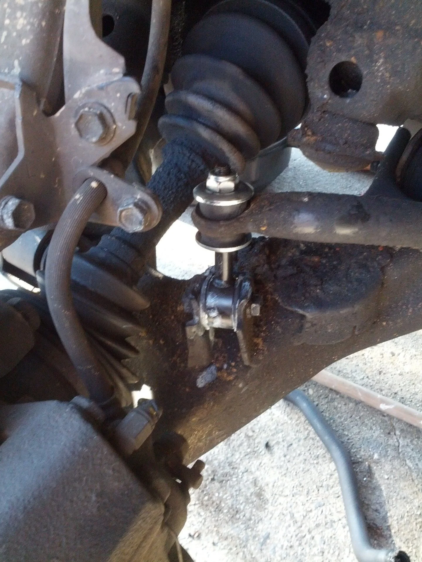

New:

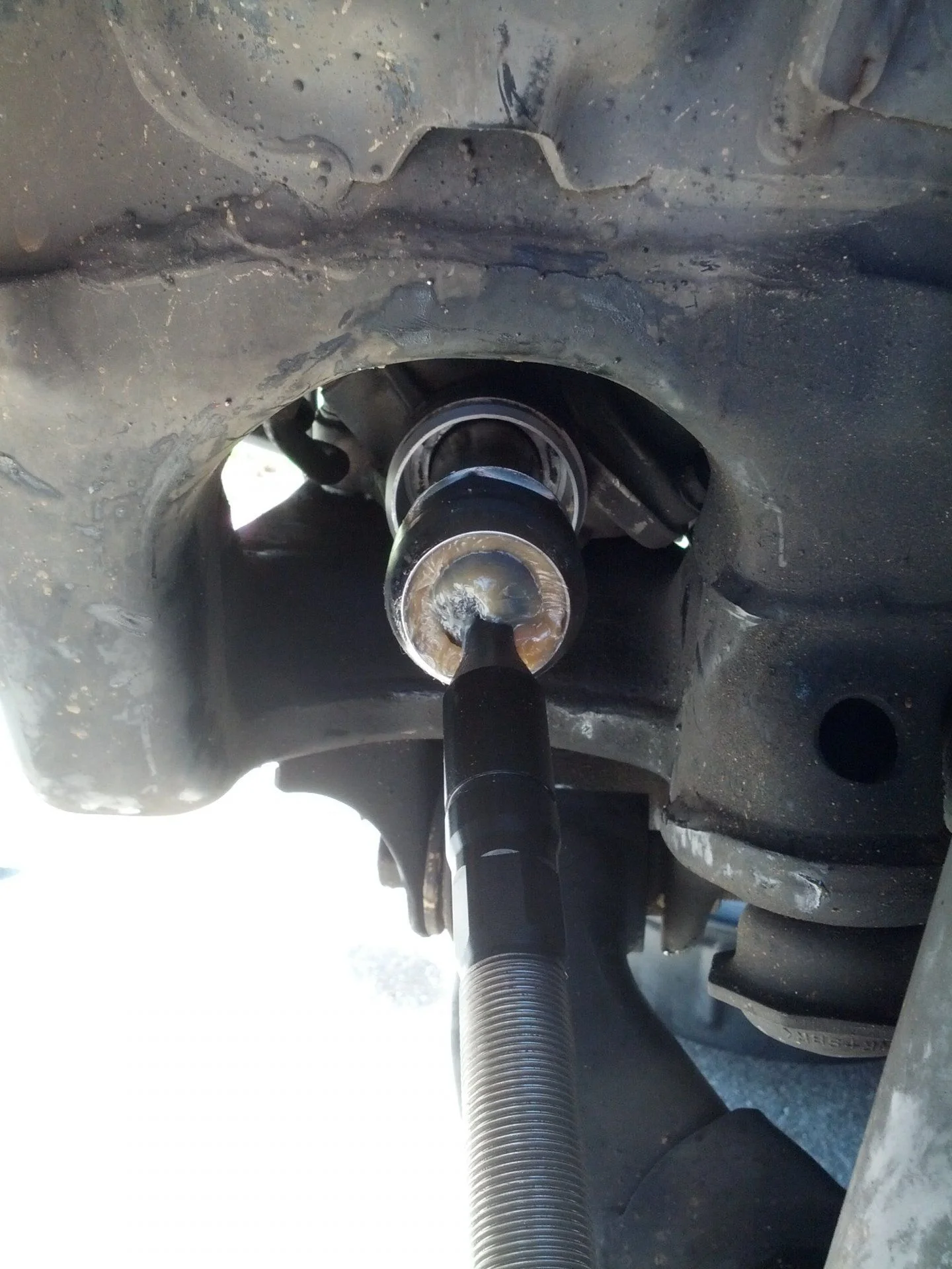

New inner tie rod, old showing play:
New:
And now no more play, haven't driven it and haven't had it aligned yet, so...

I took it for a ride around the block yesterday and there is a clunk turning out of the driveway. I think it sounds like the sway bar and not sure the bushings there on the links are compressed enough?
I didn't replace the D cushions, maybe should have too.
Any thoughts before I drive it to the alignment shop, I just replaced an inner tie rod.

I re-torqued after the spin around the block, raised and lowered the suspension and haven't heard anything since.

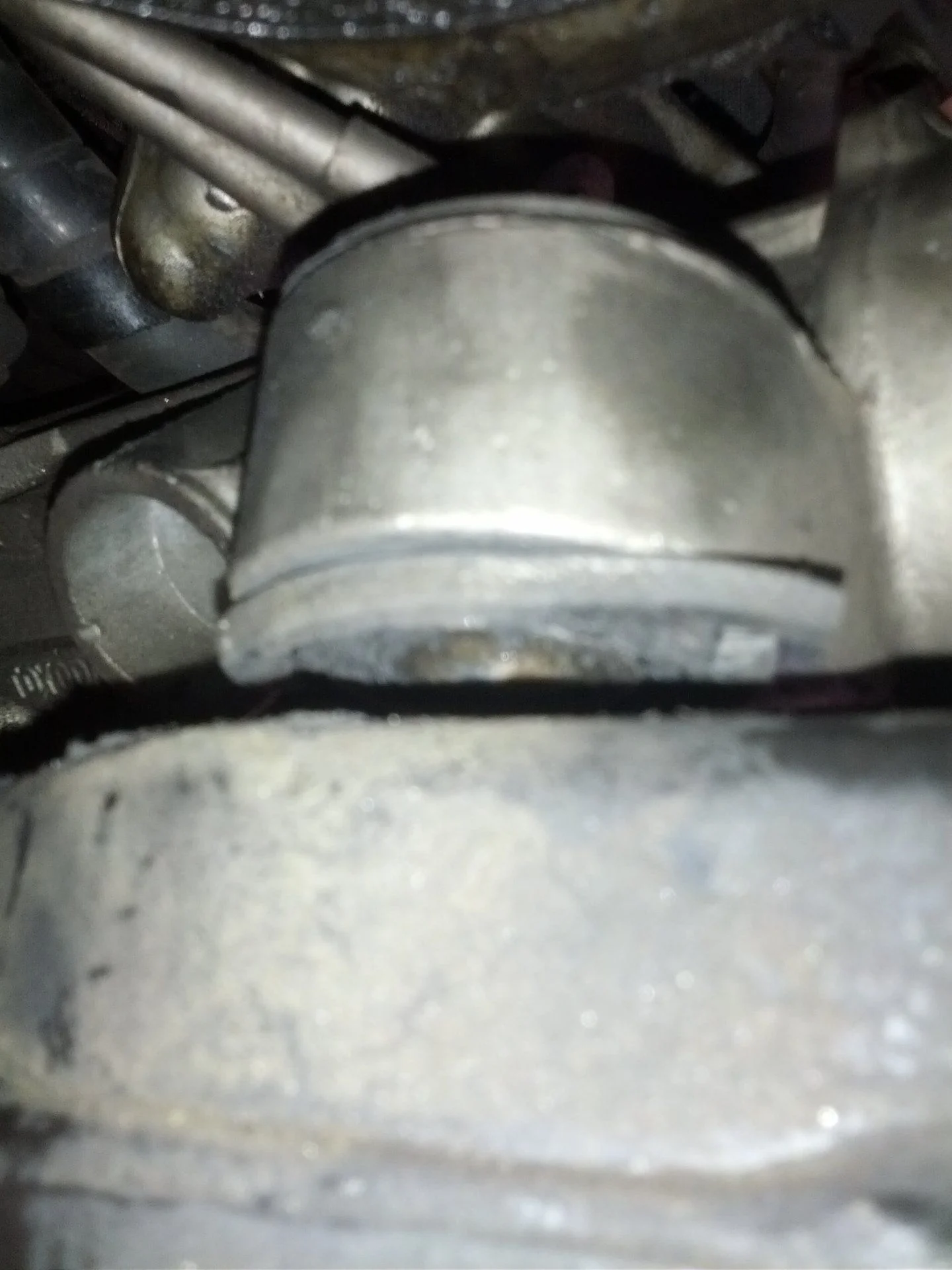

My bushings look in relatively good shape at least similar to #chickeknob
Not expecting much given how they look. Its interesting that the two smaller OEM bushing have arrows on top and bottom which IMHO indicates direction on the install. Secondly on the rubber shafts notice that they have bump outs of extra rubber, the arrows align to where the shaft is indented. The replacements are uniform throughout.
Would be interested in how the arrows align in a replacement or new rack, right/left or front/back.

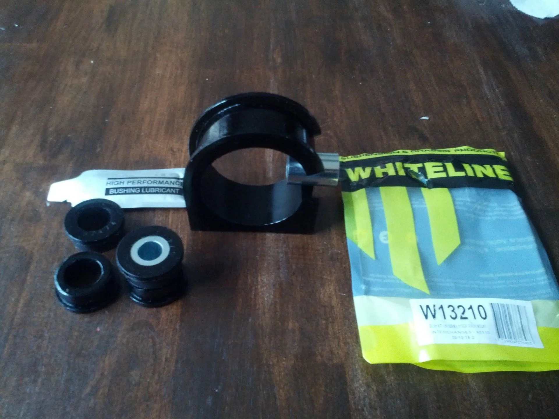

Whiteline kit arrived, showing the split D:

Finished the job last night using the whiteline kit. Took the longest to insert the bushing sleeve into rubber already in rack. Ended up beveling the steel bushing a bit on both. Really helped me.
The D bushing had a slice in it to go around the rack, no need to remove anything.
The other bushings just pushed out from the bottom using a screw driver through the cross member, not really sure how normal removal would be.
