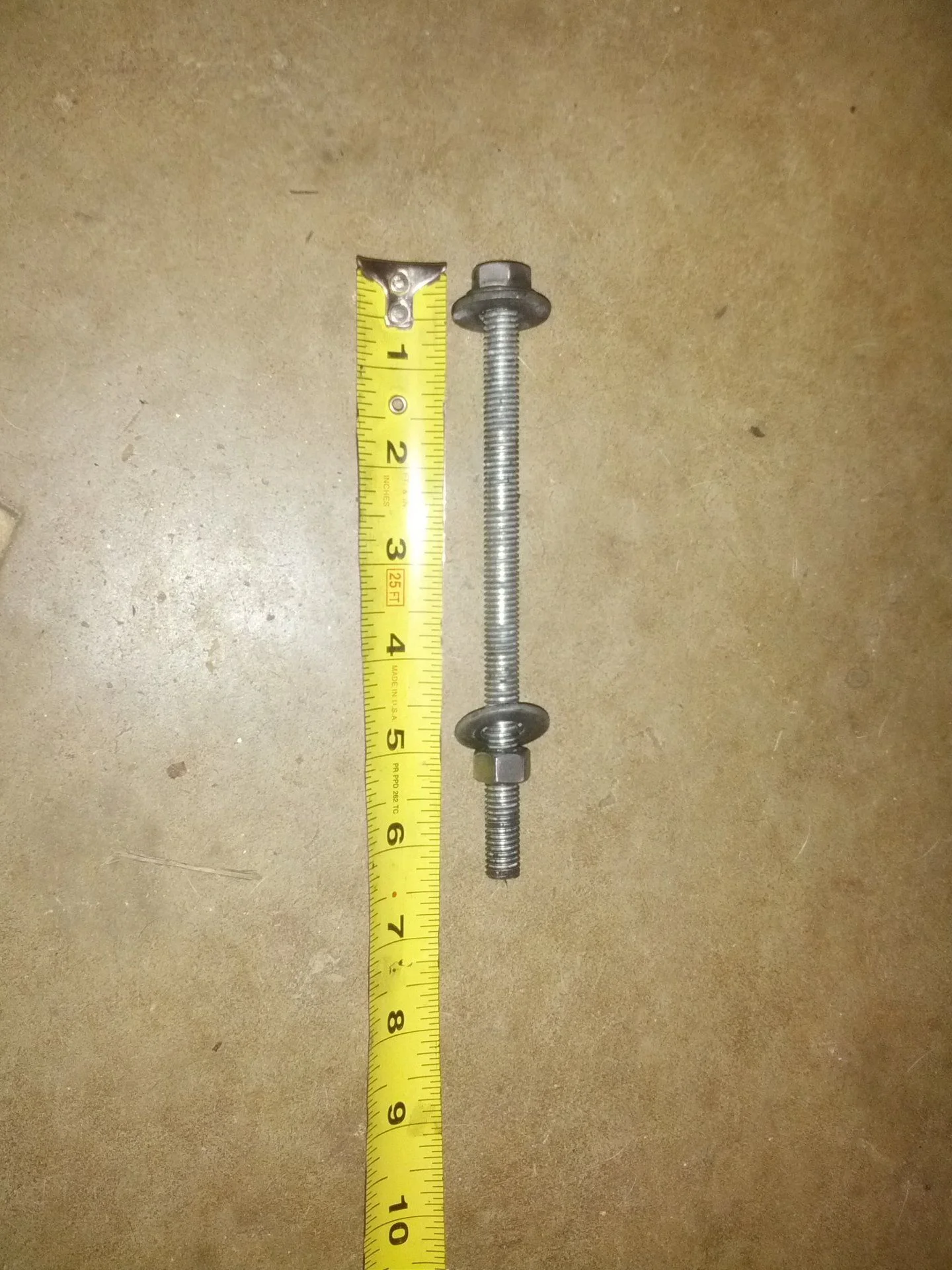

And how did you put the new bushings in? Did you devise the bolt, washers, and nut tool the way I drew it above???
I used threaded rod, I could control the depth without removing and adding washers. There isn't much room on the rear and ratcheted the nut from the bottom for both front and rear.
I pretty much use the same tools which this member has here Replace steering rack bushings question

4. Install 2 small lower bushings - front and rear. What I did was just put them on, then screw in the bolt, so the rack would push these lower bushings in. They were squeezed between rack and cross member.
5. Front top bushing - install the metal sleeve into the top bushing, then install them both into the rack. Then use the "tool (bolt nut washer - just like your sketch above)" to push both into the rack. The top bushing and metal sleeve would go in a bit crooked/sideway. Once they are about half way in, I switch and use the OEM bolt, nut and washer to push them all the way. The OEM bolt is larger with less play so it will push them in straight.
