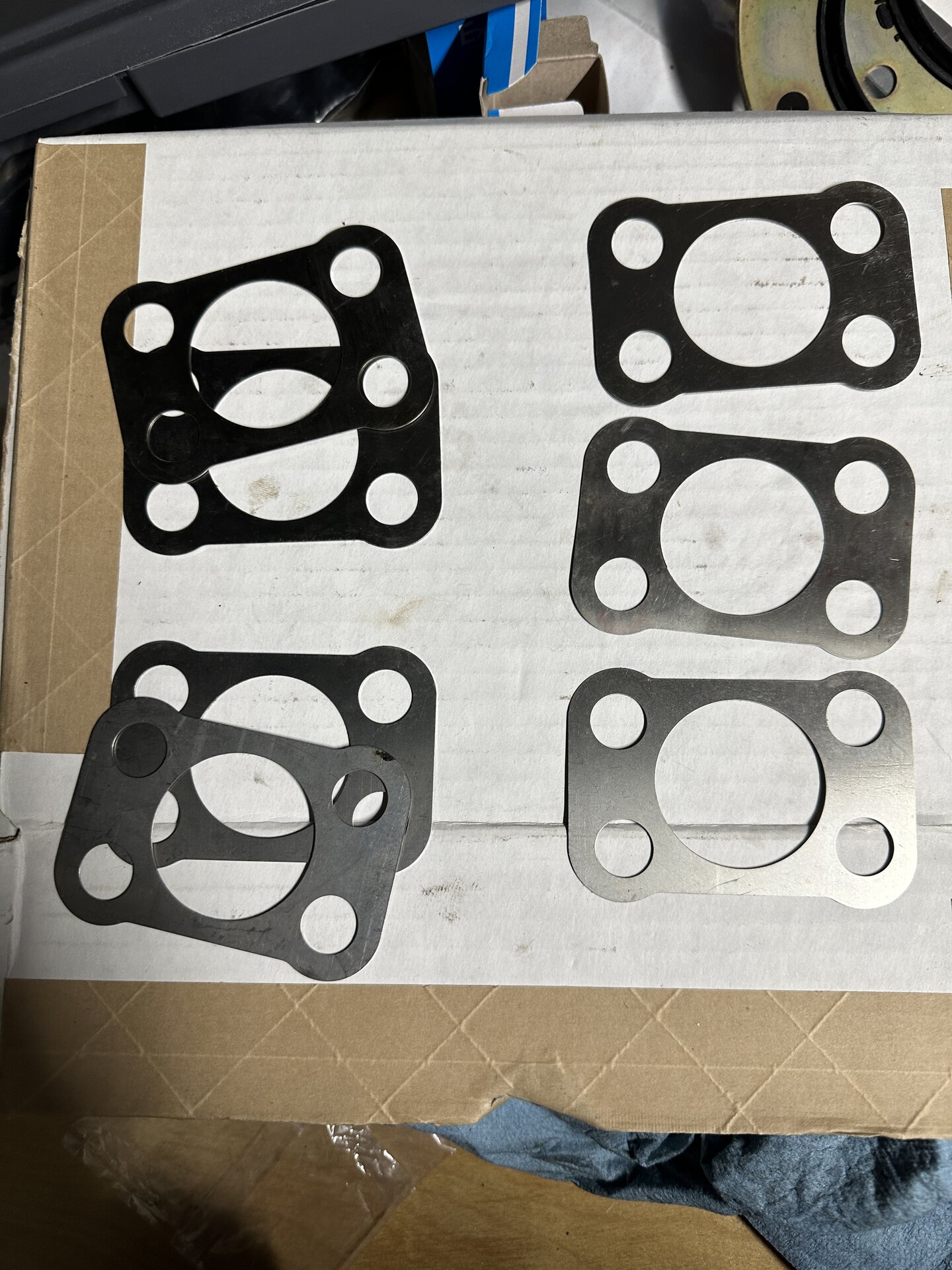

Plot twist. I measured the shims that came off the knuckle when I disassembled… Guess what? There were 2 1mm on top and 1 .5mm on the bottom. The rebuild kit comes with .5mm and .2mm shims.
These shim sizes from the shims I pulled off the knuckle fit the readings I’ve been getting.
Makes me wonder if the 084-101b rebuild kit I ordered from SOR had different shim sizes than the 084-101c kit they sent me. Anyone have information on this?
I usually order an extra set of shims every time I rebuild my knuckles, tomorrow when I get back from skiing I'll try to dig up my measurements from my last rebuild. I'm thinking one set is usually not quite enough on mine. Every cruiser is different.
Also, shims are a different size…the post holes are too far apart. Really makes me question whether or not SOR sent me a compatible rebuild kit. Old shim on bottom.
That's common, most kits contain both large and small pattern shims.
I might have a set of small ones stashed somewhere that I won't need, let me look around this weekend.
All same size, just different thicknesses. Are 80-90 knuckle stud patterns larger?
There is a good link in the FAQ that discusses the differences between the years and sizes of those.
