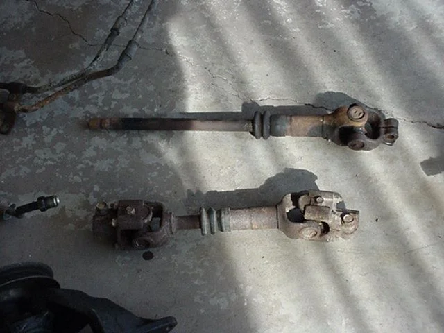

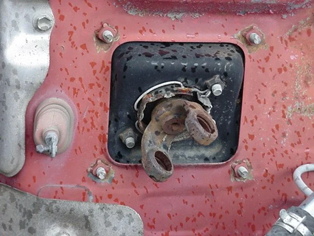

Here is what 60 looks like:
At the firewall (bucket is different)

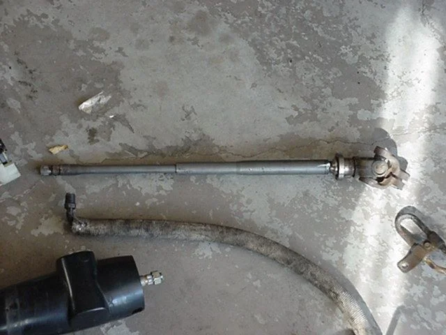

Intermediate shaft is longer than FJ55
attachment.php
