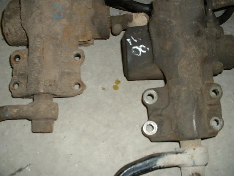

looking at the pics, the square bolt pattern is early and the parrallelagram is the later.
I'd show you in person if you stop by

View attachment 558845View attachment 558846
Thanks for posting these. As it turns out, I think I have one of each bolt pattern between my 40 and 55! But of course. I thought I was all prepared with a spare to send of to be rebuilt. Turns out I am only prepared for the one that is not leaking - Ha!
