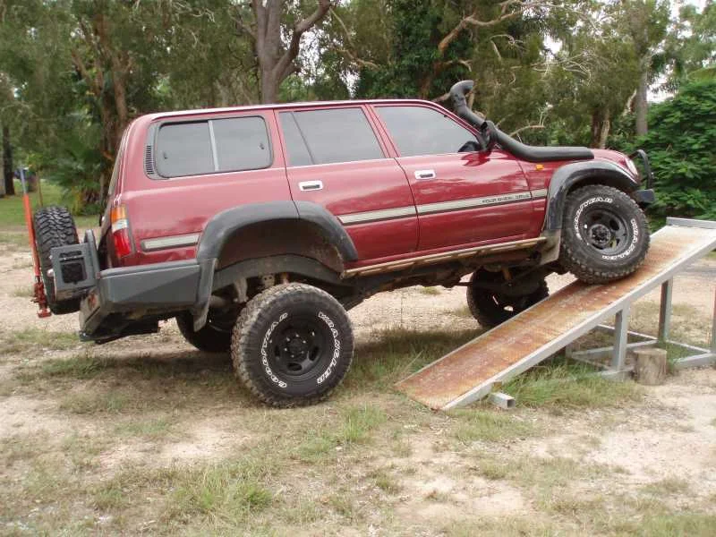

Powdercoat some OEM Steelies Black.;)

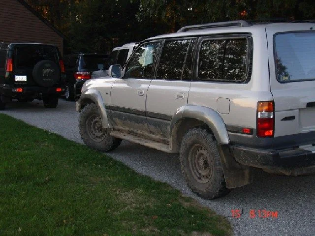

Below are the steelies I want for my 80...I think these are 16 x 7 steel Taco rims. Will they bolt right up to my rig? If so, what are to potential problems / issues with going from a 16 x 8 rim to a 16 x 7? Also, I don't know the backspacing on the steel Taco rims...anyone know this? Thanks again...

Thanks Dan...will the 16 x 7 Taco rims w/15mm backspacing in the pic bolt-up to my rig w/no mods? Please advise...Thanks
Apr 26, 2004
5,816
Utah
Tacoma rims will bolt up. The back spacing will be off and will require the use of a spacer to push the wheel out to a 'stock' position.
