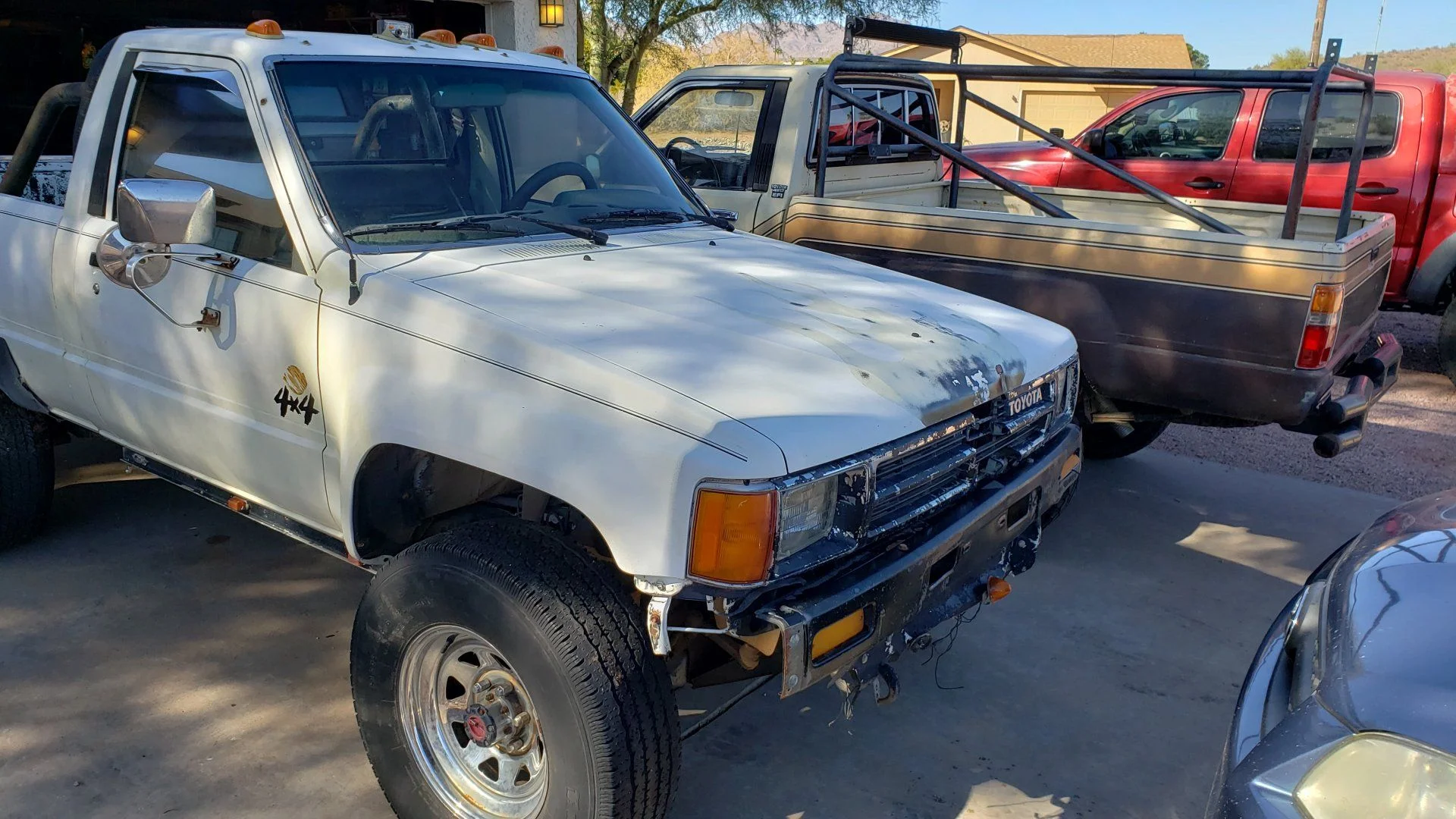

I recently acquired a 88 Toyota 4x4, 22RE. It hasn't run for about 2 years. Other than pull the plugs and pour about a tablespoon of Marvel Mystery Oil in the cylinders, changing the oil and filter, checking the radiator, and installing a new battery, any other advice? I planned to leave the plugs out and crank it assuming the starter works at first to move the oil around. Thoughts on draining the fuel tank first? Likely it's varnish by now. Thanks!

But, did pull the plugs, changed oil/filter (filter was completely dry), let the MMO sit for a day or so, new battery hit the starter. Oil from the cylinders went everywhere. My wife's 88 got a nice bath of MMO and junk. So now the plugs are back in and waiting for a dry driveway to drain the tank. Hopefully this weekend I can drive the thing.
Also, started removing all those lights. I mean the truck had lights on the front valance, attached to brackets on the rocker panels, under the tailgate, and those hideous things on the roof. Removed the shiny window vent things, the extra mirrors, and the tailgate cape. All that stainless steel!
