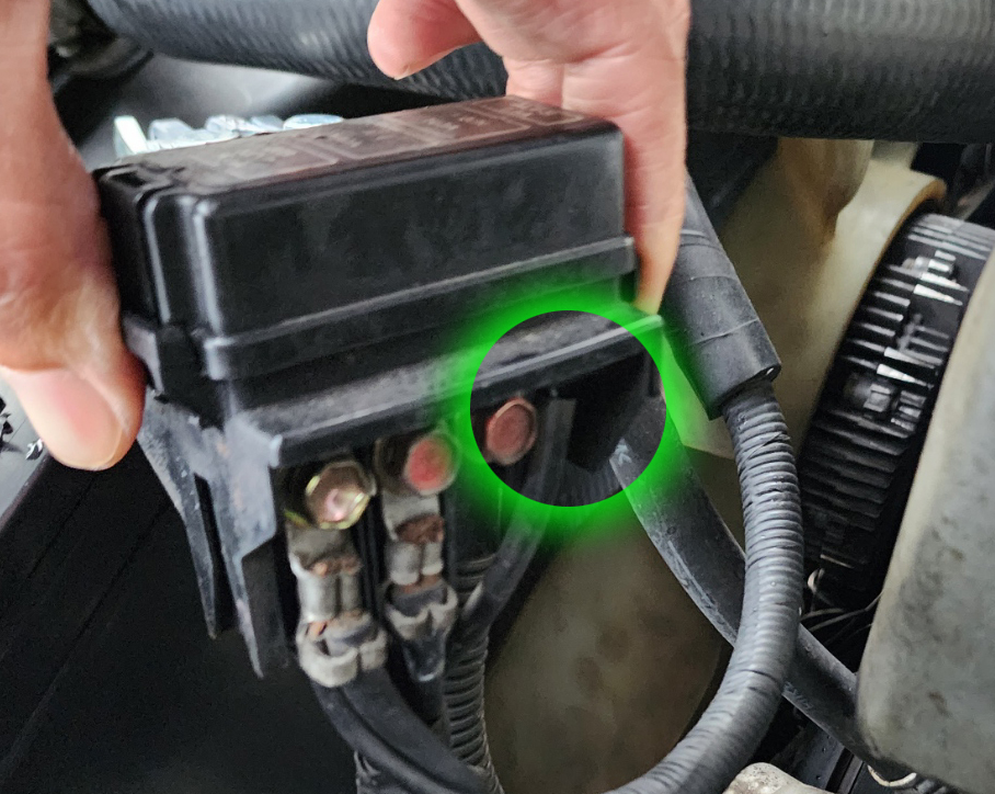

Gone from 'mildly inconvenient' to 'WTF' on the electrical issues. Battery is fully charged and truck will light up the cluster but won't start, cycle locks, etc. Did some more reading and looking into the fusible links and fuse box. Most of the reference pictures I've found are of the 82620-60030 box (2004+) rather than the older 82620-60010 (98-03) one.
Not really sure how to crack this thing open and check the links or even how to get this last black wire off to replace it. Any help?

I was considering the starter but there are a few items like the clock reset and now dead/low power situation that is making me look at the links and fuse box.
Did you find an answer to how to remove that last wire where the 7.5 Amp fuse goes? I am stuck here. I am not sure how to remove it without damaging the fuse connector. I don't think you are supposed to just pull the wire. I thought may be there is a way to carefully push from the top.
Does anyone know how to remove the wire with fuse connector?
I actually did not. Sorry. I ended up replacing the fuse box and that solved my issues so there wasn't a need to replace the fusible link.
