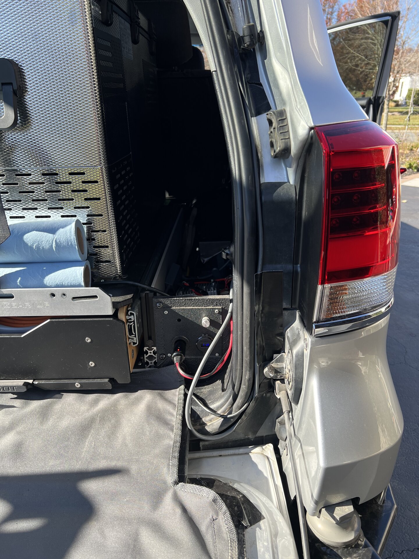

I just ordered the flat high performance. Anyone running it off the 110 outlet in the rear of their 200?
I run it off my inverter. The OEM inverter doesn't have enough watts to support it.
I got the other 48 volt inverter to convert it to run off the 12 volt but I have not switched that over yet. There is a little plug and voltage converter, plus a mini wifi router you can swap out to. No spicing of wire needed, just plug and play.

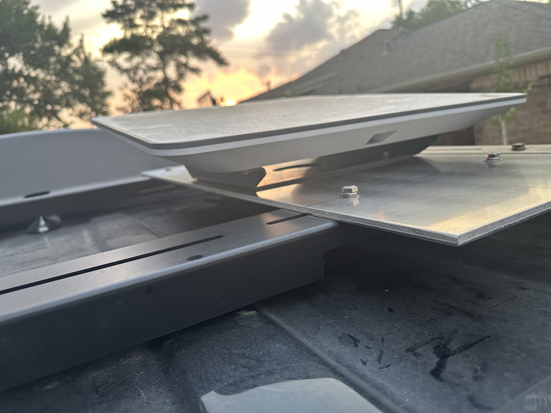

Beef’d up the mount with a 1/4” plate.

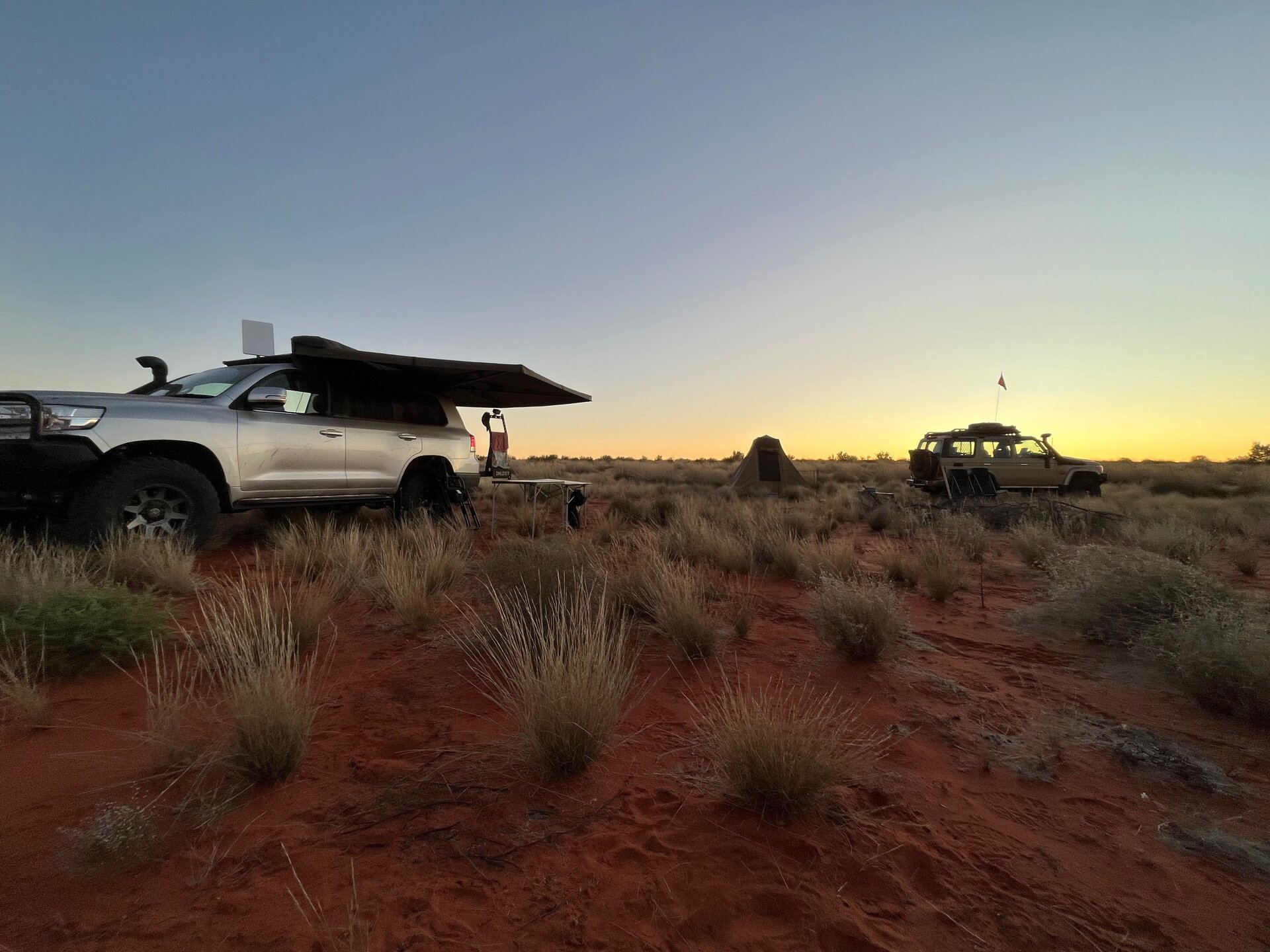

Just got back from remote central Australian desert trip where we used Starlink roam for communications and internet, worked a treat, speeds around 170 mbps I had the router hard mounted on the cargo barrier powered by my Redarc 2000w inverter and the dish into a 3d printed mount on the roof rack.

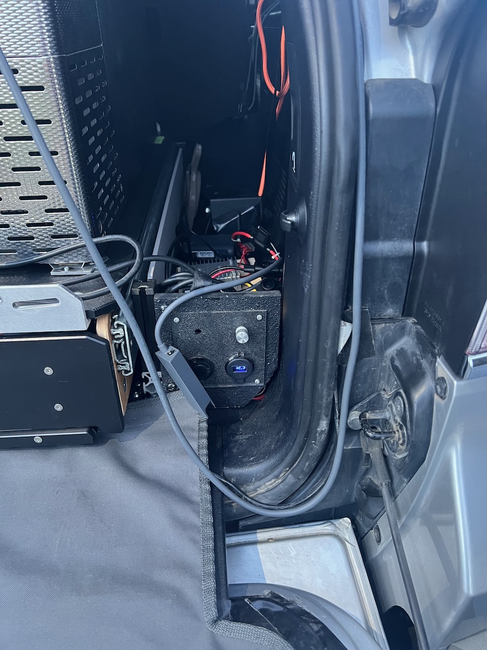

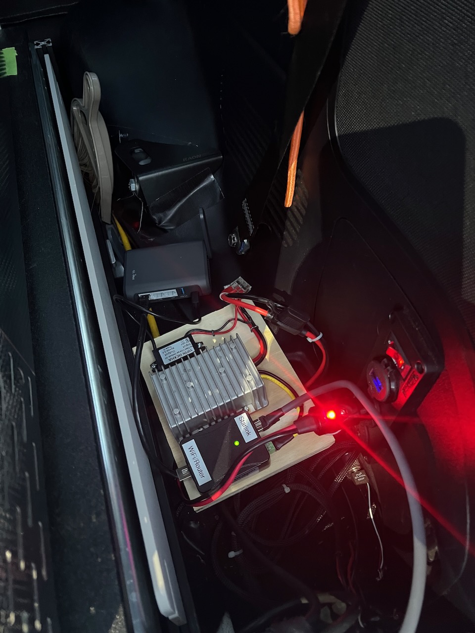

I built a DC power conversion kit last month to gain a little more efficiency when running the Starlink while traveling.
I wanted a quick way to run the Starlink from DC power and AC power depending on situation. This setup does the trick.
Parts required:
12v setup converter to 48v. I choose one that supports 8A 384w which is more than sufficient to run Starlink (heater disabled). I know others have reported success with lower wattage versions.
Amazon product ASIN B0B212GFM9
You will need a PoE injector. The Tycon Systems is a popular low cost option but requires some wiring mods. There are other options out there that don't require modifying & crimping cables.
Tycon Systems POE-INJ-1000-WT High PoE 4 Pair Injector
Amazon product ASIN B07BKV6NYD
Used the Starlink RJ45 adapter which allows you to retain use of the Starlink cable. (Order direct from Starlink)
Added a wireless router which replaces the AC powered Starlink router. It's powered via USB C connection. Lots of options but I choose this one.
https://www.amazon.com/gp/product/B0B4ZSR2PX/?tag=ihco-20
This adapter powers the wireless router.
Quick Charge QC3.0 USB C Converter DC 12V/24V to 5V 3A USB Type-C Buck Charging Module Step Down Voltage Regulator Car Power Converter Adapter
https://www.amazon.com/gp/product/B0BRCRSRS3/?tag=ihco-20
Added small Anderson connectors for cigarette lighter plug connection (goes into rear panel) or can switch out and plug directly into Goal Zero Yeti.
Went on a 3 night camping trip a few weeks ago. The kit worked fine without any issues. Power converter never got hot. The DC power source connection is wired to a Switch Pro so can easily turn on/off as needed.

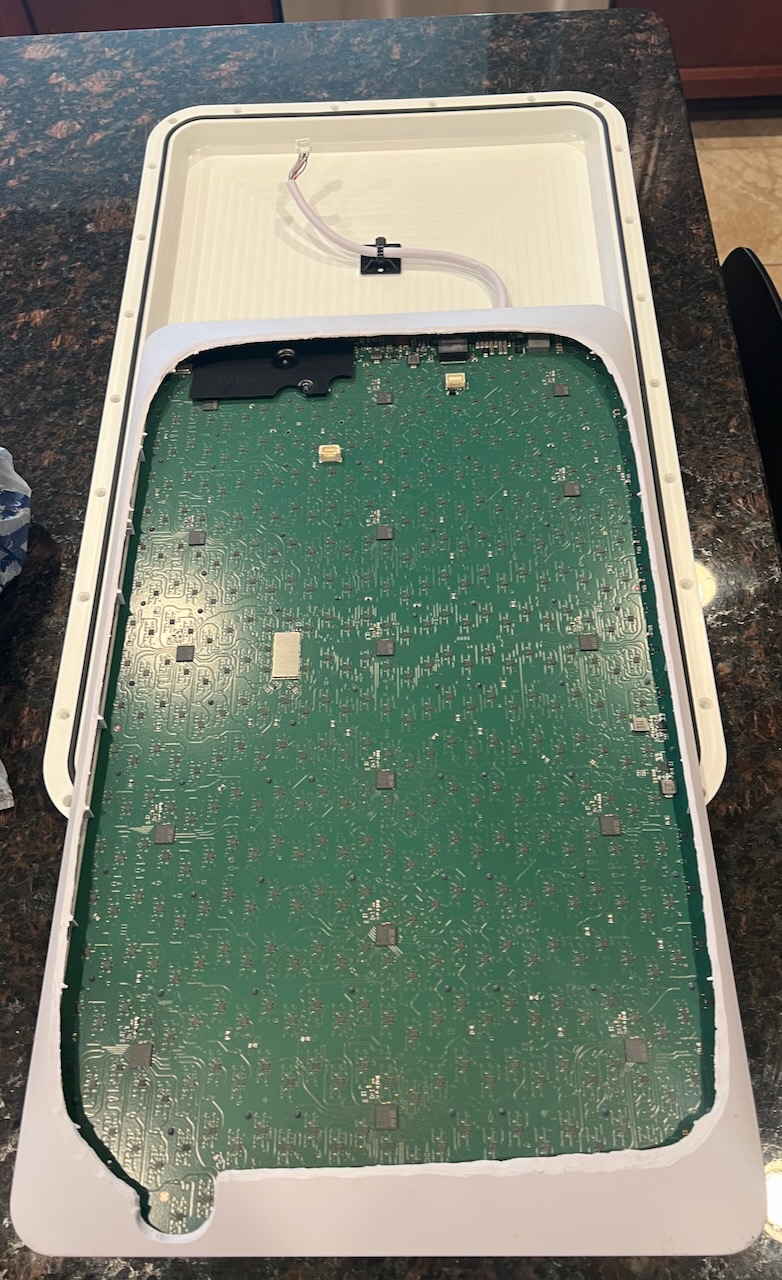

After waiting several weeks, I finally received my Star Mount systems low profile dish mount. Went with the version with RJ45 connectors (you have to cut and crimp on the connectors). It comes with a modified port for the cable and waterproof RJ45 coupler.
Had to cut the backside off the dish. You can pay Star Mount $200 to do the same plus shipping and lead time. It wasn't too bad, used a Dremel with plastic cutting bit. Had to cut the Starlink cable (one inside the dish) and add RJ45 connection. Same for the long cable.

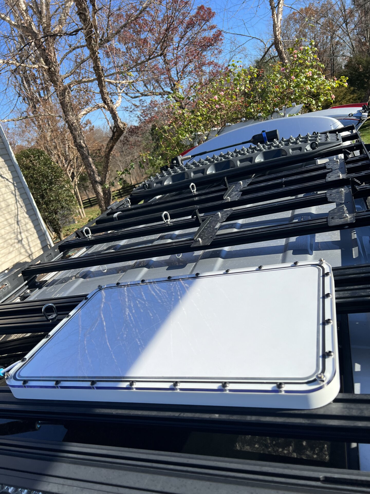

My plan is to mount the dish on my Prinsu roof rack and run the cable down the backside in to the interior. I don't plan to keep it up there full time, just when on trips. Tested it out today in the driveway and it worked, had 65 mbps down but I'm also getting throttled in my area.

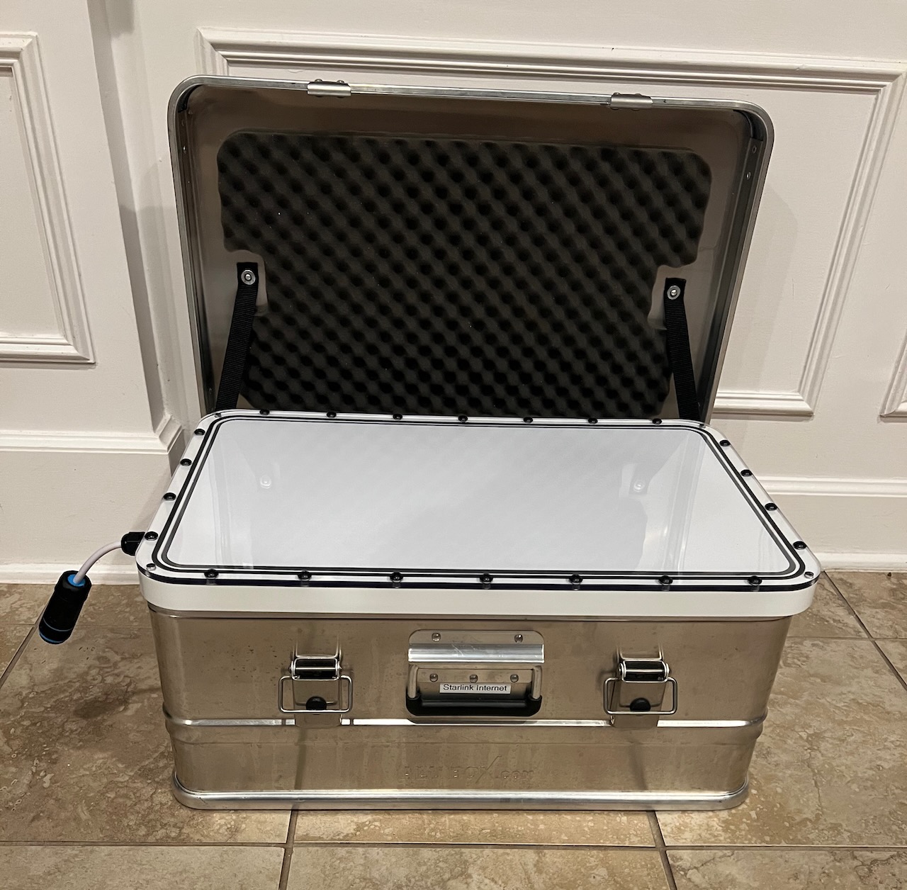

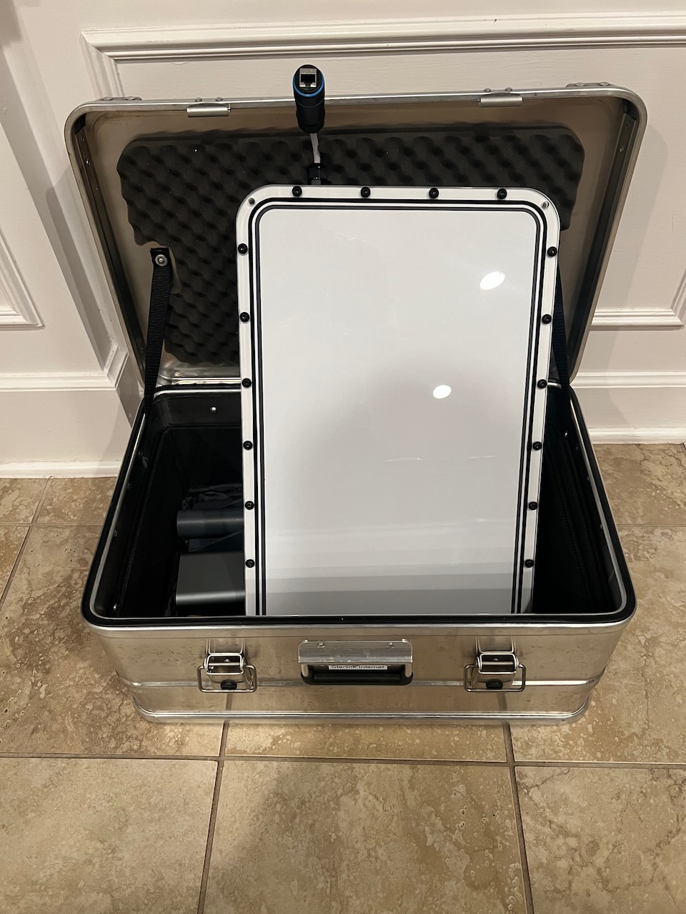

Will have to find another use for the Alubox Starlink kit from Equipt ;)
Gonna do some more crimping tonight. Will cut the 75' cable to allow for shorter connection from interior to roof and the ability to extend the length in the event the dish needs to be placed in a clear opening away from the truck if camping under trees.
Temporarily mounted the Starlink to roof rack today. Ordered some security nuts and will add some rubber washers. Tested my crimp connections and all good.
I have a short cable that runs from back interior to roof. If needed, I can add the longer cable portion using the RJ45 coupler (it works too). The fleximount attachment from Star Mount is backordered - it allows mounting dish to original stand if needed
I may alter the cable routing to the interior. Could go thru a rear grommet behind the rear side bumper piece on either side
