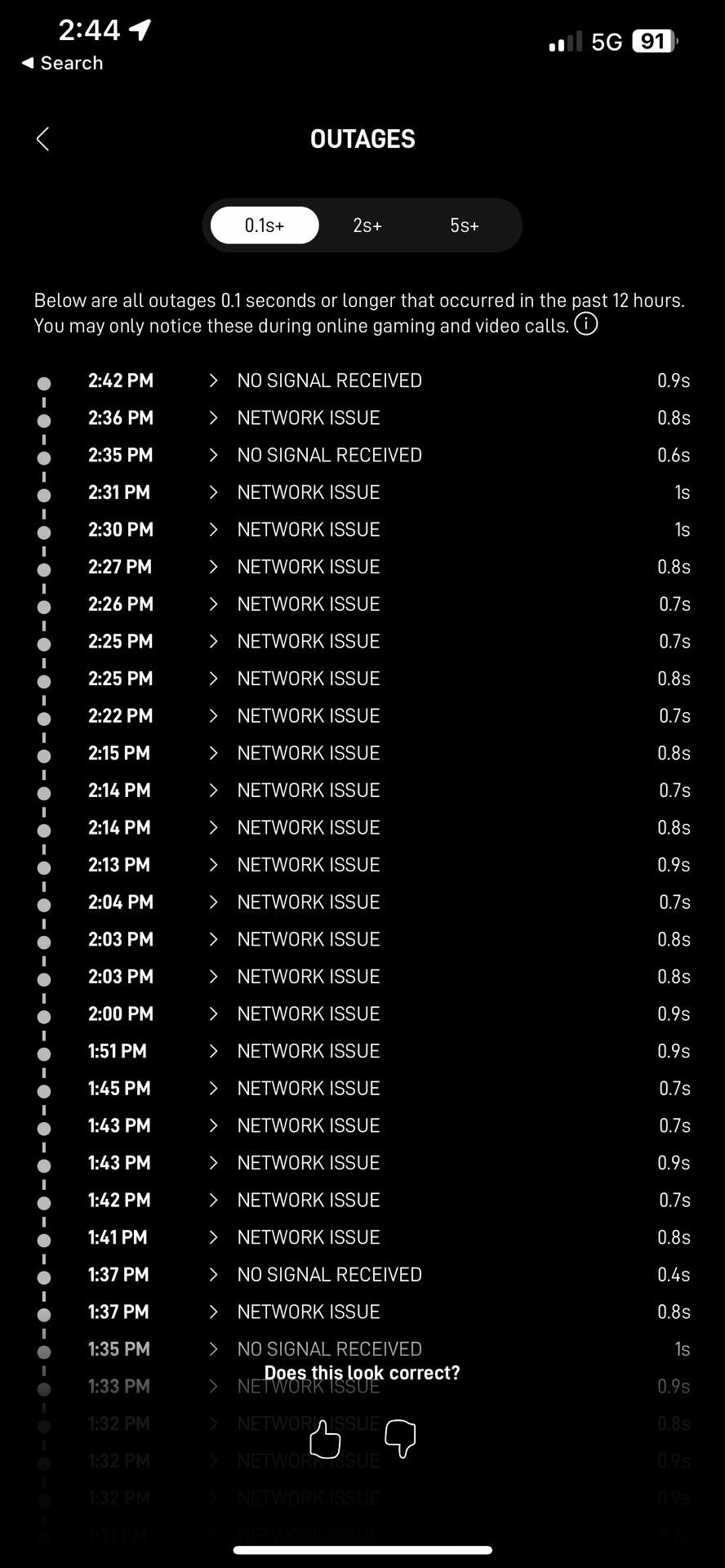

FWIW here is a screenshot of my latest outages of 0.1+ seconds. I’m in the southeast so it’s not exactly representative of what you will encounter on your trip, you should have better access than me. My dish is completely unobstructed. Maybe someone closer to your destination can chime in or share their outage info.
Thanks!
And yikes! Is that as bad as it looks?
And is it always that bad or did you send a screenshot of the worst period?
I’ll get the app and try here.
And to ask a stupid question: are those times in seconds? (Though I can’t imagine what else they would be).
Seems like a zoom call would be impossible.

Yes, those times are in seconds. For gaming and video calls it can be tough, streaming and surfing it’s fine. That image is for the last 12 hours for any outage over 0.1 second. Below is 2 or more seconds and a graph for your enjoyment. It needs to be noted that I’m still in an area where there isn’t full satellite deployment and there’s a waitlist for regular residential. I got my dish when there was a sneaky workaround with portability and some location hijinks. While out west it was a lot more stable so just keep that in mind… I’m just sharing data in the hopes of having something to compare against should others want to post their experience.
I’m in an area where my regular home ATT service is prone to bed pooping so we have the Starlink as a backup and for our travels.

The times are in seconds, but there is BUFFERING involved.
SO on most (if any) of those you will not notice the blip.
