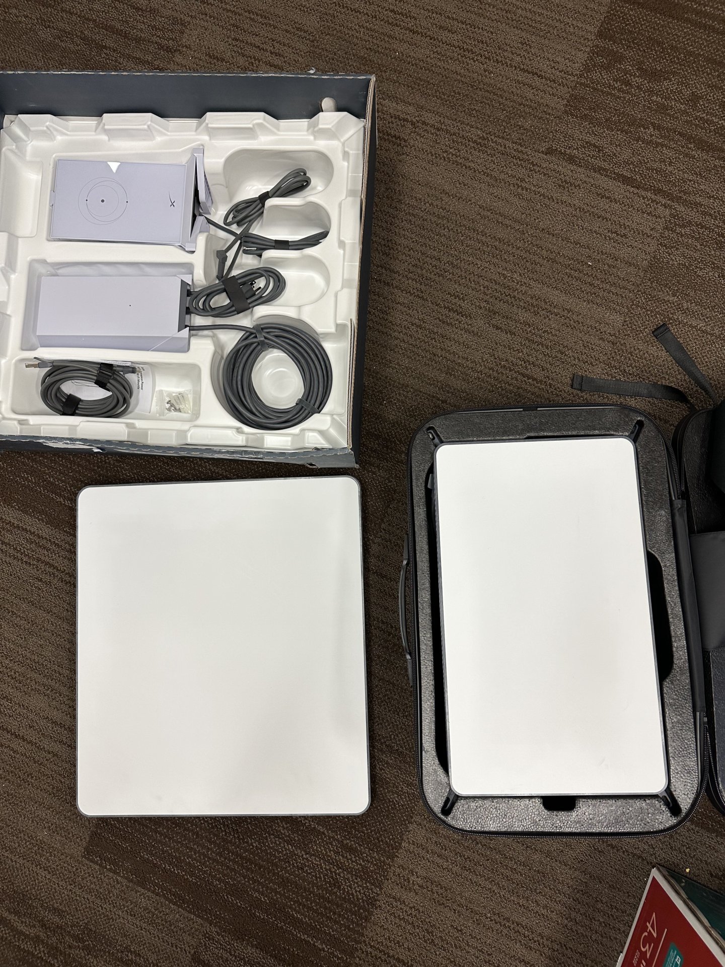

Starlink RV roaming version, initial test

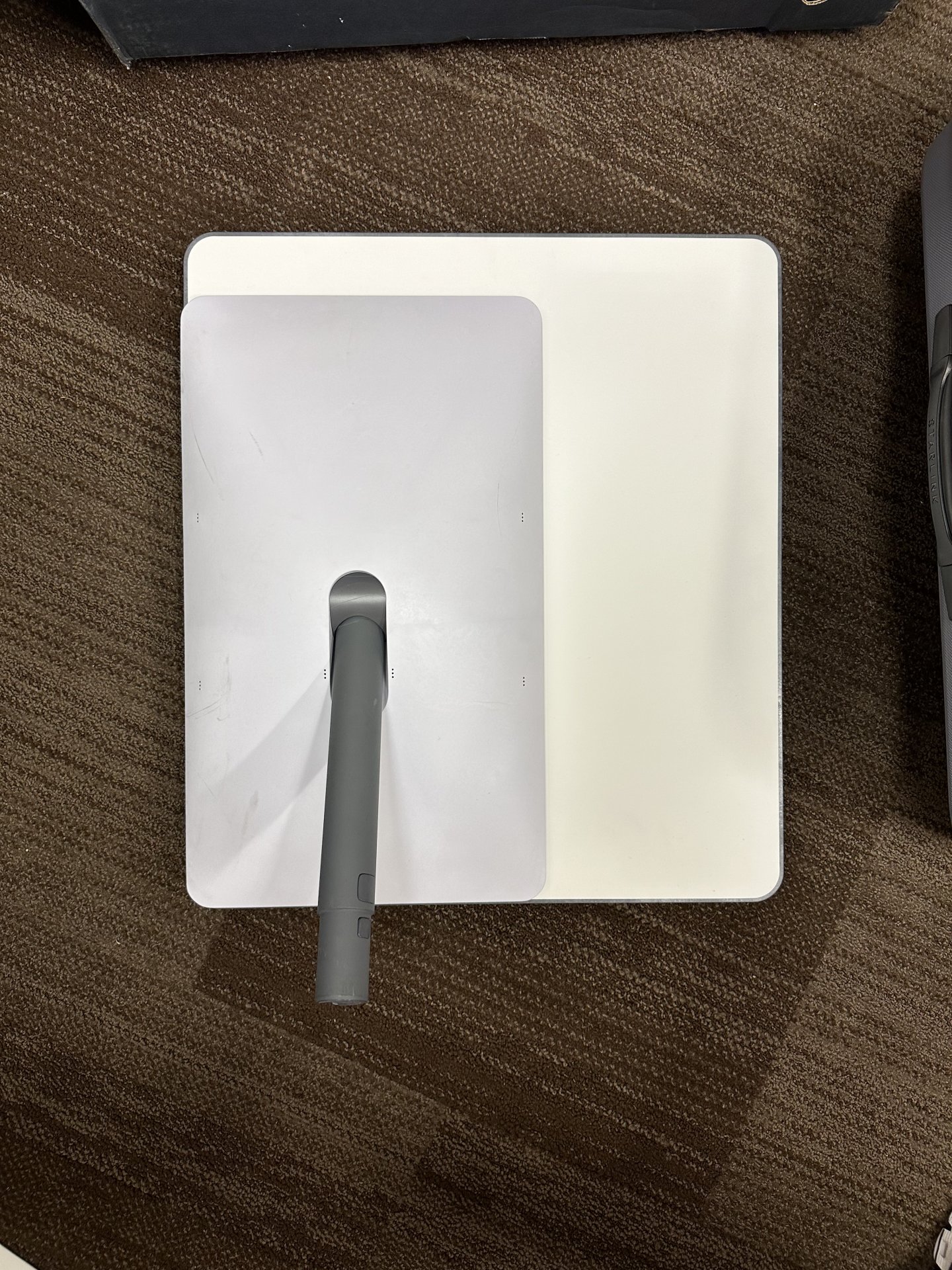

In-motion dish is massive!

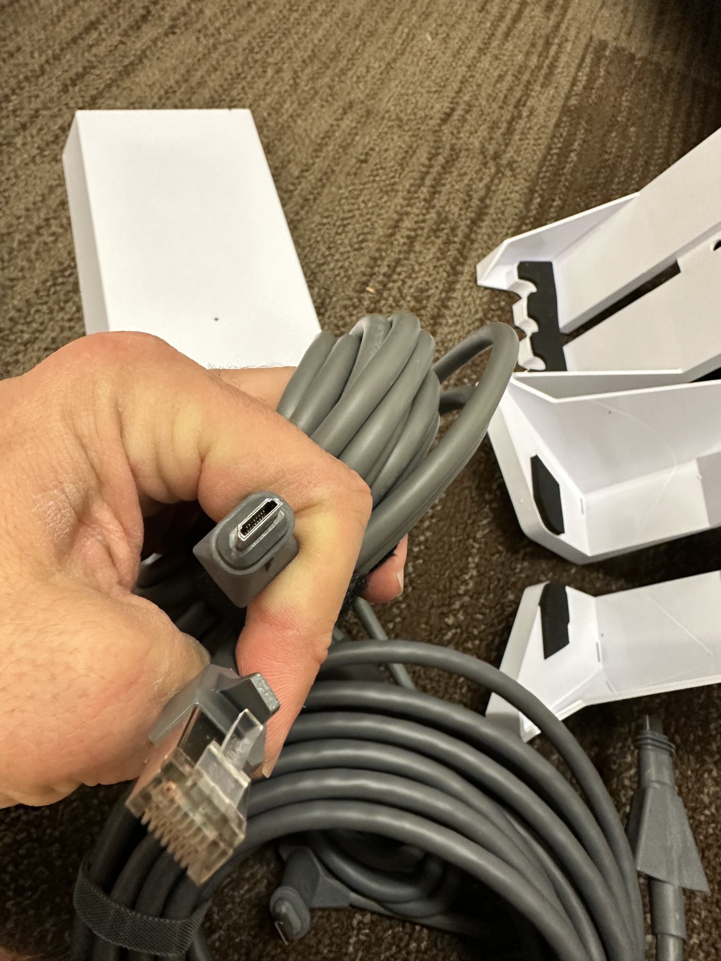

It also comes with a dedicated power supply, mounts for the supply and router, and a separate usb to Ethernet cable so you can bypass the router without hacking the cable.
Interesting. I had assumed it would be similar or same size seeing as how there have been many current models hacked apart and mounted flush.
Curious to get your side by side performance comparison.
Power consumption is quite a bit higher too from what I’ve heard from space X pals. Interested to hear specifics.

I am not seeing mounting hardware for the new rooming dish. Was a mount included or is that some separate order?
If it was a separate order do have the part description or part number?

No .. but it would be nice if they included the wedge mount they were suppose to include.
Has 4 bolt holes on the bottom for mounting.
yea really especially given the price of it. FWIW - I contacted their customer service for an order (mount) that went missing. They shipped me out another via FedEx without question. Original order showed up a few days later.
In-motion comes with a mount; however, it shipped separately and a week later than the dish.

Not at all. Same exact router as the tv/residential, but there’s an additional sized box that acts as a POE injector for the dish.

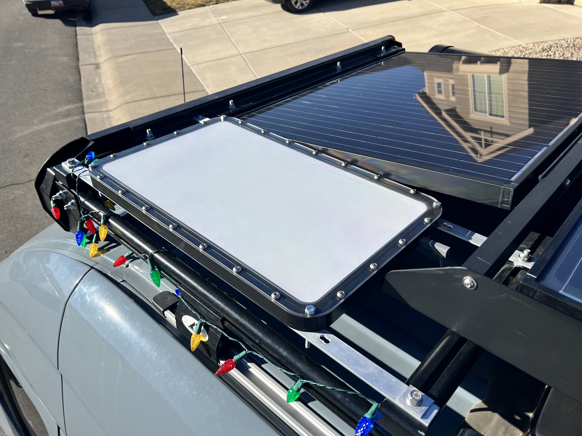

Hacked up my rv unit a couple weeks ago so I could flat mount it on my sprinter. Works just as well while in motion without having to pay for the in motion version.
Nice !!
How did you cut it down? I did watch the YouTube where the guy used a milling machine to cut it down for it boat.
right, but apparently SL has been flipping the switch on/off for regular dishes working while moving. some of the other groups it's "testing" and that they will likely disable it soon.
Nice !!
Pretty scientific method… taking a sharpie and placing it on a roll of electrical tape and then sliding the tape around the outside of the back of the dish while on a table. Leaves a nice outline. Then taking a dremel with a collar that limits the cutting depth and done.
The day this happens, IF it happens I’ll post in this thread and buy the overpriced in motion version.
