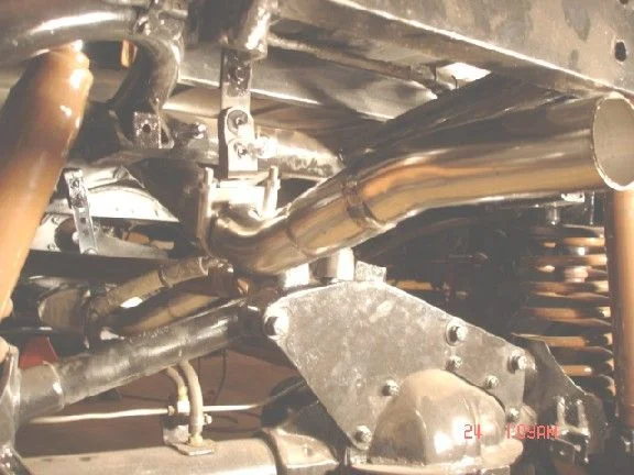

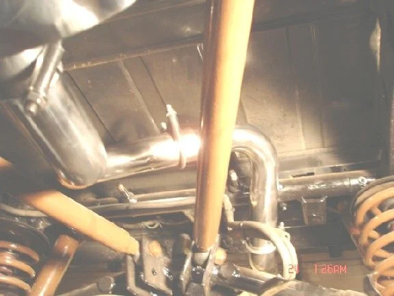

I bought misc pieces prebent & straight stainless tubes from JC Whitney, got a tank of argon gas & a spool of stainless wire & butt welded a few connections. Some of the pieces were enlarged on the ends so I can slip fit & disassemble when needed. Also bought a Borla stainless muffler & stainless hangers. I'll do the same exact setup when I get to the :pig: s exhaust:

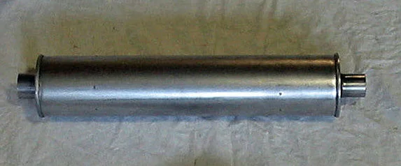

well i am in the process of ordering up the stainless steel oem copy muffler...it will be:
overall length of 28"
the case will be 24"
inlet length and outlet length will be 2"
will be 5" round ...this is just over the stock size.
the inlet ID will be 2 1/8"....i have a 2" od down pipe
the outlet will be ???? waiting for the tailpipe from SOR...and so the muffler will be built upon my measuring of the tailpipe.
Sor says the tailpipe is 1 3/4" ID seem kinda small...sooo...i have held up the construction of the muffler till i get the pipe in hand.
the only other change is that it is offset inlet and the outlet is centered...we'll see how that changes things whe i line it up...i also have the oem brackets coming in also.
it will look like this ...in 16 GA type 409 Stainless Steel
any thoughts???

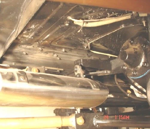

It's holding up very well for the abuse it's given... It's not washed or cleaned very well under there ... It's driven as a DD outside 24/7 as well and I live in the upper north east... Salt... Usually I go 2-3 years on a muffler
It has some minor pitting probably due to dissimilar metals of the bracket and tailpipe/front pipe... But honestly it's not bad
A quick sanding down and paint it would look great :)
