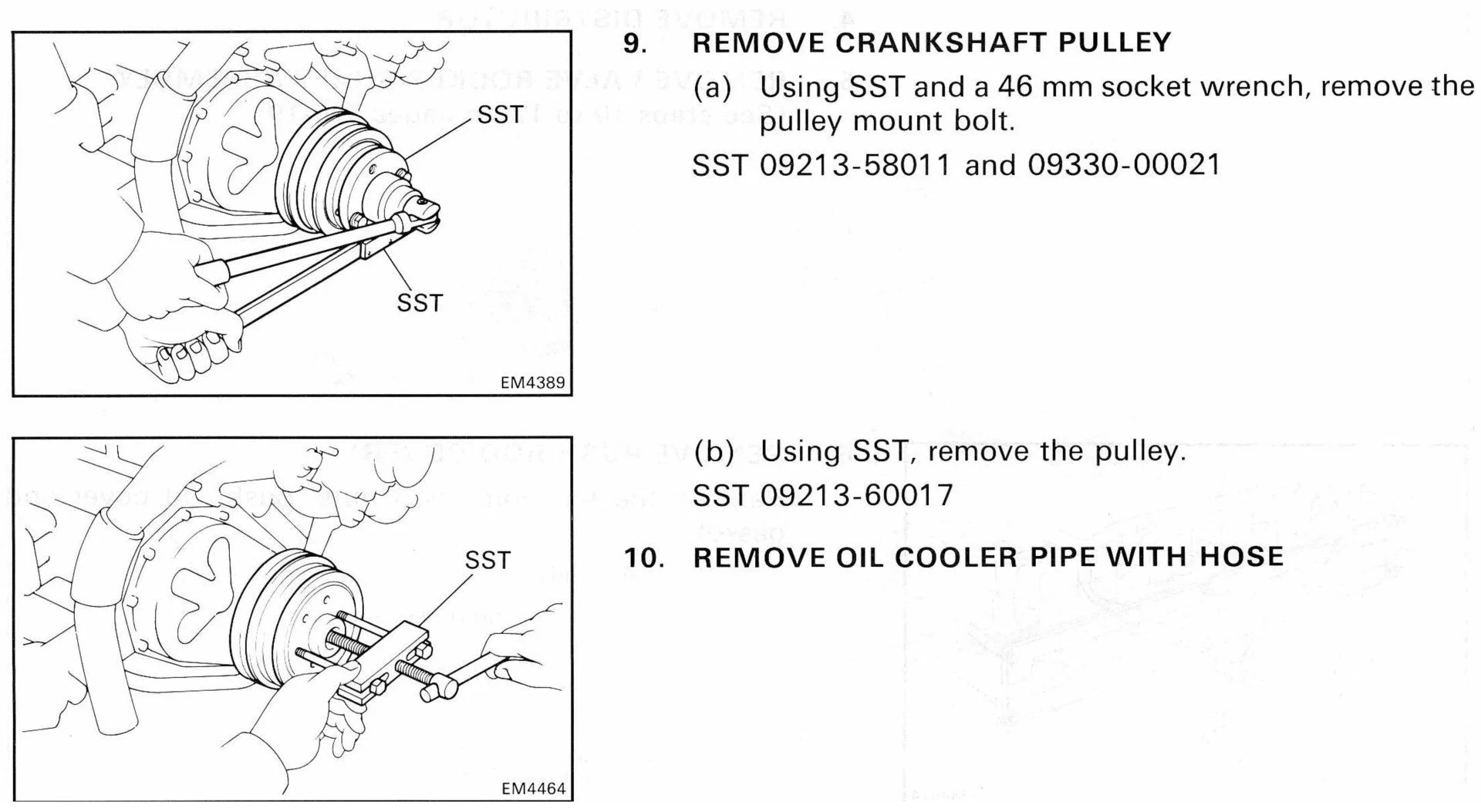

What are people using to get the crankshaft pulley off? I want to swap the timing gear cover gasket. FSM shows a SST which I can probably jury rig in the garage.

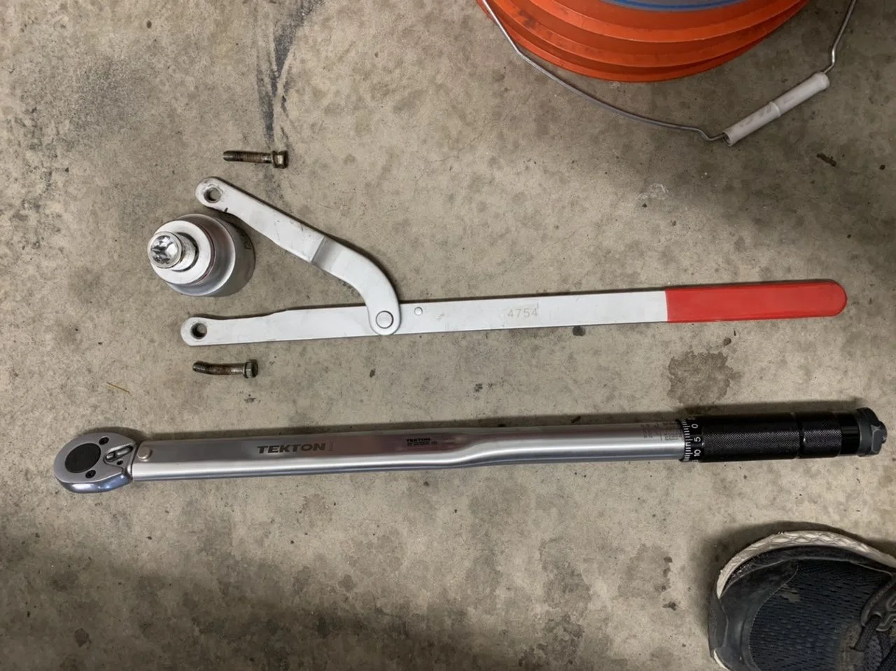

I wanted to revive this very helpful thread as I just finished doing the front crank and timing cover seals. I was leery of the starter bump method— I’m a noob and my breaker bar was too long to fit well against the frame. I also knew I’d have to tighten it eventually and suggested methods required two people if you didn’t have a tool.
So I set out to try and recreate the SST mentioned in the FSM for a reasonable price.
If I had fab tools and a welder it would have been easy but I’m working out of my condo parking lot with no garage. Bless my neighbors’ souls for not complaining.

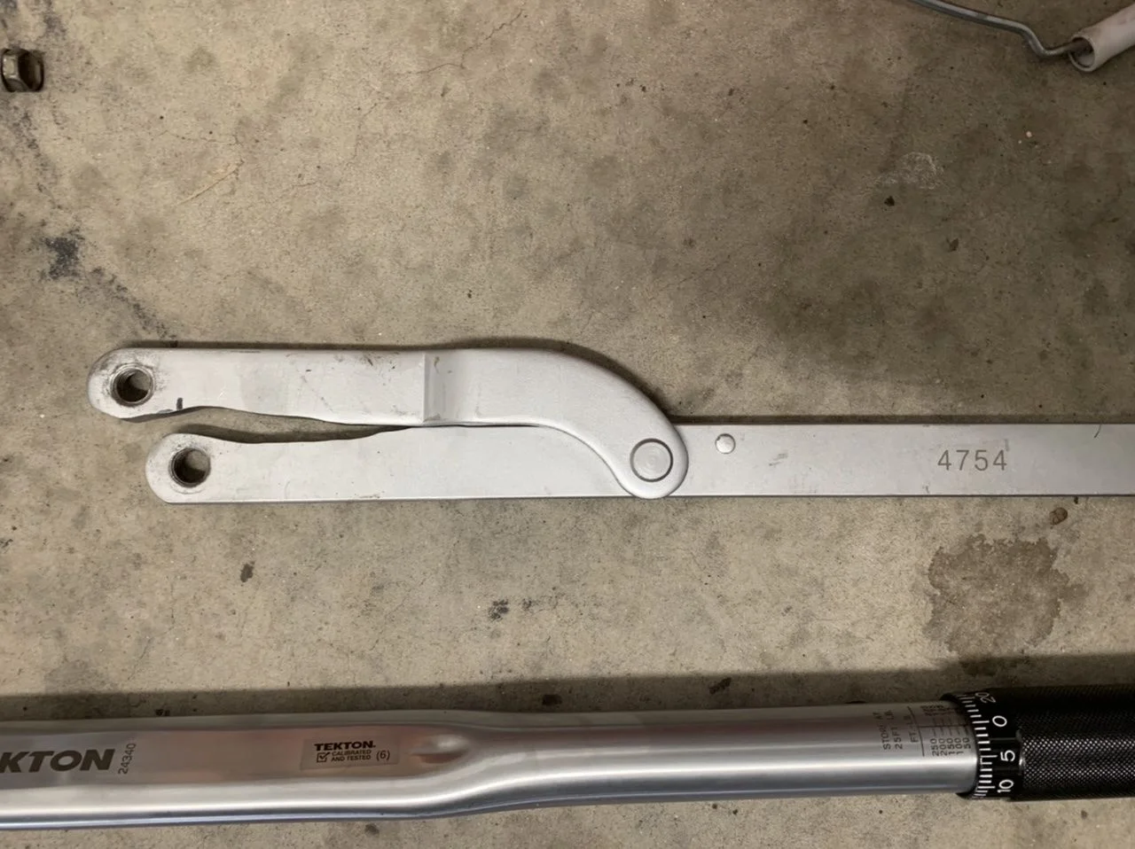

I ordered an OTC 4754 universal pulley holder that worked like a charm. I found reviews and pictures that confirmed it was very beefy.
I didn’t use the included pins as people had mentioned those bending on tough jobs but m8 bolts fit through the holes no problem. The ones I bought were 30mm long— too long but still worked. I did have to massage the arms with a grinder to clear the hub.

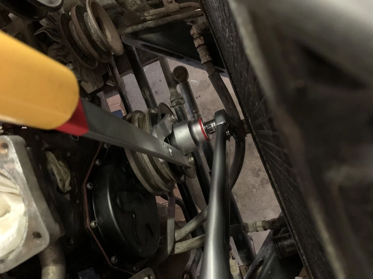

It was nerve racking when the HB bolt started to crack because I couldn’t tell if it was the tool or bolts bending or not. Bolt cracked like a charm though!

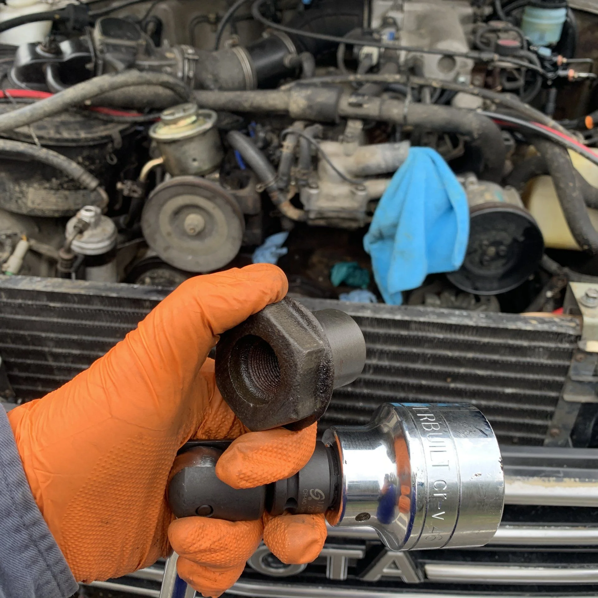

I used a crows foot style harmonic balancer puller I borrowed from Advance Auto plus 3 40mm m8-1.25 bolts I picked up.
I bought the OTC tool and ground it down as you suggested. Used the starter bump to loosen the nut and the modified tool to put it back on. This works great if you don’t have the capability to weld and fab your own tool. Thanks for sharing!
Since I did the thermostat at the same time, I used the old thermostat housing bolts to secure the tool to the harmonic balancer. I did bend the bolts a bit when torque-ing the nut. It’s good to replace those thermostat housing bolts anyway.
For pulley nut removal, I had not yet bought the tool above and was trying the starter bump method. I was a bit nervous about this method but it seemed a lot of folks were successful and I didn’t end up breaking anything either.
Make sure your battery is charged, mine was a bit weak as I had not driven the truck for a couple weeks after starting this project and slowly working on it. I used a 2x4 between the 3/4” socket wrench head and the radiator to make sure the wrench wouldn’t fall off the nut. I tried securing the wrench handle to the frame at first but was unable to break the nut loose. So I gave the wrench a little space to move and then hit the frame as some suggested and this broke it free after 2 bumps.

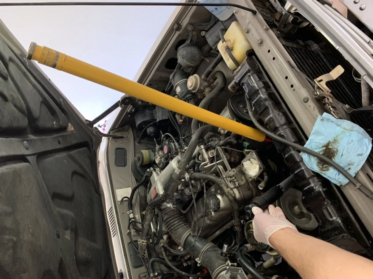

Ha... It’s a Tekton brand 1/2” torque wrench I got from Amazon for $60. Goes up to 250 ft lb. Then the yellow pipe cheater bar on the end of the pulley holder tool is from my jack.
Taking apart the front end was not fun, but after doing it once at least it should be a bit easier. I split the fan shroud while I was at it which made it much easier to get the fan back on.
