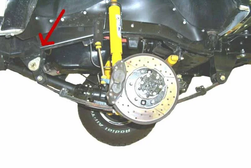

This is the pic from the MAF site for the 60 SR kit.
Is the shackle angle in this pic OK.
I thought it looked to far forward. Would this allow any down flex?
I planning on ordering the kit and have heard that movin the hanger fwd may be needed. (FrontRange4x4s Thread).
Thanks
I think that pic is unweighted. So that's what it would look like drooped. I have this kit on my 60 that I got off of a parts cruiser. I'm a fan. So far no problems. The question I have is that it requires shims and I don't know the degree. They must have stuck to the axle that was taken from the parts rig before I got the SR. I have 2 degree shims in there now. Not sure if they're correct though. I say go for it. :cheers:

DONT do it!
if you do end up doin it, do it the right way and use a normal spring hanger that doesnt sit as low or lover than the stock shackle does like the MAF kit does.
If you are dead set on doin it then use a normal mount for up front so it will increase front approach like THESE HERE <----- this is a link

that said i still dont recommend that kit, if you are wanting more lift and that is your sole purpose (as was stated) there are better ways to do so like with longer shackles and and such. not to mention their kit makes the front sit higher than the rear. I just really dont like their kit, i love that is is bolt on but i think it should be much lower profile.
the only real reason i can see for a SR would be for better approach (personally) not so much for lift.
my 42 has a SR on it installed by one of the P.O's and it looks to be the same as the MAF kit bolt on, hangs really low ect. now i dont really wheel the 40 all that hard and im still not a real fan of it and will be going with a low profile spring mount when i have some time to fool with it.

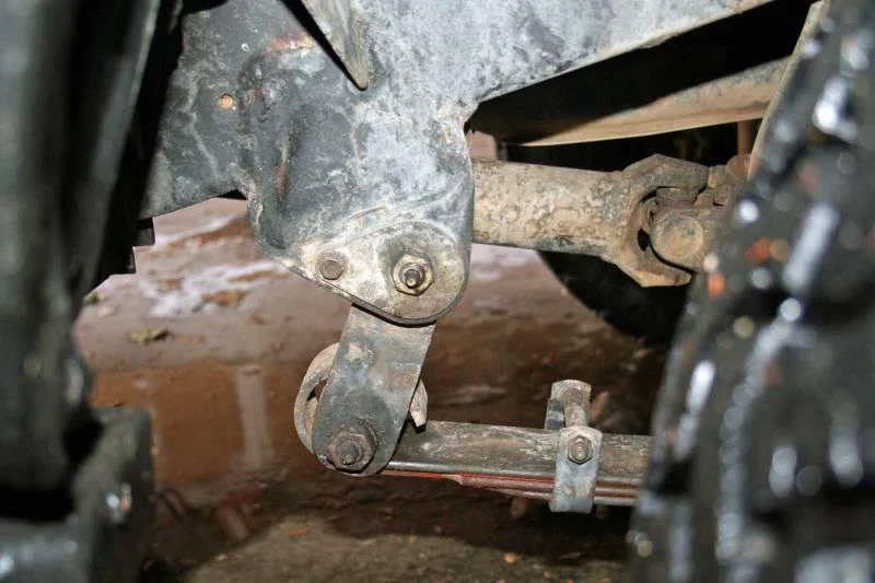

Here is what my buddies 62 looks like on the front shackle PS.
He got the entire MAF OME/SR kit which I believe has the Dakar Light springs.
This doesnt look too bad to my novice eye.

Here's mine now after moving forward. Looks about the same as your buddies but I run the heavy's like you do. I also use the 6.375 in the rears to level it. I believe I have a spare set if you're interested David.
