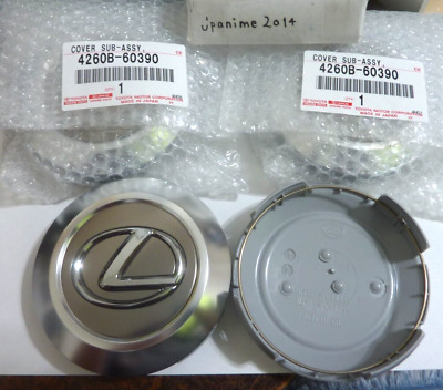

I’m looking for center caps for my summer wheels (enkei’s), curious if anyone knows the OD of these caps? Seller won’t respond to inquiries.
