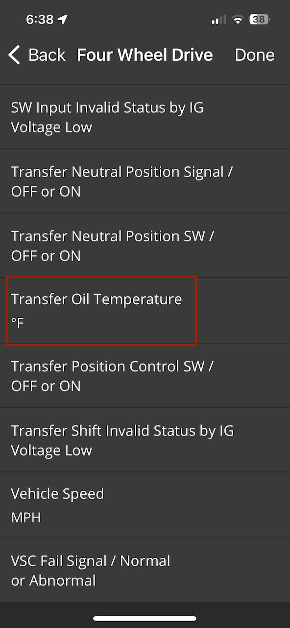

Yeah it's the same part but I've no idea (a) if the sensor data is sent via CANbus on earlier trucks, if (b) the ECU supports that pid, and (c) if I can mix-and-match 2013 and ~2018 PIDs in one dashboard in OBD Fusion even if it is supported (and just not part of the 2013 pack).
I agree, just saying if the sensor is in the case, it is present in a 2013.
It would seem odd to me that they include the sensor with no ability to pull the data from it.. I'll get techstream going today and see whether that live data displays the case temp.
Techstream didn't show anything useful. I actually couldn't even find the readout for the 4lo or CDL status switches, which I expected to see.
Don't have much time to do a deeper dive and see whether it's in some module other than ECM/TCM, but none of the others in the listing made sense. I did look at the BCM but no dice.

Isn’t there a 4wd Control ECU? Maybe there is no techstream module for it, or it’s called something weird.
There is definitely a 4wd control ECU, and it's on the canbus so able to communicate directly with the rest of the vehicle modules.
The wiring diagram also clearly shows a temperature sensor within the 4lo actuator. To me this suggests it's not a very good measure of transfer case mechanical conditions anyway.
Ah that would make sense, I believe the voltage to the actuator is increased when the temp is below ~50F

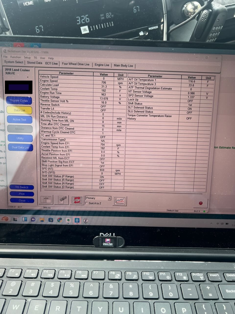

2018 here. I didn't see any specific temp reading for TC in Techstream.
It does have 4wd Control ECU but no data.
(Did a Transmission Flush last weekend and forgot to reset ATF thermal degradation estimate, so did it while in there)
I do have OBD Fusion for 2018 with packs. Can look at that later.
Here is the TC temp in Techstream and the PID is also in Fusion (purchased the advanced diagnostic add-on)

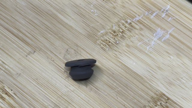

While replacing my driver side rear brakes today, the little rubber plug below fell from somewhere when I pulled the rotor off the studs. Anyone recognize what this is, or know where it might have come from? The head is about 16mm wide.
Adjustment hole on rotor to access parking brake shoes
