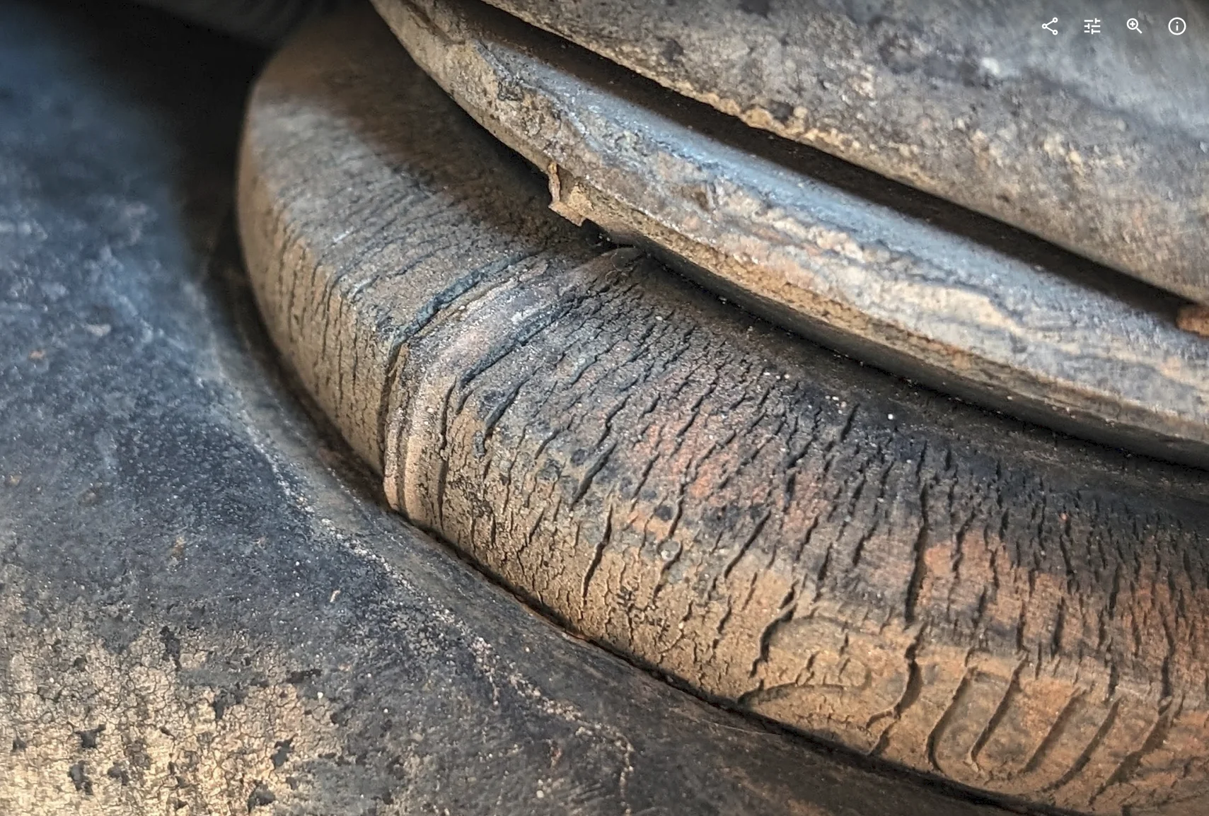

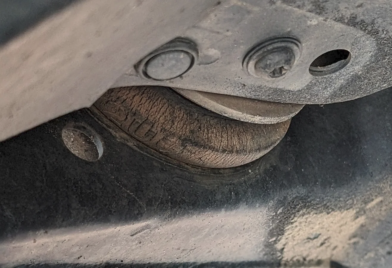

After much search (directly on MUD and via Google pointed at MUD) I have not found much info on replacing body mount bushings. Is it worth the effort? When does it become necessary? (pics related; they are the fronts, rears look better) And is this one of those 'while you're in there, replace all the bits' cases? Replace them all, or only the skunky ones? How many horse powers do you gain by doing this/how many more MPGs does this add? etc. TYIA for insights.

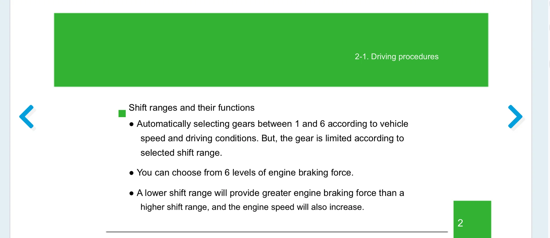

When driving with the transmission in S- does this change shift patterns from normal D?
And if so, what is the difference in S vs ECT Power?
From driving it seems S is the same as D, it just allows the driver to select the gear.

I tried searching and the owners manual was semi helpful.
S # sets the max gear the trans will shift into. So up to whatever number the trans will shift normally. Most people use it for engine braking.
Or towing. If you put it in S mode and don’t change the gears, it’s basically like turning “Overdrive” off. Pretty sure it also locks up the torque converter**
Once you shift into a different gear, you’re in “manual mode,” whatever that means for an automatic car.
**I have an ‘07 Tundra work truck that stutters on acceleration around 38-40mph. Pretty sure it’s an issue with the torque converter, so I just drive in S mode around the city. This eliminates the stutter, so I assume S mode locks up the TC.
I think ECT mode just makes the car shift at higher RPMs for added power. You still get the full range of gears.

ECT setting does tell the trans to hold gears longer.
S mode doesn’t turn off over drive. It sets the max gear the trans will shift into. The trans/engine will eventually protect itself in a major over-rev, but the function is to set the max gear. I don’t believe it forces the TC to lock, but most likely the condition of being at a higher rev range than normal for a given gear probably induces a TC locked condition.
This is the description from the manual.
Your searches didn’t turn up anything because replacing them is not normally necessary. They all look like yours after a while and still function fine. It would be a loss of about 4mpg and 50HP if replaced.
