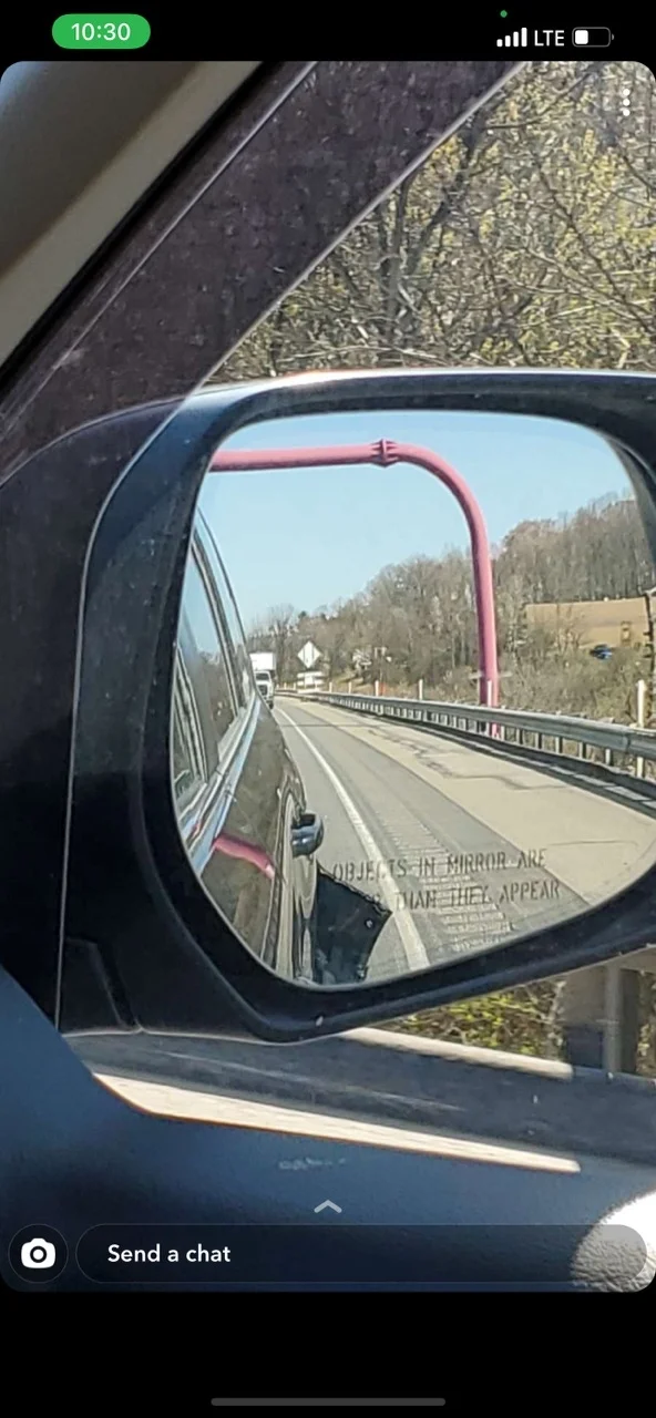

Some of the nubs are gone, some are close. I got lucky in that nothing cracked or got the tail lights, and feel like it gets risky once at speed. The one pic I got off where it was catching wind.
